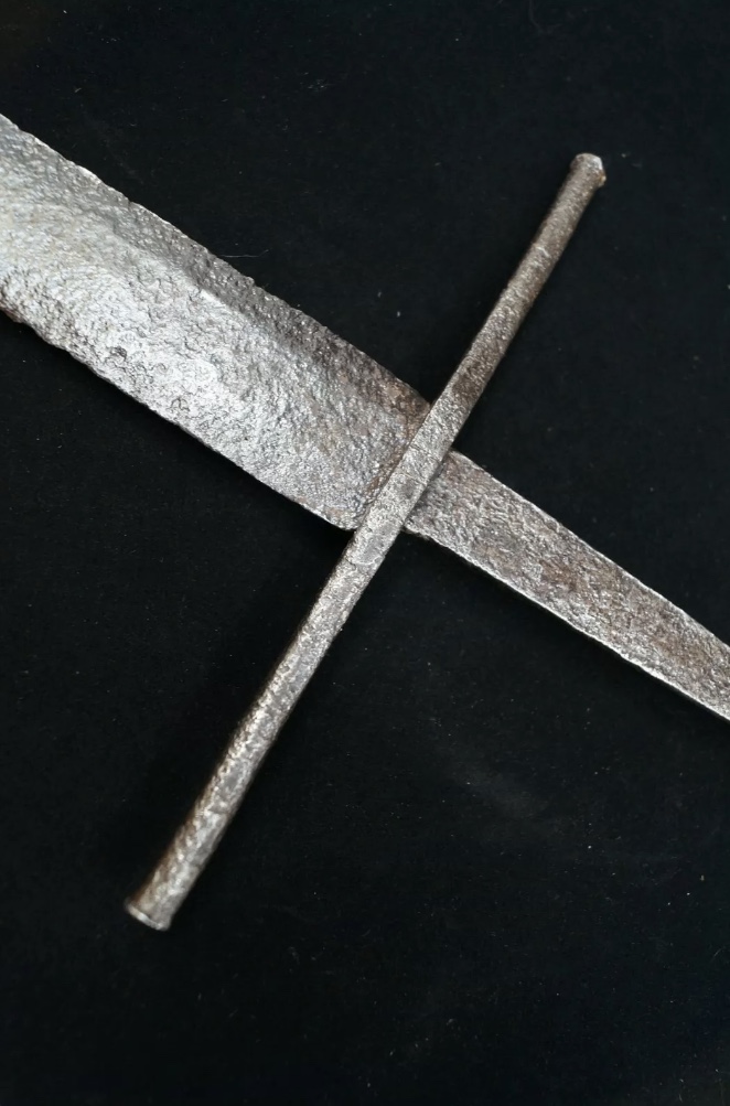

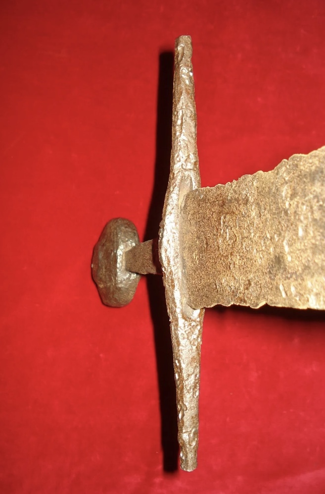

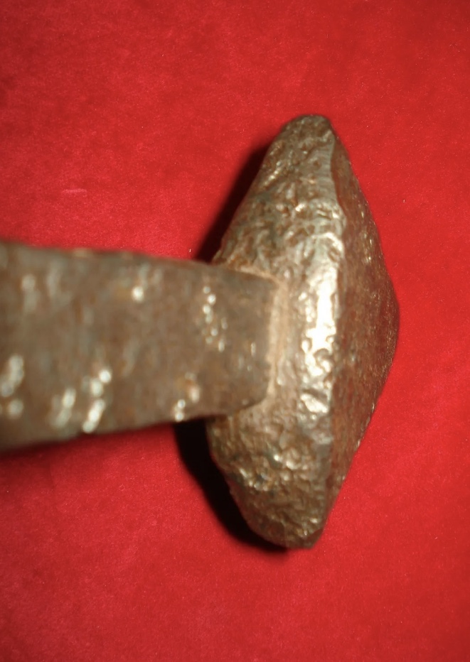

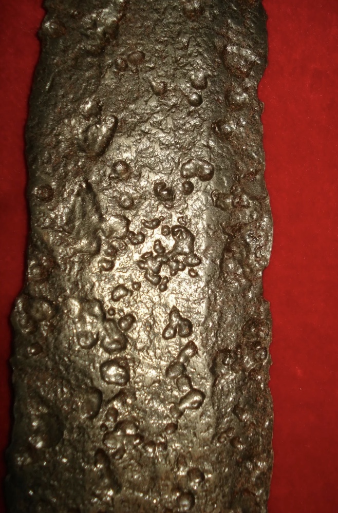

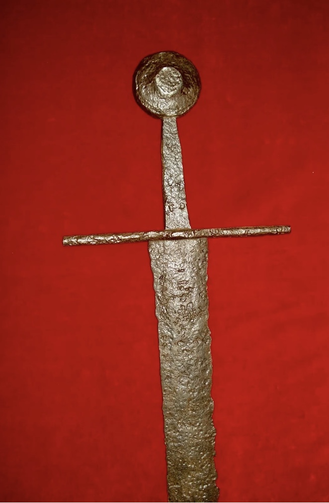

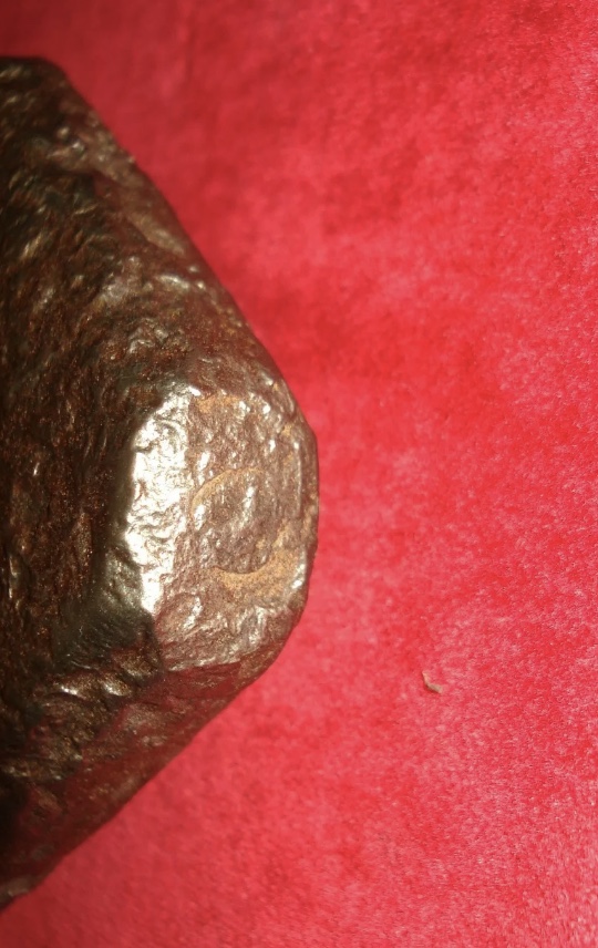

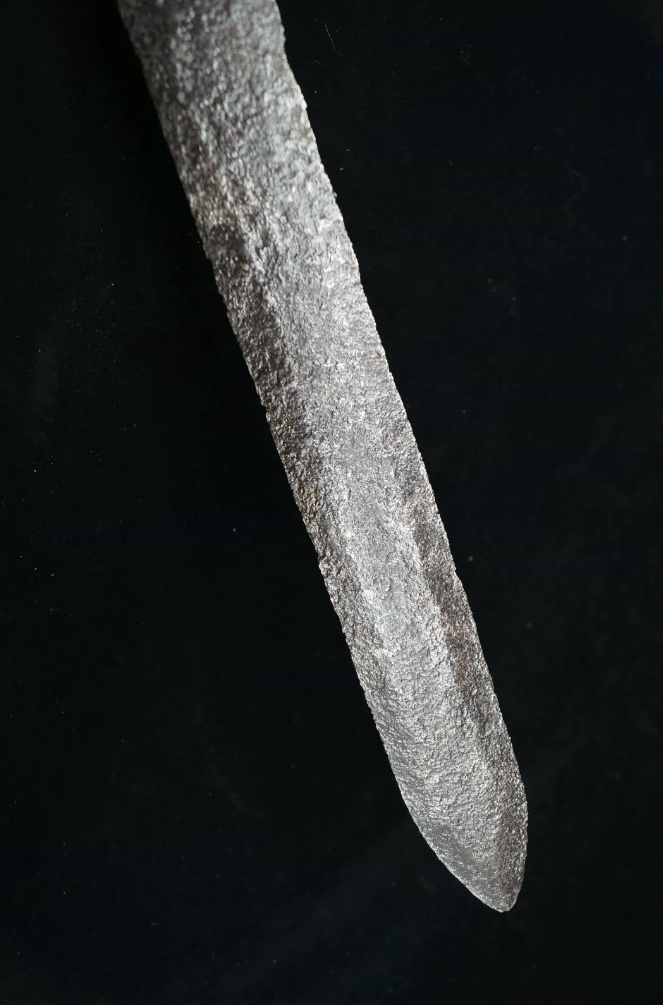

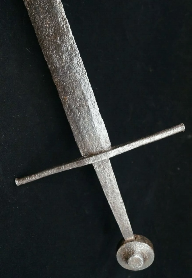

Hi There,
In the past few years I have seen a number of swords come up for sale in various locations that are in excavated condition. Every time I see a sword like this I am skeptical. Sometimes these blades are obvious poorly done fakes, but sometimes, the form, proportions, and assembly style appear to be authentic. Below are some examples from pictures that I have saved. Each of these to me appear like they could conceivably be authentic based on their form and constriction. Things that I find potentially suspect are the patina, and possibly the lack of grain that I would expect from a corroded item made from wrought iron (hilt parts), or steel from derived from bloomery iron. That being said, I have seen many authentic excavated swords with very similar patina, and a similar lack of visible grain. I have even personally polished and etched an ancient arrowhead with a very similar corrosion patter to these blades and found that it had a strong pattern and grain direction consistent with bloomery iron that was not visible prior. This leaves me with the question: How can items like these be authenticated? I would love to hear your thoughts.
 Attachment: 125.32 KB
 Attachment: 151.3 KB
 Attachment: 144.02 KB
 Attachment: 169.07 KB
 Attachment: 154.41 KB
 Attachment: 136.29 KB
 Attachment: 83.46 KB
 Attachment: 164.6 KB
 Attachment: 157.35 KB

Great question, thanks for posting. I have several excavated condition pieces from the 1500s-1600s and have held off on earlier ones due to the staggering number of forgeries in the medieval and Viking arenas.
The one tip I have is what you've already mentioned about grain... relic-level pitting tends to bring out a "woodgrain" effect in hand-forged iron and steel that is so difficult to reproduce no one would bother on a typical forgery.* So if the grain is there, that's strong evidence of originality, but a lack of grain does not necessarily indicate the opposite.
I look forward to responses from the experts here!
*Source: E.B. Erickson and personal observations

Speaking as an amateur enthusiast, I agree there's nothing obvious in the surface corrosion / patination that's clearly off. There might be some subtle flags in the form. In your first post the 2nd sword proportions look odd: the hilt looks typical 14th century but that short hexagonal blade with spade tip looks off, or modified historically. Then the geometry on the Brazil nut pommel seems crude compared to most historical examples. But again, I would consider those warning flags rather than hard evidence because there are also atypical historical swords.
