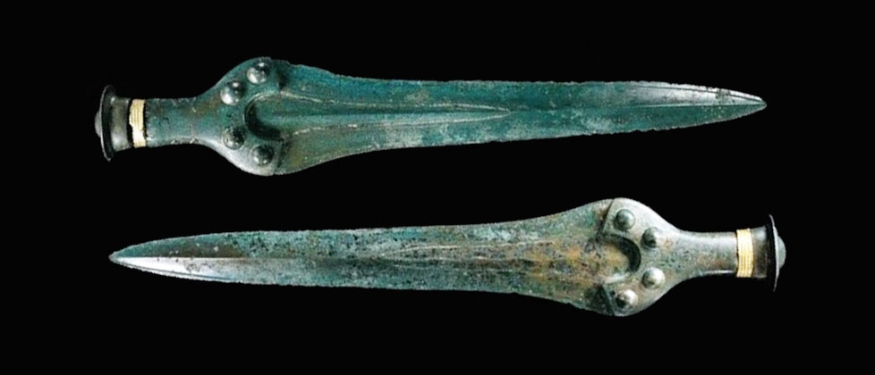

Does anyone have good measurements or weights for the two bronze swords found with the Nebra Sky Disk? They are heart-achingly beautiful, and I want to make one, but I’d rather have nice measurements than measure and extrapolate from photographs.
The disk is apparently around 30 cm across, and both blades look to be a bit longer than that, so I’m guessing maybe 33-35 cm blades and ~45 cm overall??
 Attachment: 48.35 KB
 Attachment: 55.39 KB

Sky disk is actually about 32 cm in diameter.
And here's some info on sword length:
Beide Schwerter sind sich äußerst ähn­ lich. Sie verfügen über eine ca. 36cm lange Klinge und nur eine Griffschale, die mit jeweils vier Nieten an der Klinge befestigt ist.
From this article:
H. Meller, Die Himmelsscheibe von Nebra - ein frühbronzezeitlicher Fund von außergewöhnlicher Bedeutung. Archäologie in Sachsen-Anhalt 2 (Halle [Saale] 2002) 7–20
It's unfortunately in German.

Hey thank you! This is very helpful. I found a drawing showing a side view, and some software that will let me get reasonably close measurements based on photos.
Any more information is encouraged!
