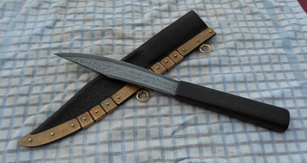

J. Nicolaysen
Posted: Wed 30 Oct, 2019 5:15 pm Post subject: |
Nice scabbard find! Whoever you go with, I hope you keep us posted with the project.
I have some nice things from Petr F and Tod, and in addition to them, I would also suggest George Ezell and Jeff Helmes. I've attached a photo of a pattern weld seax and scabbard with incisions by George.
Lots of great seax makers out there
Attachment: 127.14 KB

Posted: Thu 31 Oct, 2019 11:18 am Post subject: |
Will do. Thank you for suggestions. I will check them out.
That is a beautiful looking blade, the pattern welding is precise and hold the same form throughout the blade. Just fantastic.

J. Nicolaysen
Posted: Fri 01 Nov, 2019 5:56 pm Post subject: |
| Quote: | | That is a beautiful looking blade, the pattern welding is precise and hold the same form throughout the blade. Just fantastic. |
George does a fantastic job with historical blade profiles and tapers. The seax is a bit of a passion for him. He's a member here but I haven't seen him post new work for a bit.

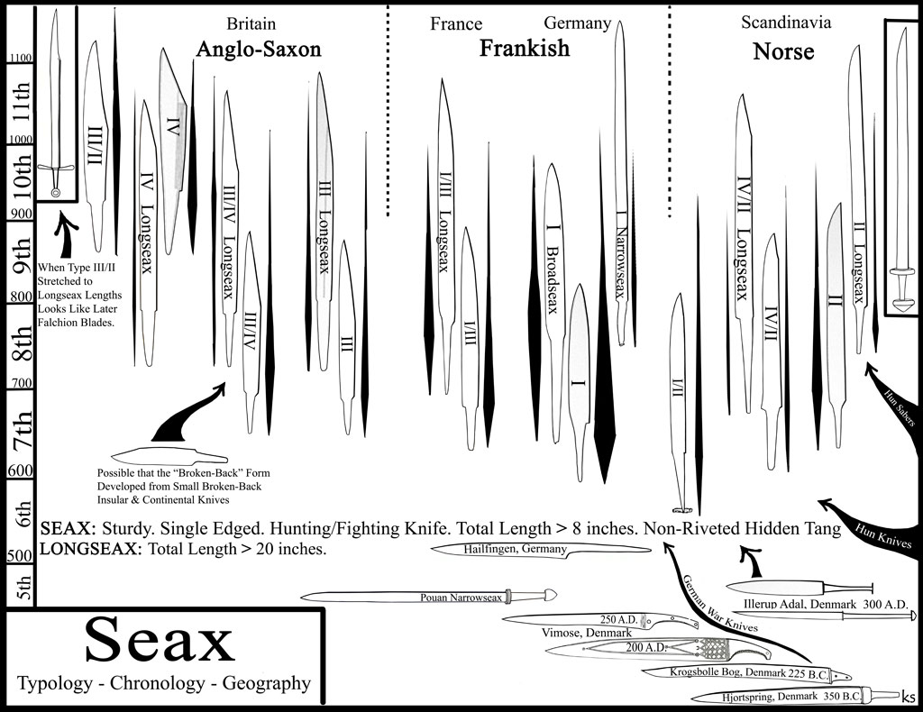

Do you mean this type IV/II of the chart?
I am trying to find a blade that goes with the scabbard in this thread.
The style is scandinavian yes, and very norwegian. Of the finds the norwegian scabbards have no brass, copper fittings alongside the scabbard like the typical swedish scabbards have. Before i thought maybe that metal was valuable and they stripped it off the scabbard before they threw it away. But apparantly that was not the case. The style of making scabbard was different. And i am sure that have there been more finds we would have seen differences from different parts of norway as well.
Attachment: 147.9 KB

Posted: Sat 02 Nov, 2019 5:02 pm Post subject: |
More along the lines of the type IV/III or a narrow type IV, judging by the sheath shape and overall style. This is not typically the type you would expect to find in Norway, but these look like an odd fusion of Norse and Anglo-Saxon styles.

Posted: Sun 03 Nov, 2019 9:45 am Post subject: |
Ok so more a anglo saxon blade type and scandinavian decorated scabbard.
Would this be a correct breakdown of the seaxblade?
Attachment: 96.37 KB
