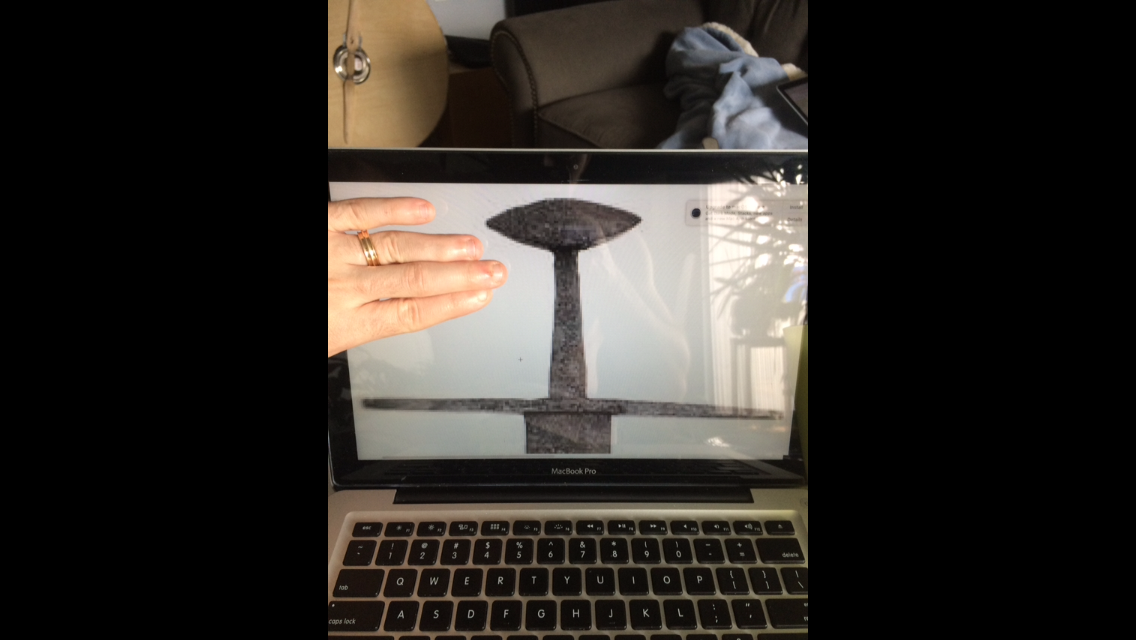

Hey folks,
I feel like I’ve seen the guy on the far right somewhere on this forum, but if anyone can provide more info (dating, location, dimensions, other photos), that would be great. I know Craig Johnson has it on a Pinterest board, but my computer is acting up right now and I’m having trouble getting things to load.
Not sure if the pommel twist is original to this piece or not, but it would make it fit for a lefty...
Thanks in advance!
 Attachment: 136.35 KB
"And they crossed swords."

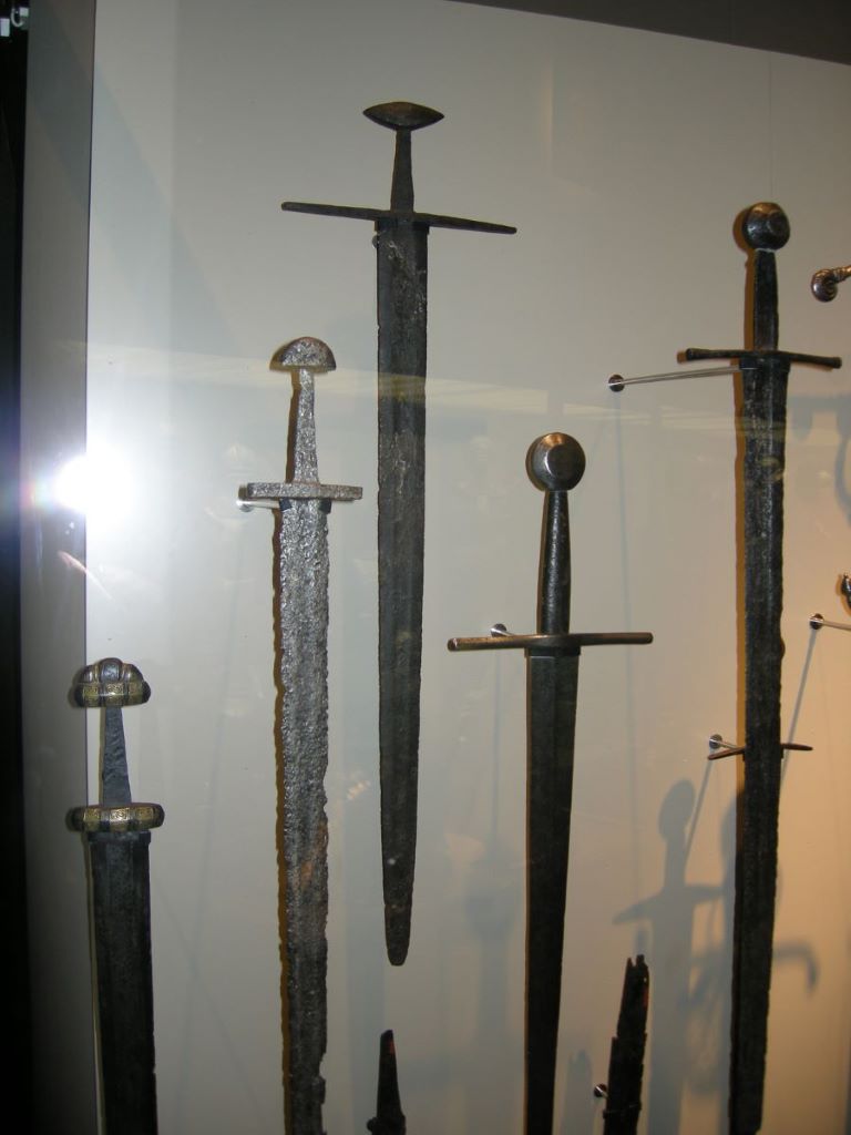

J.D. Crawford
Location: Toronto
Joined: 25 Dec 2006
Posts: 1,910
PostPosted: Mon 30 Sep, 2019 11:27 am    Post subject:         Reply with quote
I have never been able to find any more on that one either. From Brussels, right?
However, if you are thinking of a replica, it reminds me of this bad boy at the Royal Ontario Museum: http://pic18.picturetrail.com/VOL907/4313045/...365561.jpg
There's a lot more data and pictures for this one. In fact I see it often.
Kai Lawson
Joined: 26 Aug 2010
Posts: 589
PostPosted: Mon 30 Sep, 2019 11:55 am    Post subject:         Reply with quote
J. D. Crawford: I’ve seen that one too, but never a full length shot or any dimensions. Do you know where I can find either?
Mark Lewis very kindly sent me a nice full length shot and some measurements. The whole sword is only 1040g—makes me think that the blade is very thin! I blew up the hilt to a mm or two over full size, and the cross is basically a foot long. The whole piece is outrageous and I have decided that I want it. Rather badly.
Unfortunately, I don’t have funds for a reproduction, but I may use some Peter Johnsson geometry and hilt up a cut-down Albion Gaddhjalt blade I have in an ‘inspired by’ fashion.

J.D. Crawford
Location: Toronto
Joined: 25 Dec 2006
Posts: 1,910
PostPosted: Mon 30 Sep, 2019 3:57 pm    Post subject:         Reply with quote
There are some full-length pictures of the ROM sword in this thread. The blade is very long.
http://myArmoury.com/talk/viewtopic.php?t=12694
