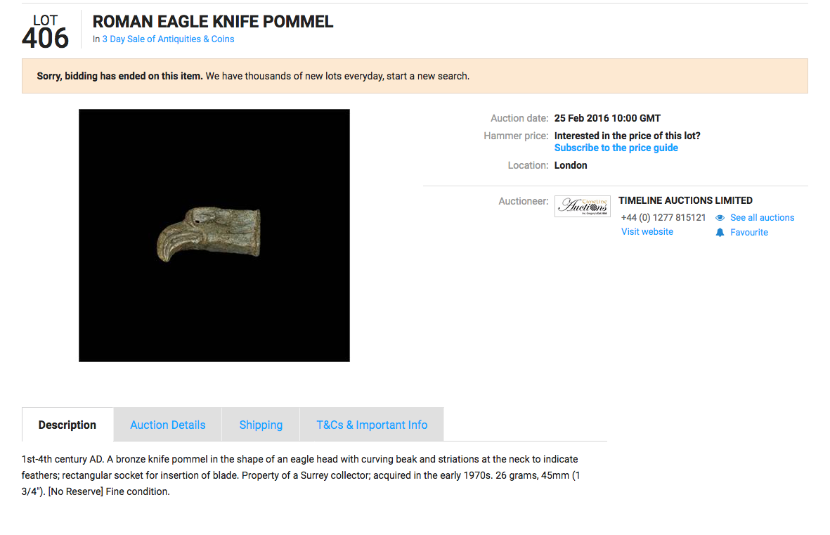

I came across this at auction
https://timelineauctions.com/lot/eagle-handled-knife/135469/
And this https://medusa-art.com/roman-bronze-eagle-pommel.html
And another
Are all these fakes ?, learning curve here.
 Attachment: 91.74 KB
Last edited by Alex D Aspinall on Tue 28 May, 2019 8:38 am; edited 1 time in total
Glaring fake. Bright orange blade (*active* rust) that is otherwise intact, bright green solid bronze hilt--these are all over the place, and not one matches any known *excavated* example.
Same problem with the item you first described, Roman knives and daggers simply did not have pommels like that. This could easily be from an umbrella or walking stick.
And another
Same questions. Note that "From a German collection" means nothing, really. Collected from where? Artifacts have been dug up randomly since the Stone Age, literally, and probably faked for just as long. Or at least wildly misidentified, willfully or otherwise.
Note that there certainly *are* genuine artifacts on the market with useless "provenances", so it really pays to know your material!
Matthew
