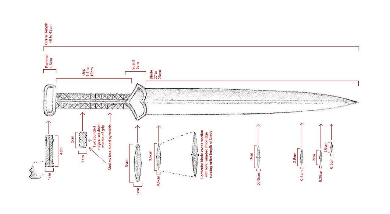

Hello again. I've been asked to design an all-metal akinakes for a custom build and I'd like to make sure the design I've come up with isn't going to be a crowbar. Could any give me an estimate for a realistic weight and balance?
The design is to be all-bronze. I would prefer it to have a bronze hilt and steel blade but I'm not sure that's feasible given the client's budget.
 Attachment: 74.57 KB

You need to calculate the volume of the dagger, and then multiply by the density of the material.
Break up the shape of the dagger into solid forms which are easy to calculate the volume of. The hilt-side half of the blade (the strong) is roughly a diamond-shaped prism (formula V=l*t*w/2), from half-way to the tip is roughly a flattened pyramid (V=l*t*w/6 I think). The grip, pommel and even the guard could be roughly approximated as equivalent rectangular boxes (V=l*w*t).
Calculate each one (where l is the length of that part, w the width and t the thickness) then add all together.
If you multiply the volume of each bit by distance from the back of the pommel to its center, then add them and divide by the total volume, you'll get a rough idea of the distance from back of the pommel to the center of gravity.

Thanks, that's very helpful.
Pommel: 6 cubic centimeters
Grip: 19cm³
Guard: 10cm³ (a rectangular prism would be 15 but I reduced it by a third because of its taper in various directions)
Forte: 12.25cm³
Foible: 4cm³
That should make for a total volume of 51.25cm³. Bronze varies depending on the alloy. I chose 8.9g/cm³ which is on the heavy side, resulting in a weight of 456.12g or a hair over 1 pound, not unreasonable I think.
Going by that formula, the balance would be somewhere around 12.69cm from the top of the pommel, either right at the guard or a little bit inside it.
