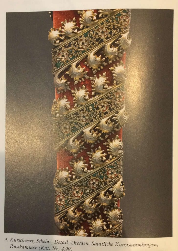

Re: the enamel: as far as I am aware silverwire cloisonné was employed at the beginning of the 15th century to decorate the so-called Kurschwert's scabbard (and pommel?) now in Dresden. Cf. attachment.
I assume other enamel techniques were used, too, and earlier, of course.
 Attachment: 113.74 KB
Kurschwert scabbard [ Download ]

Oh man that is gorgeous with the green felt. Thank for this.
Ah I have seen Tod's work, and it really is nice. You mean this one right? https://todcutler.com/collections/sword-chapes/products/scabbard-set-5
I did not know that this piece used cloisonné technique. Thanks for this, gives me the go ahead for the belt fittings then.

Indeed. Curious construction, too: Wooden core, velvet cover and then twelve metal locket pieces from throat to chape, hinged on one side & locked on the other, on top.
