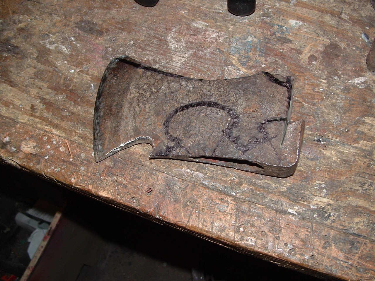

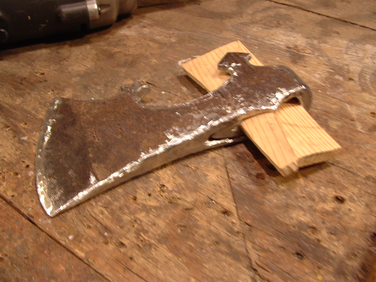

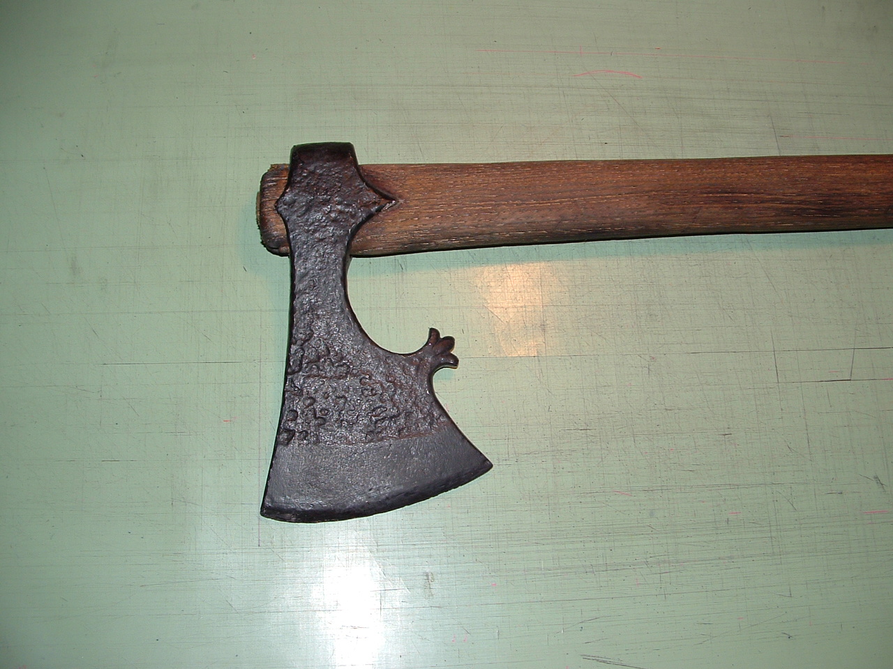

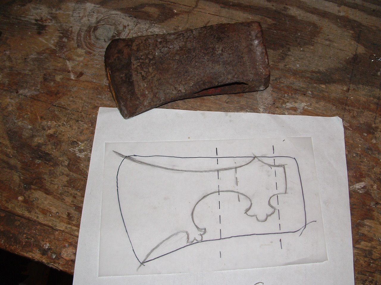

Cut & ground this old $5 flea market Hatchet head that had been found buried in a late 1800's farm yard. It was pretty tough steel and took several hours to shape, i even simplified the design a bit. And it lost over half it's original weight in the process...
I welded a plug into it to give it a better period correct D shaped hole. Ball peen induced pitting and applied a salt water paste for a few days to add patina the freshly cut surfaces. Finally sprayed a light coat of rust retardant primer to darken the new work.

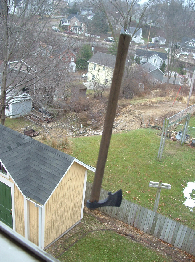

Shaped and distressed a hickory haft and have had it hanging from a 2nd story gutter for over a year now to give it a little more "authentic" weathering. I just checked and i don't think it's ready yet, perhaps this spring...?

Picture from the gutter...
