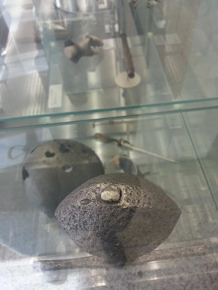

PostPosted: Fri 01 Mar, 2019 5:12 pm    Post subject:         Reply with quote
I have posted this in another thread, but it is relevant here, too.
This is a sword with a Brazil nut pommel from the Germanisches Nationalmuseum in Nürnberg. The peen on the tang is not perfectly flush with the pommel and, as is to be expected, you can see the seam between the tang and pommel.
Photograph taken by Craig Peters.
 Attachment: 917.01 KB
