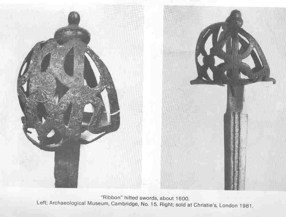

PostPosted: Mon 12 Dec, 2005 8:19 pm    Post subject:         Reply with quote
Here's a couple more for the thread.
The left hand hilt has had its quillons removed, but you can see that it's a ribbonhilt version of the SW11 pattern. Interesting that this one has some engraving as well.
The one on the right is another example of the "short quillon" ribbon; also Sw11 pattern.
As to nationality, I think that the earlier, long quillon versions are English. When the Scots adopted the ribbon construction is a good question. Certainly by the middle of the 1600s (?) there's portrait evidence of the Scottish ribbonhilt, but these don't show the earlier short quillon types. The Tower has one of these with a curved blade engraved "Edwardus Prinz Anglie" which I suppose you wouldn't expect to see on a Scottish weapon. Ribbonhilts, Sw11s, and thin bar English hilts all show up on English colonial sites in America from the first part of the 1600s, which raises the possibility that these are all English in origin, and not Scottish. But this is only a hypothesis, and it doesn't automatically exclude the possibility that the short quillon ribbons are Scottish in origin.
I guess that last paragraph muddled things nicely!
--ElJay
