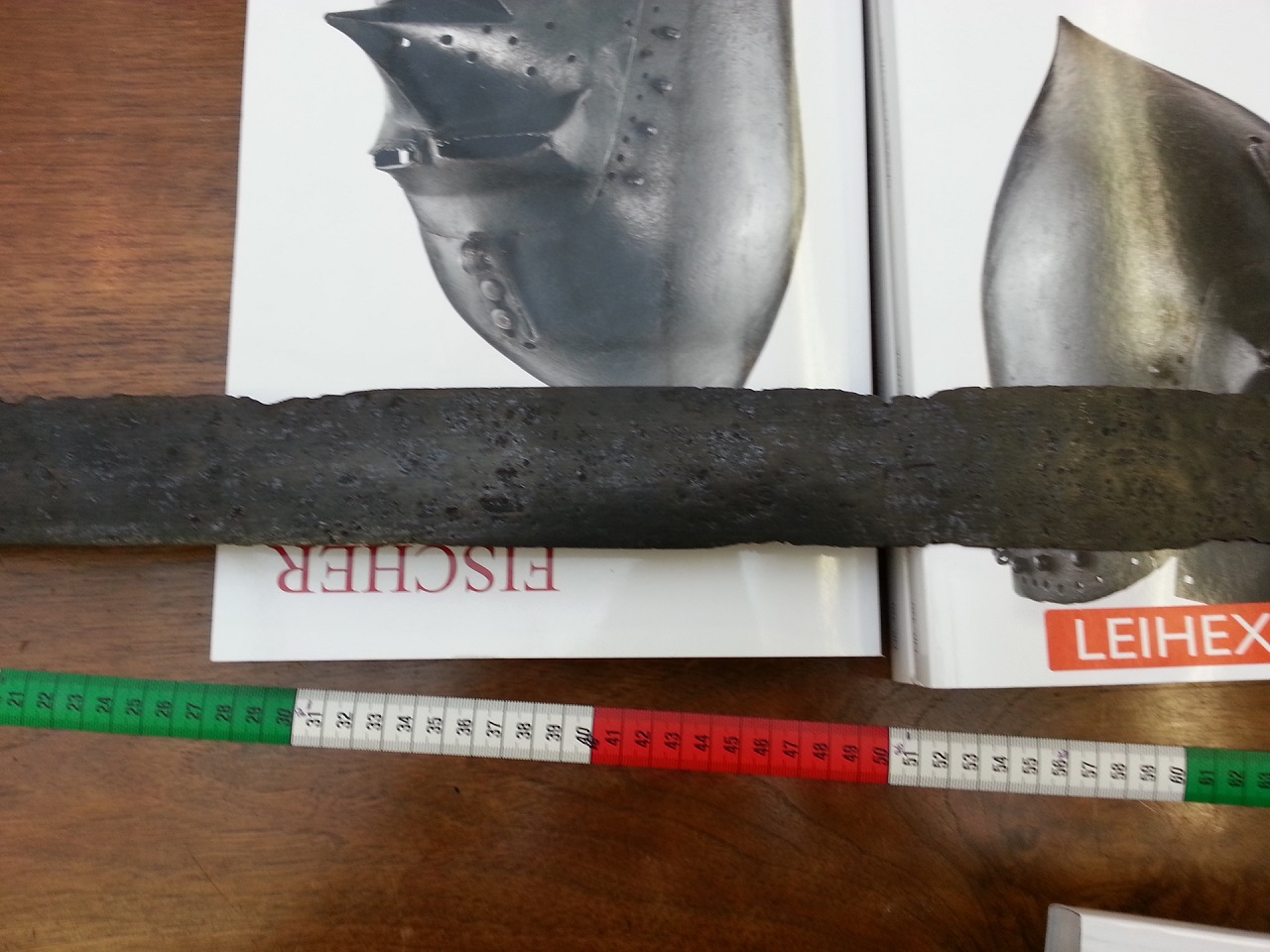

Once again I had the honor and pleasure of examining items for the upcoming arms and armor auction at Fischer Auction House in Luzern, Switzerland. As always, there is never enough time to take all the measurements I would like, but I hope you find this information useful.

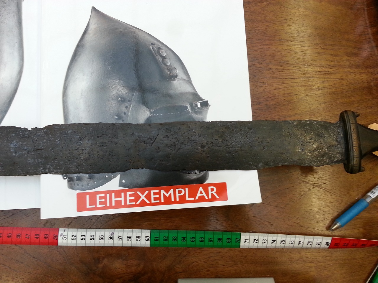

Spatha from northern German region (6th of 7th century):
Lot # 1078
Weight – 684g
Hilt Length – 3.5cm
Blade Length – 72.5cm

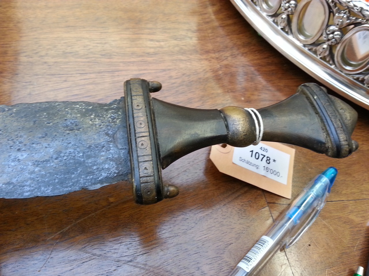

If that germanic spatha is original, it is a very significant find because of the very well preserved hilt... But I somehow doubt it...
M. Szewczyk
Posted: Mon 08 Sep, 2014 9:53 am Post subject: |
Is the spatha's hilt length given correctly? 3,5 cm is the width of approximately 2 fingers, maybe it was supposed to be 3,5 inches?

Overall length is 89.5cm, blade length is 77.2cm, so the hilt (whole, not just gripable area) is 12.3cm.

That spatha, whether an original or older repro, calls to me. I've had little interest in that era, but if I ever had a piece made from that period, it would have to be based on this. Kinda looks like something our good friend Scott Roush might bring to life .

It certainly looks like the River Scheldt find purportedly published in later editions of Oakeshottes "Archeology of Weapons."
See: http://www.swordforum.com/forums/showthread.p...ilted-seax as posted by forumite Kirk Lee Spencer.

The spatha hilt is possibly original. It shows no signs of being tampered with (pins removed, etc). The horn on the grip was analyzed in a lab and although it couldn't be accurately dated, it was not a modern replacement.

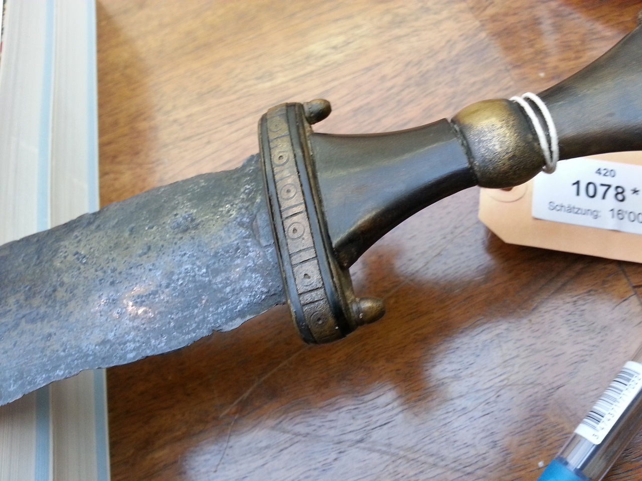

Does anyone have any more pictures of this spatha? Perhaps some close up shots, or one showing the end of the pommel? Also can anyone tell me what the materials the hilt is composed of?

| Josh MacNeil wrote: | | Does anyone have any more pictures of this spatha? Perhaps some close up shots, or one showing the end of the pommel? Also can anyone tell me what the materials the hilt is composed of? |
Can't help with pictures, but the translation from the catalog indicates bronze and bovine horn. Here's the pertinent portion, via Google Translate:
Significant marsh, or river find in exceptionally good condition. Vascular parts of bronze combined with cow horn. Knauf Crown in a rounded pyramid shape with circle decorative eyes on the collected baseline. Knauf beams from three oval bronze and two horn plates riveted together. The Middle Bronze platelets as the identically structured guard (L 6.5 cm) decorated with 7 circular eyes between two vertical bars. Grip of two flat-conical horn sleeves with a central knop bronze.

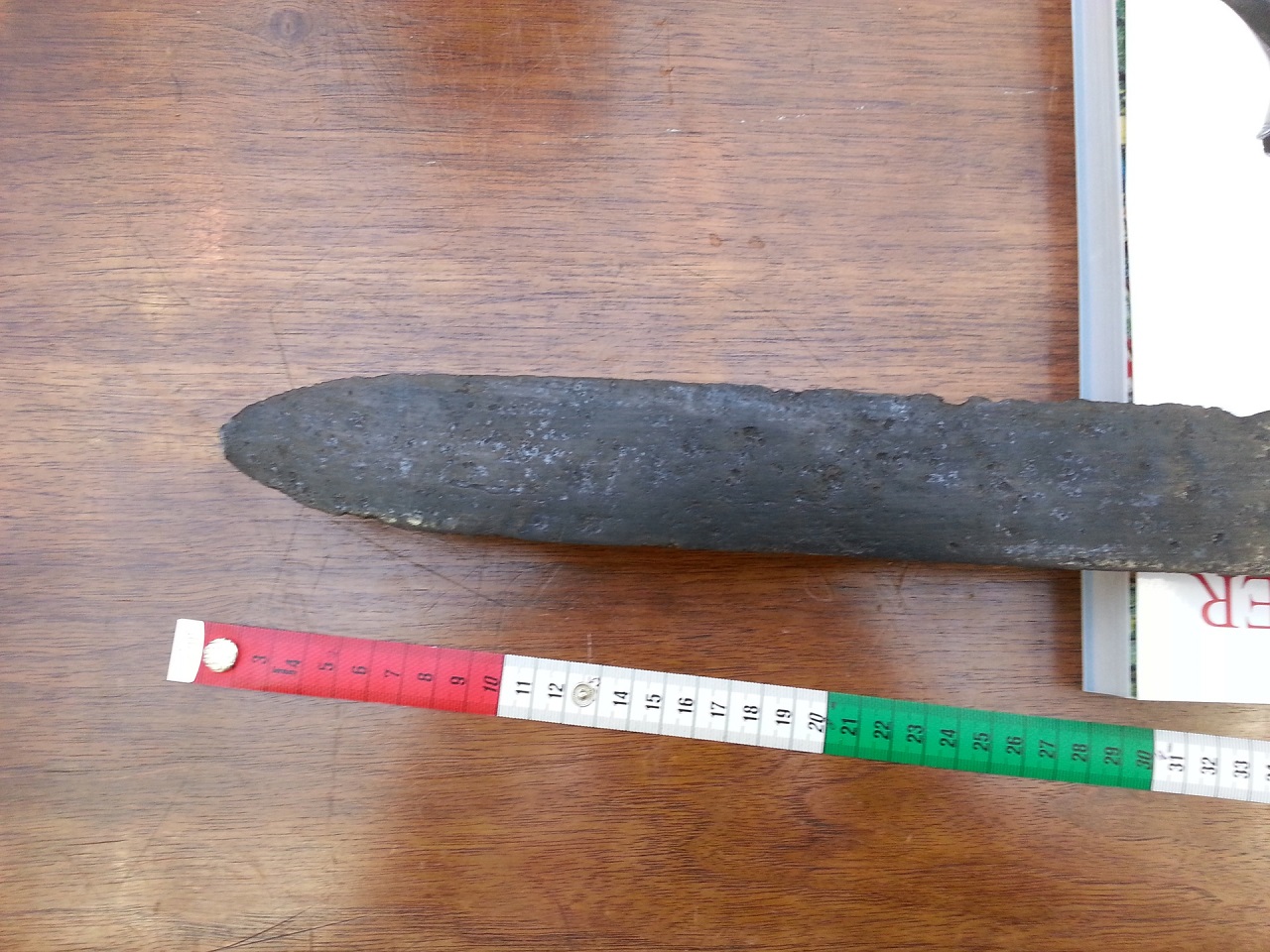

These are the pictures I've gathered of the spatha. There are a few more, but they will not load (even as "click on it to see it" attachments) due to size restrictions - they are all under 1MB, but likely do not fit the 1280x1024 frame limit. I'll play with them and see if I can get them loaded in a separate post.
In other discussions, the direction of the lower guard pins has been discussed as being "wrong" and suggestive of a fake; other suggestions are that there was a "restoration" and reassemble at some point and the lower guard was put back backwards. I lean towards the latter, but have no hard evidence. Those that argue against the "put back upside down" theory often say that the pins are too big and it wouldn't fit a scabbard properly. I feel that those folks have never seen a scabbard with a notch or cut-out - something which is out there on later pieces, but many of these folks fall into the "absence of extant period evidence equals evidence of absence" camp versus the "we might not have found an exact match to this theory, but that doesn't mean it is not plausible and did not exist at the time - lot's of things get lost in 1,500 years".
Good luck in finding data on the other items. If you happen to run across more on this spatha that isn't in this thread, please post it back - I'd like to reproduce this some day and will take all of the data I can get.
