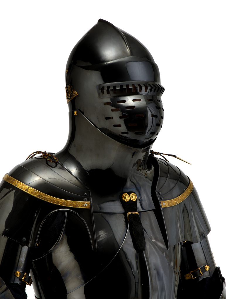

Hi everyone,
Today a question/discussion on shining your armor
We've all dreamed about knights in shining armor as kids, and now that some of us are we know it's not always easy to maintain those steel parts as shiny as ever !
Feel free to share your techniques, what finish you like the most, what materials you use and so on.
Now onto my question
We've all seen the gorgeous Tobias Capwell black harness made by Robert MacPherson, but something seems weird to me, the degree to which this armor shines. Most of the black armors I saw had somewhat of a matte finish, or at least less reflective than their "white" counterparts, so why is this one different ? Chemical blackening is very unlikely, so what exactly was used to make it so shiny and polished ? I have asked Toby and Mac themselves, but I'm still waiting for an answer.
Anyways, have a great day y'all !
Here's a link to a high res picture of the armor
https://www.pinterest.ca/pin/430797520600994478/
 Attachment: 205.87 KB
Aforementioned armor [ Download ]

I watched it and it does look alike but Toby's armor looks darker than any blue armor I've seen before. Maybe it's oil blackened ?

Looking at pictures of the armor I have come to believe it is indeed an oil blackened one, because lighting changes don't particularly reveal any blue coloration on a wide surface. Also small flaws in the armor seem to point that way, for instance a small blue-er spot at the back of the greaves where it's surrounded by black and doesn't seem to blend well, also grey-ish spots on the skirt were maybe the oil blackening didn't work too well, or maybe there were other traces of material.
Picture attached is a picture of the helmet with a different lighting, revealing a grey tone to the metal, not a blue one

PostPosted: Sun 14 Jun, 2020 10:30 pm    Post subject:         Reply with quote
The helmet looks polished before the blackening is applied, it does look like there are rust and some hammer mark. I am unsure how this suit of armor is blackened, but I am certain that the shine level varied depending on how polished the metal is before blackening process is applied.
I could be wrong, but I have a heat blued breastplate and when I applied a 2000 grit sandpaper it wiped away the blue leaving bare metal behind. I am not sure if that's the case for oil blackend armor, but there are chemical solutions used to blue armor(color varied), and with those you cannot wipe it clean with sandpaper, a solution remover must be applied. I say this because the forehead of the helmet looks polished revealing hammer marks and the blue is not so much removed after polishing.

Toby answered me and turns out we were all wrong, his armor was chemically blackened. I assumed it wasn't because of the general high degree of historic authenticity that comes with Toby's work.
Anyways, chemical blackening is obtained by plunging the armor into a bath of sodium nitrate, sodium hydroxyde and water, then heating up the solution, turning the surface of the steel into black magnetite. I am not sure if the polishing of the armor comes before or after the chemical treatment, but the additional shine can be attributed to the addition of a sealing material at the end, wax, oil etc, that was then polished or buffed.
It would have to be done before the bluing/blackening. As you mentioned, the surface of the steel is converted. Polishing afterwards would remove that surface layer to the bare steel below.

PostPosted: Mon 15 Jun, 2020 7:51 am    Post subject:         Reply with quote
It could very well be that, though my armorer tells me this shine is obtained by wiping the solution with oil, then it's a question of coats of oil and/or wax I guess with the right buffing

Lest anyone be confused, the chemical blackening process used on Topy Capwell's harness is wholly plausible as a period technique. Sodium nitrate is a form of saltpeter (substituting sodium for potassium; it's most easily found in caliche ore from Chile and Peru, but it can be synthesized using processes and materials available to fourteenth-and-fifteenth-century alchemists) and sodium hydroxyde is lye. It's also entirely possible that the same patination process works with potassium nitrate (ordinary saltpeter) but that sodium nitrate was for some reason more readily available when the armor was being made.

Toby's armour was black Oxided after polishing, which I do not believe is a period process. Mac said it was done by a commercial company, like this one :
https://www.aftfasteners.com/black-oxide-coating-process/?gclid=EAIaIQobChMImbvi1biW6gIV0yCtBh3xYg7DEAAYASAAEgLX7_D_BwE
Another common finish was heat bluing. Colors from yellow, through red, purple and blue can be achieved depending on the temperature used. An electric deep blue is created at 290-305C
In different lighting conditions, this can look Black or blue.
