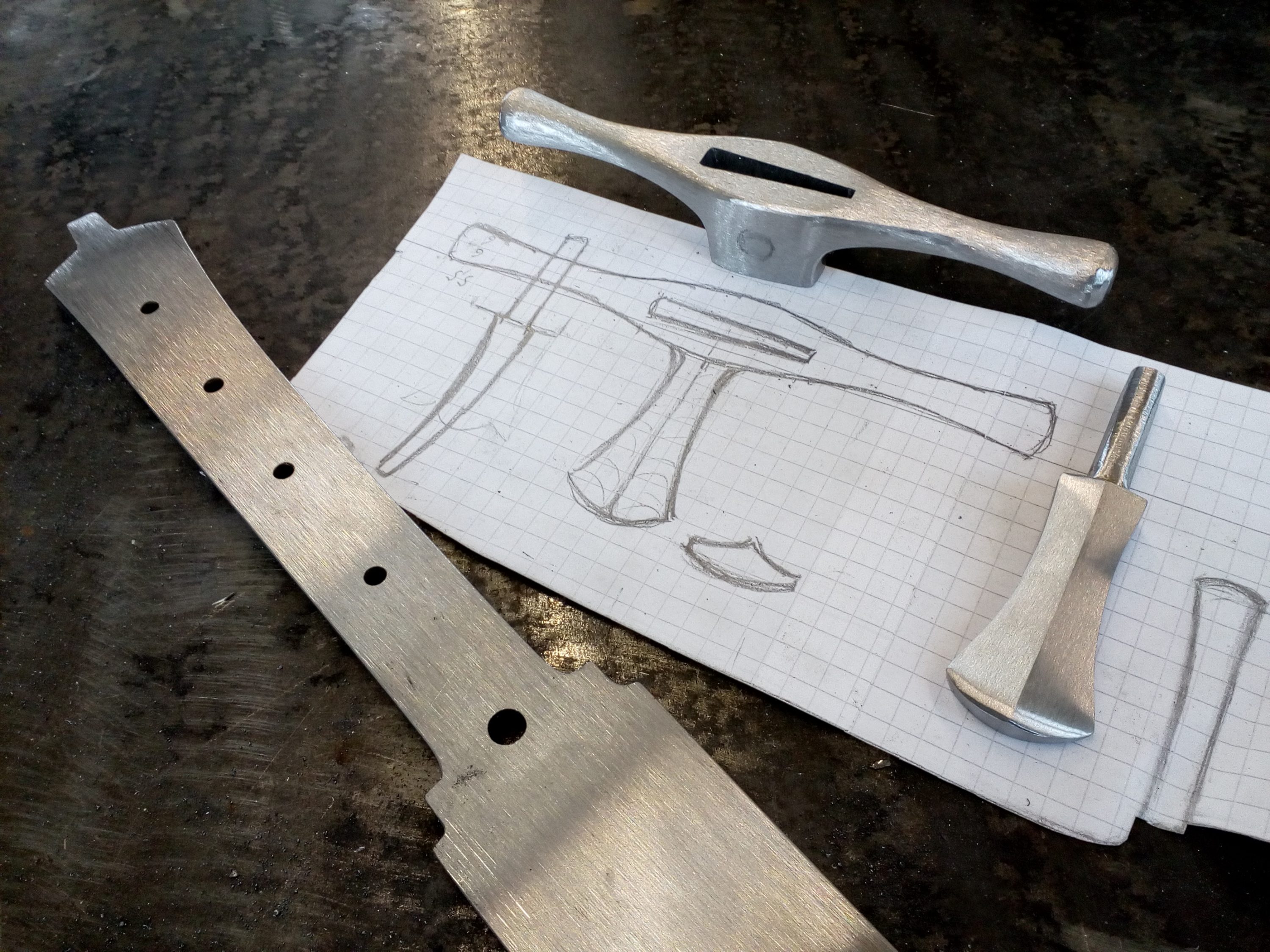

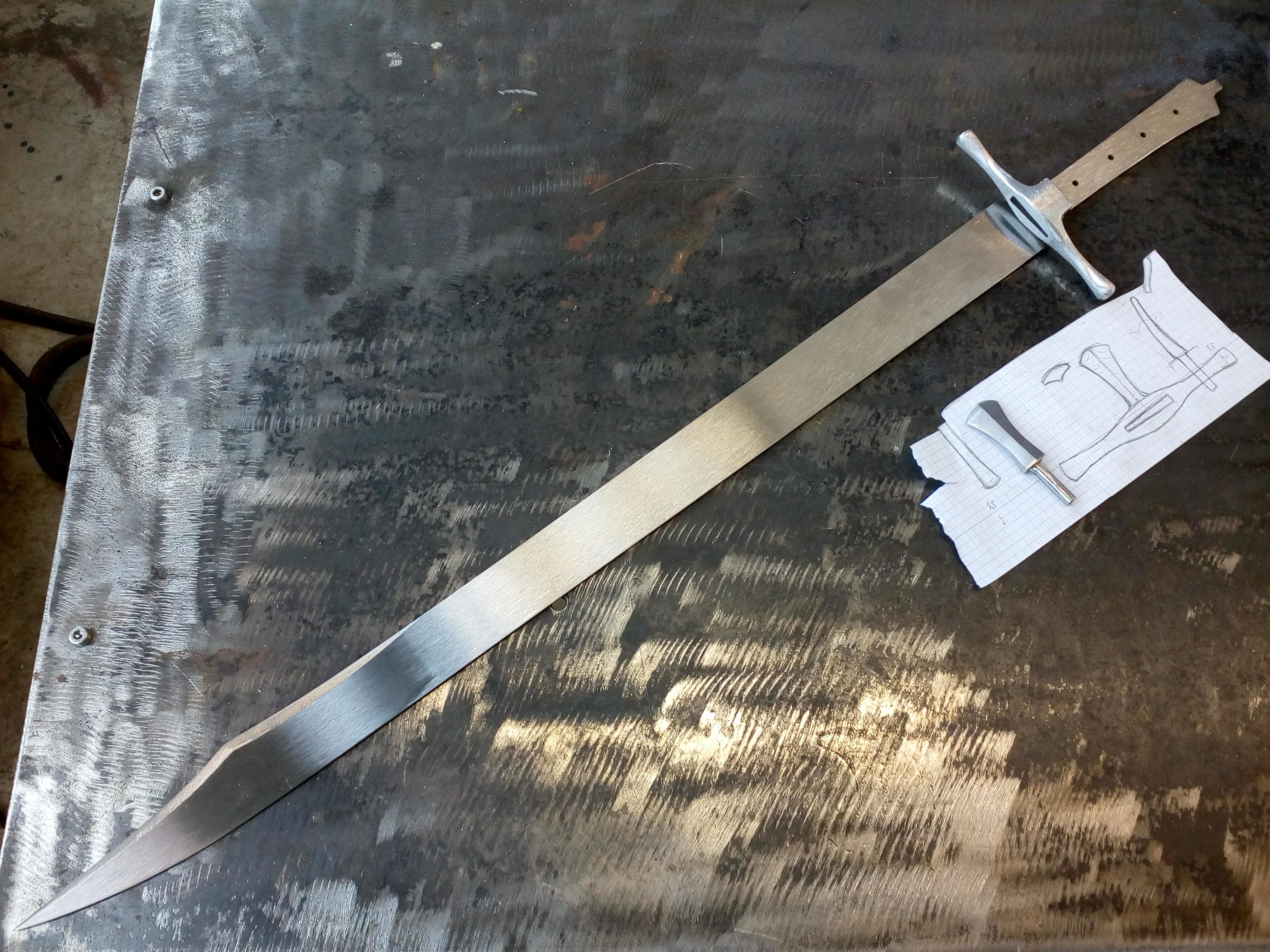

Hi guys,
Next attempt at a Messer... as you may recall, my last one developed a severe forward curve during heat treatment. On this one I left the front edge thicker, hopefully that does the job. If not, I will have to counter-bend the next one. If this one curves forward, I'll probably hilt is a Messer just the same, there are historical examples of exactly that. But I'm definitively hoping it'll stay straight!
The guard was a major pain to make, the tapering slot had me cursing more than once. Soooo much hand-filing... The Nagel on the other hand was quickly and easily made. Not sure yet if I will fire-blacken the fittings or not.

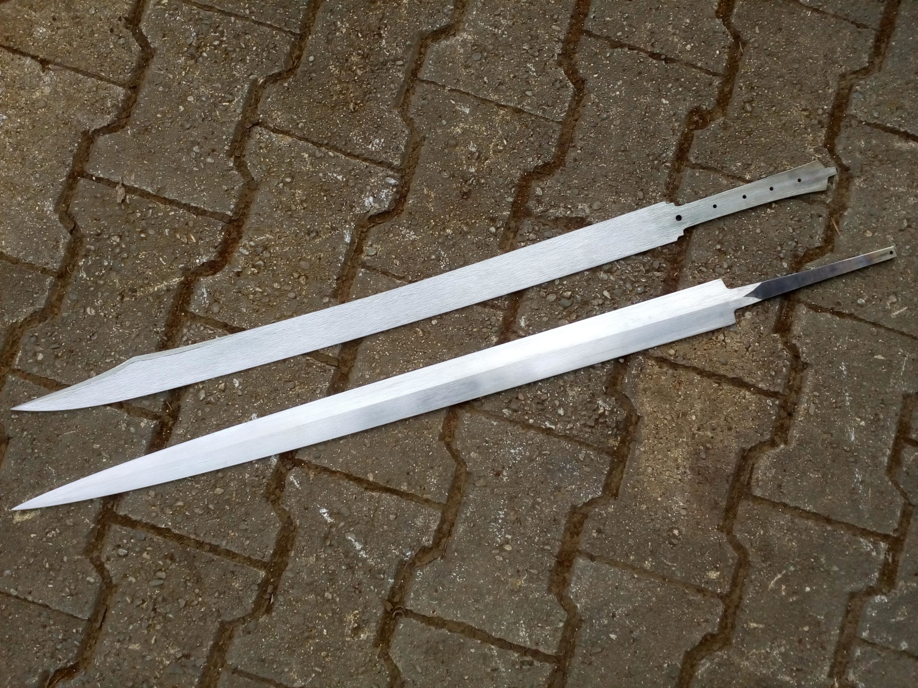

The heat treatment was successful, the thicker edge plus the counter bending made it work. Very happy with that! Here is the blade next to a XVIII arming sword I'm working on.

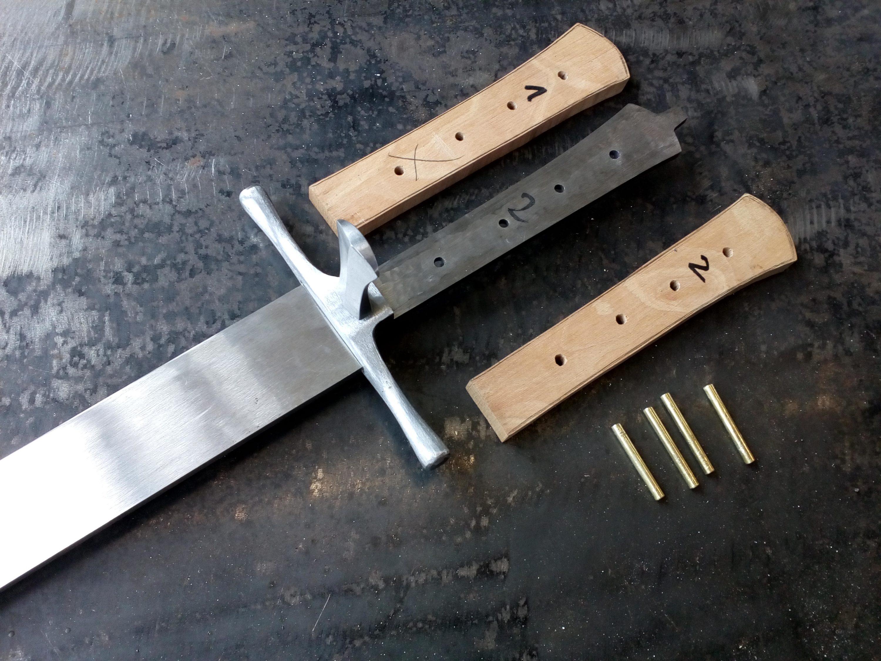

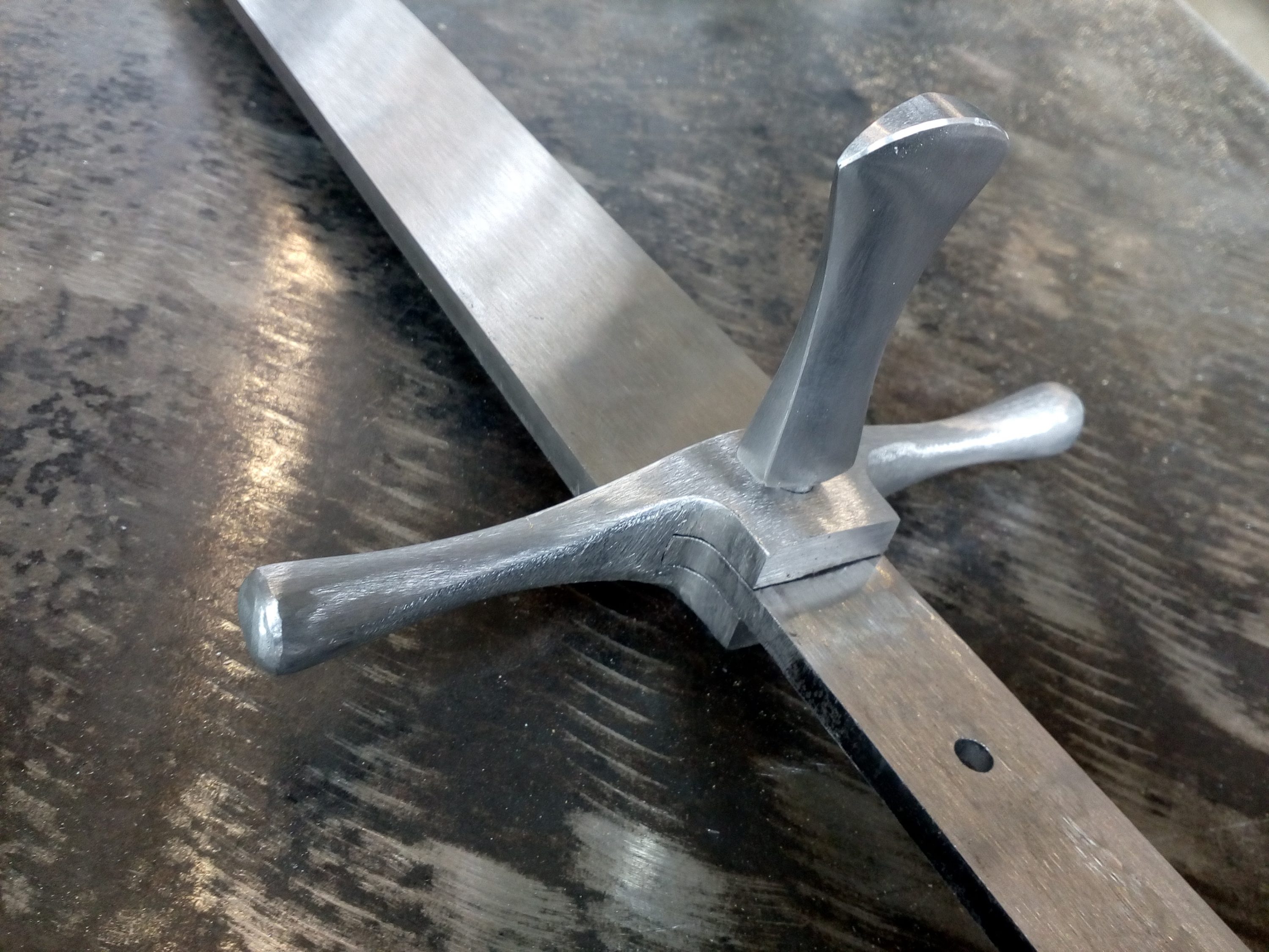

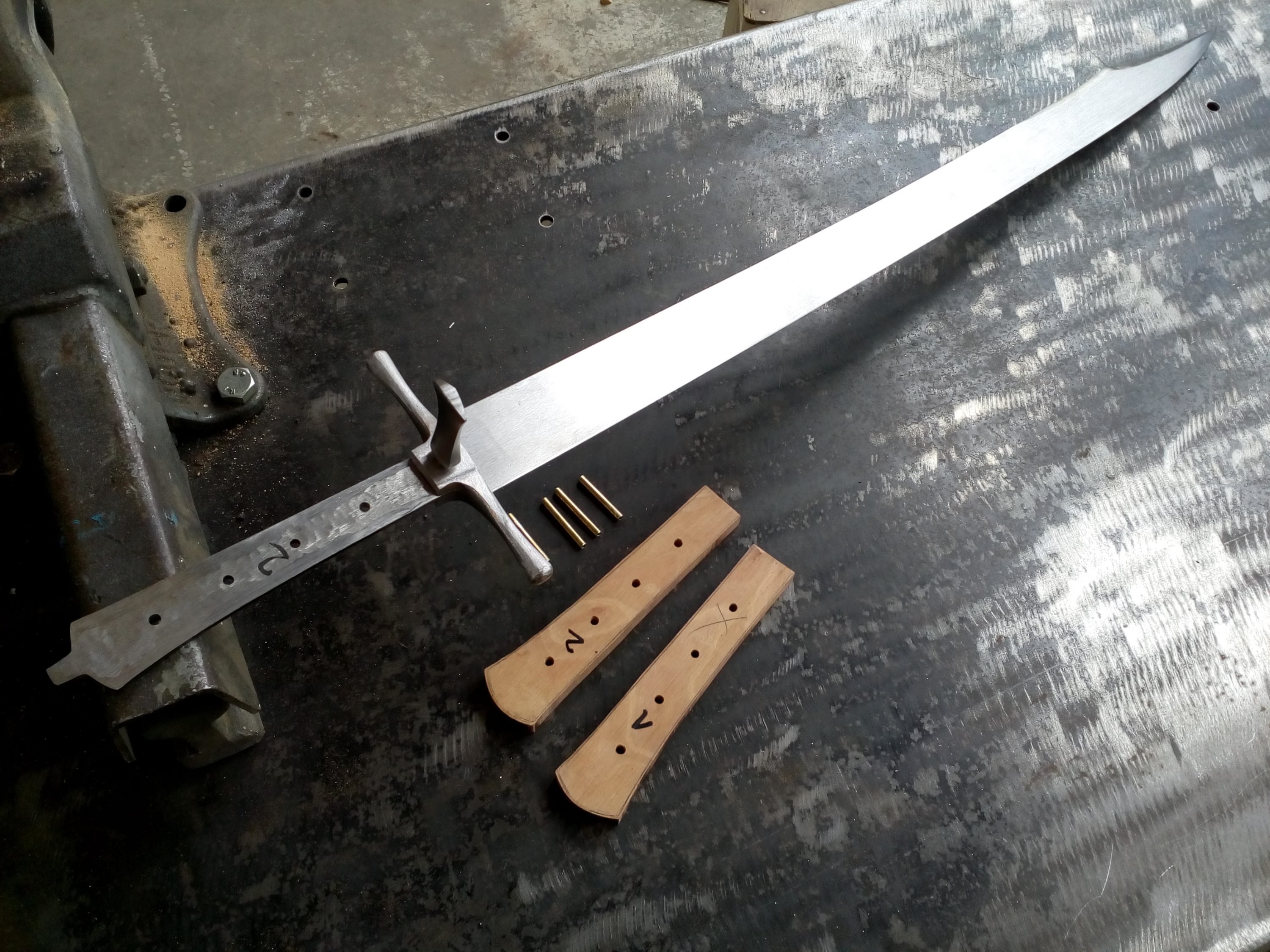

More progress... The blade is now ground to final shape, the guard fitted and drilled to accept the Nagel. Work on the handle scales has also begun.
The messer has started to come alive in hand. All current components together weigh 860g, the final weight won't be far off from that.
I must say, I'm really excited with how this piece is coming together Wink
I still haven't decided what finish to give the guard and pommel cap... I'm tempted to blacken them as I did on the Bowie. Or I might try some forced antiquing, I've been wanting to try Walter Sorrell's method. Or a plain, honest satin finish? Hmm...

PostPosted: Fri 13 Apr, 2018 5:01 pm    Post subject:         Reply with quote
I can't tell whether the guard has finishing marks, or if it is of wrought or a composite steel. If it is one of the latter, then a nice acid etch to bring out the pattern and a good polish would look terrific - at least to my eye.
Lukas MG
Location: Germany
Joined: 23 Feb 2010
Posts: 330
PostPosted: Fri 13 Apr, 2018 9:42 pm    Post subject:         Reply with quote
The guard is modern steel, not wrought. Maybe for the next one Wink
Hi Lukas,
I was considering the very same question for my current hobby project of very similar handle construction (happens to be in just about the same state of progress as yours). My conclusion was that I can't properly blacken a guard of this type as the reverse side will have be filed/sanded to clean up after peening the nagel in place. That would of course destroy any surface finish around the end of nagel. After assembly you can't really use heat bluing as that would damage blade's temper. Chemical ("wipe on" kind) bluing could be done, but it is in general an inferior finish and it would be very hard to avoid getting some of the bluing solution on the blade near guard.
Have you found a way around this problem? So far I am planning to leave my guard/pommel satin finished.
BTW, I love the shape of your blade and guard. Very clean lines, not too plain and not too ornamental, just right.
Alex.
Lukas MG
Location: Germany
Joined: 23 Feb 2010
Posts: 330
PostPosted: Wed 18 Apr, 2018 12:41 pm    Post subject:         Reply with quote
That's the tricky part, yes.
I think that it would be possible to peen the Nagel without having to do much filing or sanding, so the finish of the guard should remain intact. The peen would be standing proud and not be blended in but I tend to prefer that anyway. The peen itself can be heat blued, with a concentrated flame only a small portion of the blade would be heated up and in that area, loss of hardness isn't a concern. Likewise, you can apply cold blue (gun blue) precisely to just the peened end with a small sponge or brush.
Custom sword maker:
http://www.lukasmaestlegoer.com
Alex Indman
Location: NYC
Joined: 13 Sep 2012
Posts: 179
(3 total ▮ 100% positive)
PostPosted: Wed 18 Apr, 2018 2:12 pm    Post subject:         Reply with quote
I see, your plan is to leave the peen standing proud and so clean that it won't require filing to finish. I don't quite trust my skills to achieve that (and don't leave any hammer marks on surrounding surface). Besides I would prefer to have the peen blended in as much as possible. So it's satin finish for me, definitely.
Alex.

Lukas MG
Location: Germany
Joined: 23 Feb 2010
Posts: 330
PostPosted: Wed 25 Apr, 2018 1:47 pm    Post subject:         Reply with quote
I think you are right that this would have been an unusual feature. I would call it artistic license Wink
