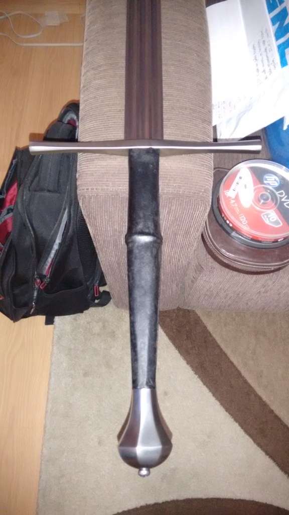

Hello guys!
Does anyone know if it's normal for a peened pommel to move a little bit?
I have a sword with a peened pommel (a scent stopper), and although I'm very careful about it, I can move it's pommel a little bit to the right or the left sufficiently enough for it to be out of alignment. I don´t hear any strange noise when I use the sword, and I can´t see any gap between the pommel and the grip, but if I can move it for sure there is a small one. What puzzles me is that I'm afraid it may cause the hilt to break.
All the best
Fábio

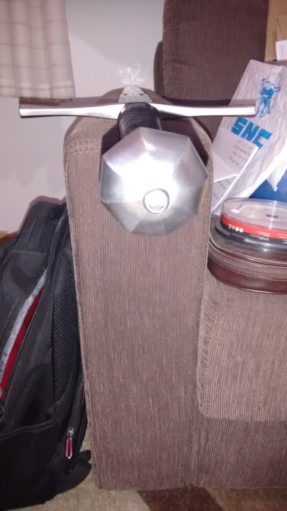

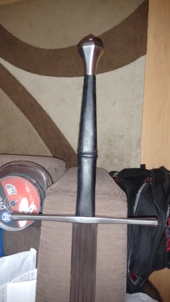

It´s a custom type XX from A&A. Price range is around 1200 USS. As you may see it is just a little bit, but still I'm not sure if it is normal for a peened sword.
 Attachment: 177.22 KB
 Attachment: 186.78 KB
 Attachment: 191.56 KB

If it moves then that means it's lose. You need to tighten it. I usually tighten up my peened swords by clamping them into a vice and tapping the peen down with a ball peen hammer. Works charms.
Well, THAT shouldn't have happened... Is the tang button a separate piece? Usually with A&A swords these are separate, and the button or peen block is screwed on tight and then peened. My guess is that the grip shrank ever so slightly in shipment, which is why the pommel is loose.
So, to fix you should actually screw down that tang button, and THEN re-peen it, assuming that I have correctly deduced the manner of construction. You will want to use a pliers or vise grips, with a piece of leather or rubber in the jaws to prevent scratching the tang button. Get it tightened down as much as possible, and then you will need to peen it down. Do you have a ball peen hammer, and a wood block to put the point of the sword on? This should be (I hope) a pretty straight forward fix.

Back to the peen: I have taken the chance and peened loose pommels a few times myself with good success, but it is a risk doing it cold if one over does it and the peen breaks at the corners if metal fatigue makes the peen fragile if one goes at it with one too many hammer strikes.
Also doing it neatly means controlling the number and placement of the hammer strikes.
One good thing is that the pommel is symmetrical and basically the same all around: A disk pommel that can move in and out of alinement with the edges of the blade and with the guard is much more annoying.
If the grip has shrunk it might be possible to get some drops of super glue into the gap .... but this might stain the grip leather or not work.
Firstly wait for Craig's e-mail or PM reply before doing anything: He may offer to repair it, or at the very least let you know exactly what to do if you want to do it yourself, probably then if you accept the risk of doing it yourself.
In my case with International shipping I do my own repairs when they are minor and I think that I can do it myself.

I would suggest that only the square/pyramidal peen blocks of the A&A swords use the threaded approach.
A rocking, or shifting of the pommel shown in this thread is a little more disturbing to me, If there is side to side shifting, even a good bonk or (if threaded) otherwise tightened, will never truly avoid slippage. The one A&A I had apart had the kind of opposite issue where the pommel was seated tightly but keeping the compression from tightening the cross guard. The only way the shown pommel would shift so is if the opening in the pommel isn't tightly keyed/fitted to the tang's width. If it is truly rocking, I don't see an easy fix without disassembly or maybe superglue. Grips do shrink but the metal components really do benefit from close fitting.
