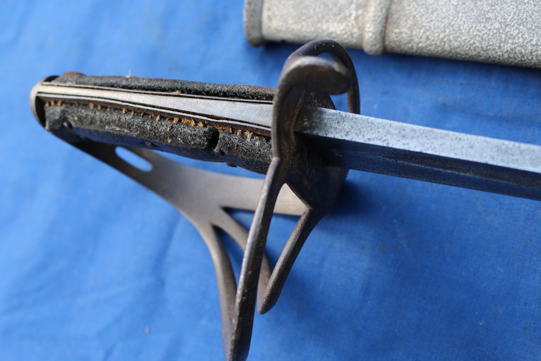

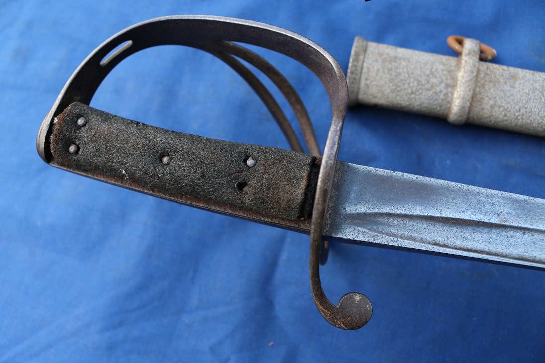

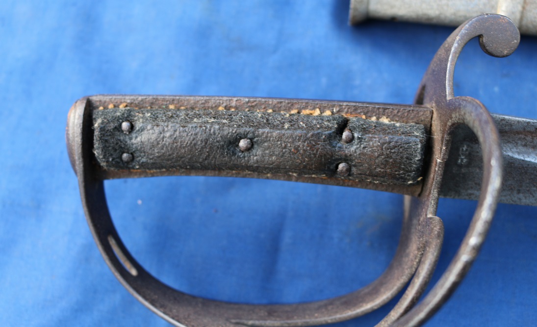

I am jumping the gun on this because I haven't received the sword yet, but I have purchased a Reeves 1853 pattern cavalry sword and am waiting on it's arrival. I bought it at a good price. It is solid and in good shape except for the handle which has some damage. Photos are attached.
I may try to restore the handles myself and if I feel I am unable to do it correctly, I will send it off to a restorer to be rehandled. I would like for the handles to be as original as possible.
My questions are: Do you know of any books on sword restoration, specifically restoration of handles, grips, etc. ?
Also, do you have any recommendations on sword restoration companies in the U.S.?
i will also do some cleaning on the blade and guard, but I am not trying to get the sword back into it's original condition, but a presentable functional condition. The scabbard is in pretty rough shape with some small holes corroded into it, but I plan to just leave that as it is.
Any help, ideas, recommendations and/or advice will be appreciated.

Personally I wouldn't restore it at all unless you intend to use it. Stabilise it so it doesn't deteriorate any further and leave it at that.

It seems like most 1853 grips deteriorate and I have yet to see someone that has offered replacement grips.
Dan is spot on, unless determined to make it a using sword (ie cutting practice). I use Pecards antique leather formula
https://www.pecard.com/product/antique-leather-dressing/
I have been working on a six oz tub for more than a decade, It does darken leather but does nourish and stabilize grips. I would look at most antiques from a conservation vs restoration aspect,

Thank you Dan and Glenn. I will try the leather preservative. The leather on this sword is damaged from water. Once I get it I will be able to see how bad the damage is and if it is falling apart. Thanks for taking the time to give me your advice.

I would agree. As a collector of antique swords, restoration or replacement of parts and removal of original surfacing or grips doesn't help the value, if that is a concern.
There was a pair of nice 19th century duelling pistols at an antique arms fair two years ago that a lot of people were looking at but the person had restored the case hardened and browned parts of the metalwork and buyer after buyer looked at them and said they're nice but ..... and moved on.
Museum wax and a good quality oil I think unless you are intending to use it for practice and sacrifice the antique piece aspects of it.

I should say museum wax is for the metal parts not the leather. A good leather balm is what I use on scabbards on the smallswords I have which still have their original scabbards. Also be careful if there is any blueing or other surface treatment on the sword as some oils, like break free oils, are not good for those types of surface decoration.

My 1853 Pattern Cavalry sword was delivered today. The scabbard and grips were in much better condition than what I had expected from the description and photos provided on Easton Antiques website. The scabbard is heavily pitted but is very solid. I was expecting it to be falling apart. The grips are deteriorated, but are very solid. I am very happy with it. The British Cavalry soldiers may have complained about it but I'm not.
