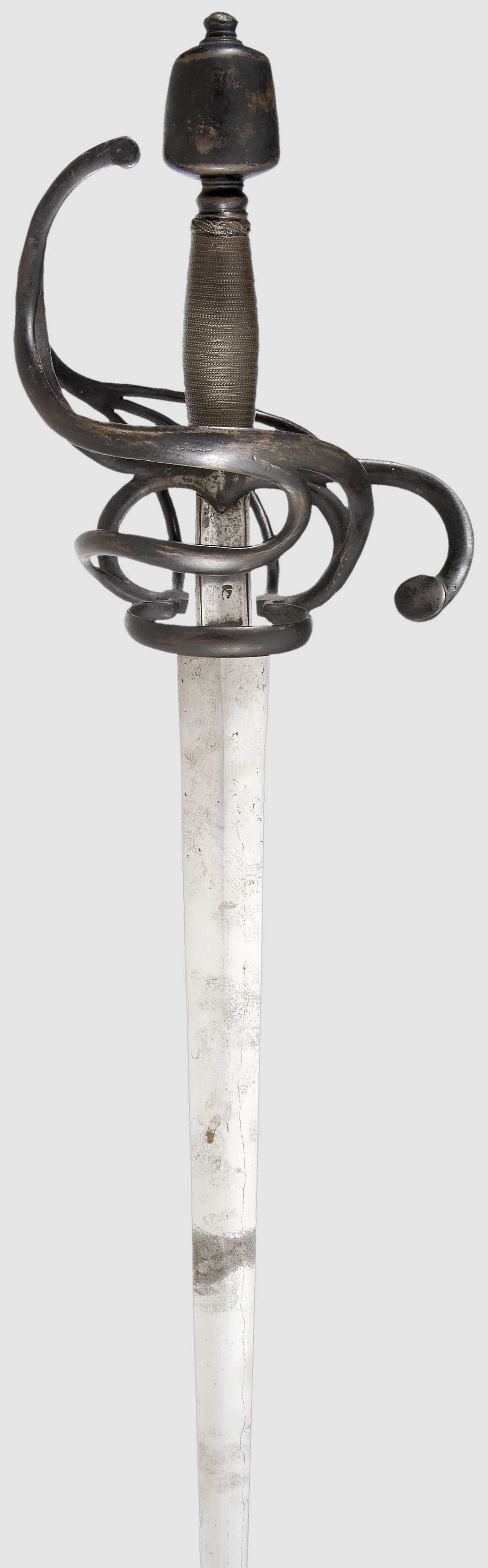

The problems I see are, I think, well within your ability to fix. The edges of the bars need to be a bit more rounded and thinned. I'd slope the shoulders of the blade. The escussion should be thinned so that it slopes toward the blade. I'd redo the grip, shortening it by about 1" (notice that in every case below the knucklebow terminus is level with either the lower part or middle of the pommel). Many of the pommels on this type are of fat lenticular section rather than round, you could grind or file this one without too much trouble but I think round section is within the realm of possibility. I'd blue the hilt furniture because this appears to have been the typical original finish of these field swords. I'll be bluing my A&A eventually.
Here are some of the images I've collected. Note that the last one in the second set below is Wallace A612--You can just stroll (or ride and stroll) across town and study it in the round (lucky!).
If I were headed to London I'd be happy to bring you one! If you wait a bit and watch the MRL "Deal of the Day" you might be able to get one shipped for a reasonable total price.

Mine arrived today, and I'm pleasantly surprised, overall. I'll comment a bit and post some quick photos in the morning. For now I'll say it's definitely worth the Deal of the Day price, maybe just worth the MRL list price as-is and has potential to be worth even more than that with some well-researched and carefully executed upgrades.
I won't spoil a formal review, but here are some key points worth considering if you get a chance to buy one before a formal review is ready--very good balance and weight but uncomfortable to hold/use due to overbuilt bars and sharp edges, especially in the quillon block. The grip can indeed be shortened the required amount (~1") to correct the hilt proportions and get the grip to historical length. The ricasso is appropriately robust and the blade is appropriately stiff. The pommel is massive--far too large and rounded, and with a foot that significantly oversteps even the raised part of the grip binding (faux turks' heads).
What To Expect When You're Expecting a Stantler Field Sword: Significantly flatten the pommel on a grinder and narrow the foot and nut, thin and soften the edges of the outside bars, finger rings, knucklebow and quillon block, add simple filed detail to guard terminals, slope the shoulders of the blade, narrow the lower third of the blade, create shorter, wire-bound grip and turks heads, blacken hilt.
Do all of that well, with close attention to documented originals, and I think you'd have a sword with a fair value of $350-$400. Add a good scabbard and suspension--maybe $450-$500.

Hello,
The inside (back) of the guard on the Museum Replicas sword looks quite bad. It would be very difficult to correct. I haven't seen any historical examples in which the three bars converge in such a manner.
