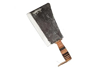

Hello all.
recently i forged a "machete" inspired on butcher blades in Tacuinum Sanitatis Lat.9333, a famous Medieval book of health.
Looks like a simple blade with wooden scales, four rivers and a integral hoop.
Is a leaf spring.
is a 51 centimeters long, 5 millimeter thickness on start of the blade and thinning to the end. 760 of weight.
After finishing i found this picture, is a Fra Angelico's depiction of Saint Peter of Verona, a very similar blade, but larger appears
Thanks for watching!

The result looks very neat! As I'm interested in kitchen knives too, this kind of creation naturally catches my attention.
The blade is quite nice, I love it. What is its length?
I don't feel so much affinity with the handle (it is too long for me), but it sure matches well with the blade.

PostPosted: Tue 15 Aug, 2017 6:39 pm    Post subject:         Reply with quote
Thank you both!
The blade length is 33.5 centimeters. There are several pictures of similar tools in the book, I will try to forge other interpretations, I like them very much these tools.

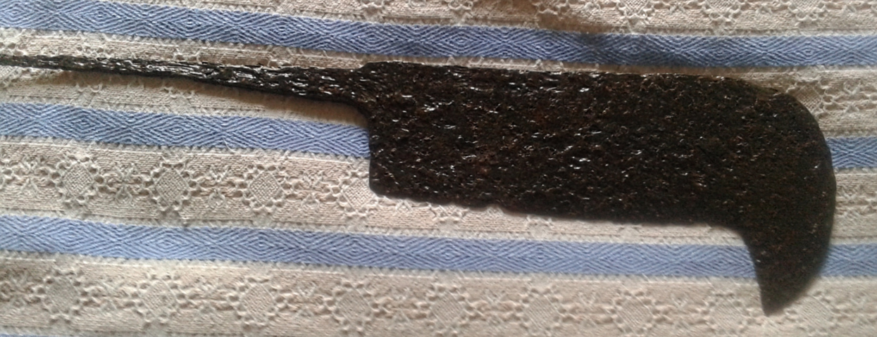

PostPosted: Wed 06 Sep, 2017 4:19 am    Post subject:         Reply with quote
This is heavily fibrous iron/steel, heavily tapering blade and tang (both at base are circa 1cm thick, end of bladeis around 2-3 mm, tang tapers almoost into a point )
Blade length 24cm, total 42.5 ca
Early form that would alter evolve into roncone, clearly derived from a ronca (branch cutting tool), but tapered like a weapon and nimble in handling (bare hands handling, not hafted, already very good and authoritative)
