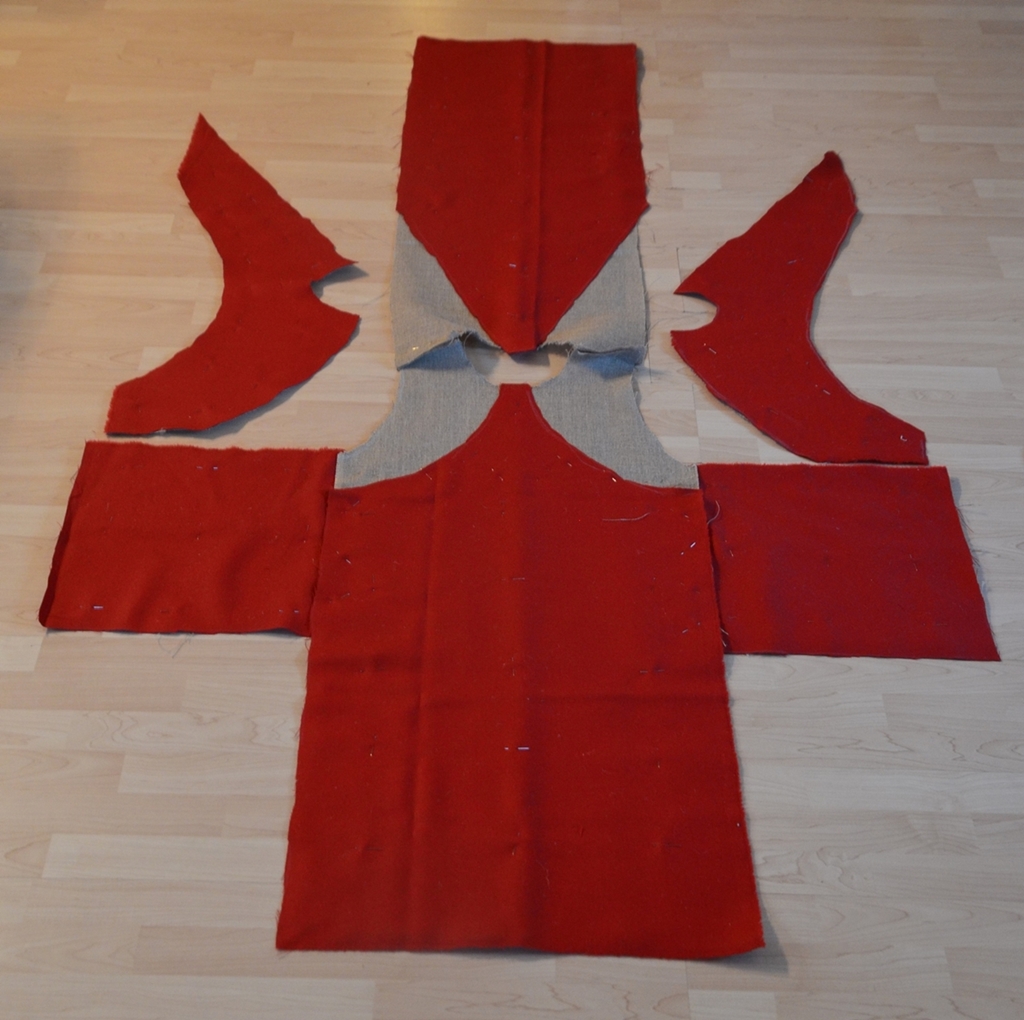

Following a discussion in the XIII century armour-group on Facebook and on the Armour Archive and Cite d'Antan's recent series of pictures of the Magdeburg-st Mauritius, i decided to incorporate Mart's theories (from Len Parker) in my CoP project. In short, the lines on the CoP of the st Maurice statue in Magdeburg as well as the st Maurice image in Lögumkloster church are interpreted as a separate textile piece tailoring the shouder and neck area avoiding unsightly bumps on the front and back of arm holes so often seen on reconstructions.
Layout of pattern for the st maurice CoP
After most sewing is done, the theory seem to be working just fine.
[ed: Placed images in attachment due to photobucket-trouble]
 Attachment: 571.31 KB
Layout of pattern for the st maurice cop [ Download ]
 Attachment: 337.75 KB
After most sewing is done, the theory seem to be working just fine. [ Download ]

Thank you guys. No inside shots yet, I'm afraid. The plates are just fastened with split pins for now. But here's the layout. Guess which Visby CoP-number it is based on.
I went for 1,2 mm (ca 18 gauge) mild steel as that was avaliable, but unable to harden the steel, I suspect I might regret it after the first spear trust my way. With 1 kg textile, the whole thing should come out at 5 kg (11 pounds). As rust protection I went for blackening the steel like you wold an iron pan. After dishing out the curve with a rubber hammer on a shaped stump, the barbecue commenced. Some test carbonization resulted in the kichen stove becoming out of bounds for the project.
Linseed oil carbonized just fine at ca 250 degrees celsius (that's 482 degrees Fahrenheit for you old schoolers), turning from transparent to sticky brown to blank, hard black in 20-30 min. It took two turns and a rubbing as I did not take the "thin layer of oil" seriously enough.

Still some time left before the "missing link" is finished I'm afraid, but at least the last rivets have arrived and are prepared.
In the meantime a word on riveting. Many torials advise punching holes through the canvas. This reduces the strength significantly where you need it the most. In stead, the historical way to do it, shown on lacing holes, is to work a large awl, fid or knitting pin through the canvas, compressing the weave around the rivet. This way the textile around the rivet becomes the strongest in stead of the weakest part. I went for large diameter rivets for the same reason.
I needed some solid and historical laces to fasten the back flap to the torso beneath the plates, and decided to weave them myself using tablets and rather thick silk thread. (For ease of work I made myself a quite unhistorical combined schuttel and weaving sword, but let's keep that a secret, shall we?) For a first, it went relatively fast, and it is quite realistic to get a full set of laces finished for you full plate guys out there.

Soo. First test with all plates in place. The narrow curvature of the lower front plates gives the upper plates quite a large instep. I should've had some curvature in the vertical plane as well as the horisontal plane with the front plates, like we see in Magdeburg-st. Maurits,
What do you think of the fit around the arm opening? Shall we say this supports the theory of the lines and tayloring discussed above? (I do believe this would work just as well with the upside down V set lower in the front.)

How much flexibility is there across the chest? If there isn't any then there may be issues using some weapons. The solution would be to make the arm holes bigger to reduce the coverage across the chest.

I was a bit worried aboat that, but it seems like I left sufficient space and I'm able to swing my arms around with no hindrance. I do feel the plates when my elbows cross, but the chest part compress enough to leave space for more than suficient movement.

I don't see any sign of puckering in the front of the arm, so I would say the tailoring experiment is a success. I must say I am most impressed by the way your seams at the intersection of the side panels to the body look very much like the Magdeburg Maurice. Are you using flat-felled seams?
Thanks, Mart. No, not with the lateral panel going all the way under the vertical one. The vertical panel got double hem seams before I sewed it onto the lateral panel with back stitches and a second row of tunnel stitches on each side. With the cut and thickness of the backing and cover fabricks, the visual impression is more or less given.
