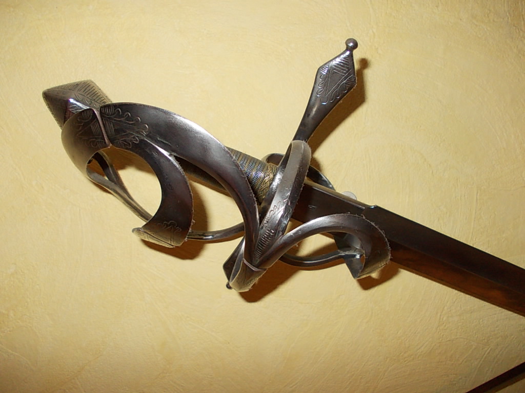

I am making a few scabbards, but now am wondering what to do with a 1580ish cavalry Sword. It has a blunt, rectangular ricasso, and I have no clue wether or not that is supposed to be covered by the scabbard, too.
I'd apreciate advise.

I would think that the ricasso would be covered by the scabbard, unless the guard is built with such things as ring guards, finger rings, etc. that go down the ricasso and not allow the scabbard to go all the way up to completely cover the blade. That's just MY way of seeing it. Happy ....McM

I recall seeing rapier scabbards with tongues extending over the ricasso, but open on the sides. I think there's something like that in the Wallace Collection.
That is because the various rings and guards of the guard often come very close to the blade at the sides so they scabbard cannot be closed at the sides.
Generally the ricassso is covered.

Well, so, soe the 'being open' only apply to the one side that has a ring close to it, then?
I'll try snap a photo of the sword in question.

It's a cavalry sword by Wladimir Cervenka.
I intent to get a 3/4 armour at some point, and wonder what sort of suspension such an armoured trooper would likely have used for such a sword (and the matching dagger)
