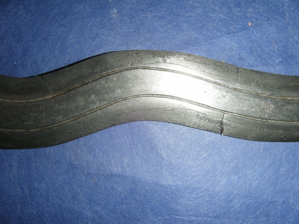

This is if we are considering modern best-practice heat treatment. For pre-modern heat treatment, pattern-welding (and simple lamination) can make it easier to heat treat. Welded-edge and sanmei, whether simple lamination or with a decoratively pattern welded body/sides can really benefit from dissimilar steels with dissimilar response to heat treatment.
In particular, if you don't get the tempering right as can happen easily enough if you auto-temper (or don't temper, just quench), low-carbon alloys will leave you with a blade that won't completely break.
An example of a blade that looks like it was saved from complete failure by such a soft body:
More photos and details at http://vikingsword.com/vb/showthread.php?t=18446&page=2

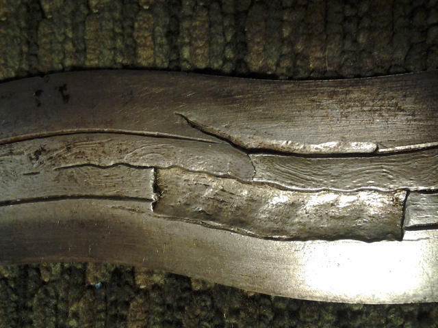

It isn't always good if a blade breaks like one piece of steel. Here is another pattern welded blade with major damage (looks like the result of major bending), where the cracks haven't spread across the whole blade:
More: http://vikingsword.com/vb/showthread.php?t=15971
