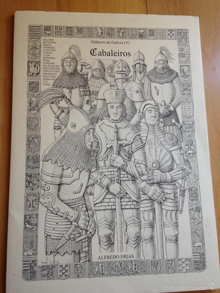

Iagoba Ferreira
Joined: 15 Sep 2008
Posts: 192
PostPosted: Wed 18 Jan, 2017 7:11 am    Post subject:         Reply with quote
So much work still to be done here Sad
For those interested in Castilian equipment, the artist Alfredo Eiras has a nice collection of drawings of effigies of Galician knights from the XIVth, XVth and early XVIth centuries...
More pictures of his knight related works here:
http://espaciocusachs.blogspot.com.es/2009/09...erias.html
 Attachment: 168.56 KB
Mark Lewis
Joined: 19 Apr 2014
Posts: 382
PostPosted: Thu 19 Jan, 2017 6:16 am    Post subject:         Reply with quote
I would definitely like to see more research into this also... Is it the case that many effigies in Spain have been destroyed like they were in France after the Revolution?
