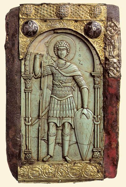

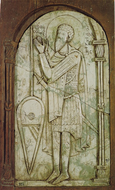

I think these roman soapstones might fit the bill, though they might not be that relevant if you're specifically looking for western stuff:
There are also some scabbards in Skylitzes that aren't paralel with the leg, here are a few of them:

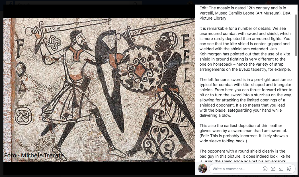

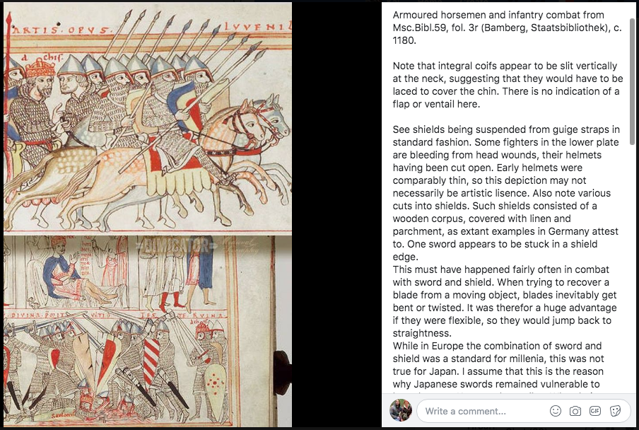

Screenshot'd these from Dimicator's Facebook page, so that the source and image are all together. I would argue that despite the apparent forward motion of people in both images (the duelists might me circling or stationary, but they are both adopting active stances), I would argue that the scabbards are offset, and while you can't see any details for the one with the duelist, the other scabbard could very well be offset with a split belt: One 'tongue' of the belt continues around to reconnect with the front, and one tongue drops down to interact with the scabbard, much like we see on later split suspensions for swords or strap dividers for earlier Migration Era/Viking Age swords.
Attachment: 767.4 KB
Possibly divided belt. [ Download ]
Attachment: 1022.78 KB
