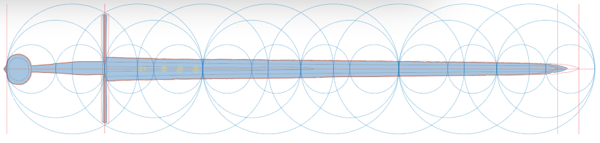

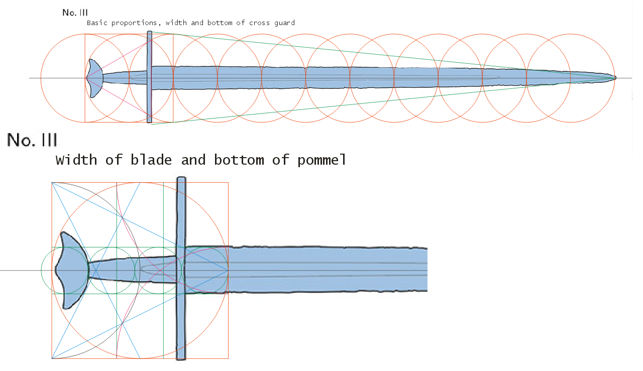

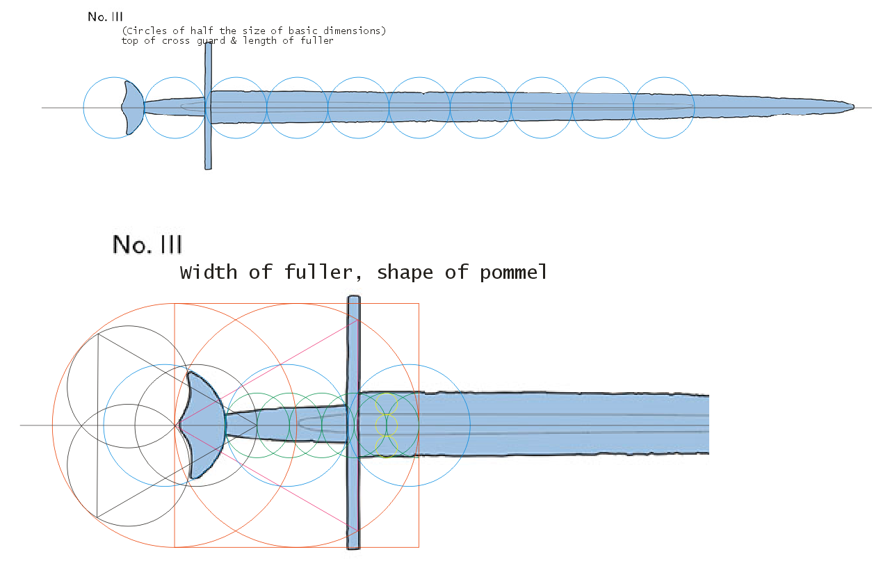

My attempt at figuring out the geometry of Peter's swords:
First up, sword Nr 3.:
I thought I set up the golden ratio, but I made a mistake and found the with of the blade.
The green circles are half the size of the blue circles.
 Attachment: 232.49 KB
 Attachment: 232.4 KB

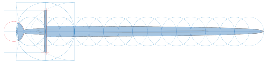

PostPosted: Sat 21 Jan, 2017 3:09 am    Post subject:         Reply with quote
With sword Nr 1. I was unable to find all the dimensions: I was unable to find the position and dimensions of the pommel and the width of the cross guard.
For sword Nr 2. I was also unable to find the position and dimensions of the pommel. I could find the curve of the cross-guard, but it felt like guesswork, so I left those lines out.
It looks like I may have gone wrong by including the peened end of the tang within the base geometry.
 Attachment: 259.54 KB
 Attachment: 270.4 KB

It is time to show the three test swords, me thinks.
But first a post that discuss some points that have been brought up on this thread a few times by different contributors. The geometry of the three swords will be posted in separate posts below. Or rather, the geometry of two of them, since the third was not based on any geometry or modular principles. I am devious that way.

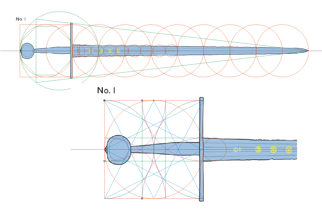

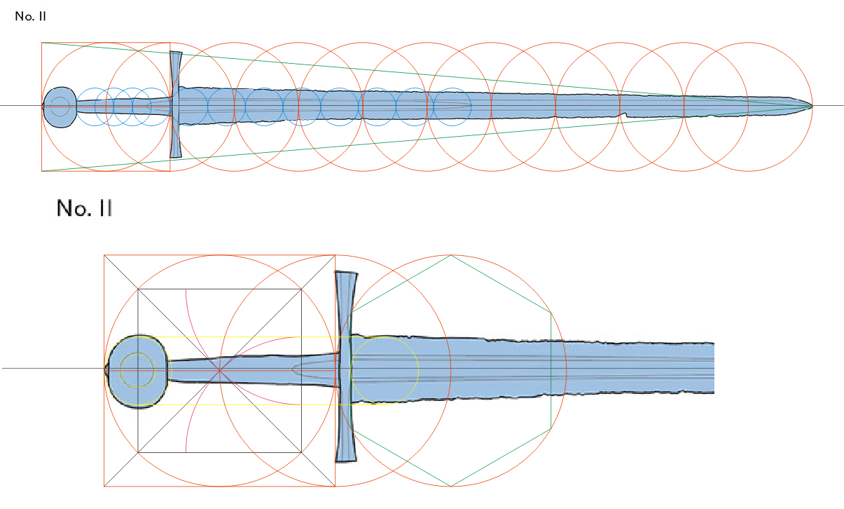

Sword #1 among the three experimental examples is the one that is not based on any geometric or modular design. The first clue to this is that it will not fit a layout of linked circles with the pommel and the point of the blade touching the periphery of the first and last circle.
The amount of "tweaking" you can do is the height of the guard: it can be paced so that its front or back edge touches a defining line or so that it hovers somewhere over this defining line.
I have shown all the different positions in the illustration with the minimum and maximum outlined in red.
 Attachment: 81.68 KB

PostPosted: Sat 04 Feb, 2017 10:23 am    Post subject:         Reply with quote
Sword #2 is based on a the II structure of 8 interlocked circles giving a 3:15 ratio between hilt and blade, with the guard placed in the vesica formed by the first and second circle.
The blade width is defined by two arcs that are tangent to a half circle drawn from the middle of the left side of the square. The tangent arcs cut the right hand side of the square according to the golden section. The same cut also defines the width of the pommel.
The height of the pommel and the width of the guard are both defined with the same geometric construction. One leg of the compass is placed in the middle of the vesica and the other leg is placed in the middle of the upper or lower side of the square. The arc that is drawn marks the base of the pommel A circle with its centre in the large circle and its periphery at the base of the pommel transfers the proportion and defines the width of the guard. If a rectangle is made that has the height of the square and the width of this circle, it will have the proportions of the golden section.
In this way, all the further details of the sword (apart from the basic 3:15 ratio of hilt to blade) are based on the principle of the golden section. However, you may note that the numbers 3 and 15 are both part of the fibonacci series of numbers that are used as a quick way to define the golden section (1, 1, 2, 3, 5, 8, 13, 21...). The golden section can be found by combining pairs of fibonacci numbers thus: 1/2, 2/3, 5/8, 8/13, 13/21 and so on. The higher numbers used, the closer to the actual value for the golden section you get (1.618.....).
 Attachment: 60.06 KB
Last edited by Peter Johnsson on Sat 04 Feb, 2017 10:36 am; edited 1 time in total

PostPosted: Sat 04 Feb, 2017 10:34 am    Post subject:         Reply with quote
Sword #3 is a classic example of a sword of a kind that often is defined by a type I geometric structure. In type I structures the guard is placed in the middle of the first circle and defines the hilt to blade ratio by adding a series of interlocked circles with a diameter that equals the radius of the first circle.
In this case the ratio of hilt to blade is 2:15.
The blade width and the height of the guard are defined by a pair of inscribed octagons in two of the small circles. The blade width is defined by the width of the side of the octagon, while the height of the guard is defined by the distance between the sides of the two octagons. These are two very common strategies used for swords of this time period.
The width of the guard and the base of the pommel are defined by a pair of diagonal arcs of the square.
The inner curvature of the pommel is defined by a circle that is constructed with the help of a square that is based on the width of the guard. This is another very common strategy that is valid for many other swords of this general type (brazil nut pommels and cocked hat pommels).
 Attachment: 53.1 KB
