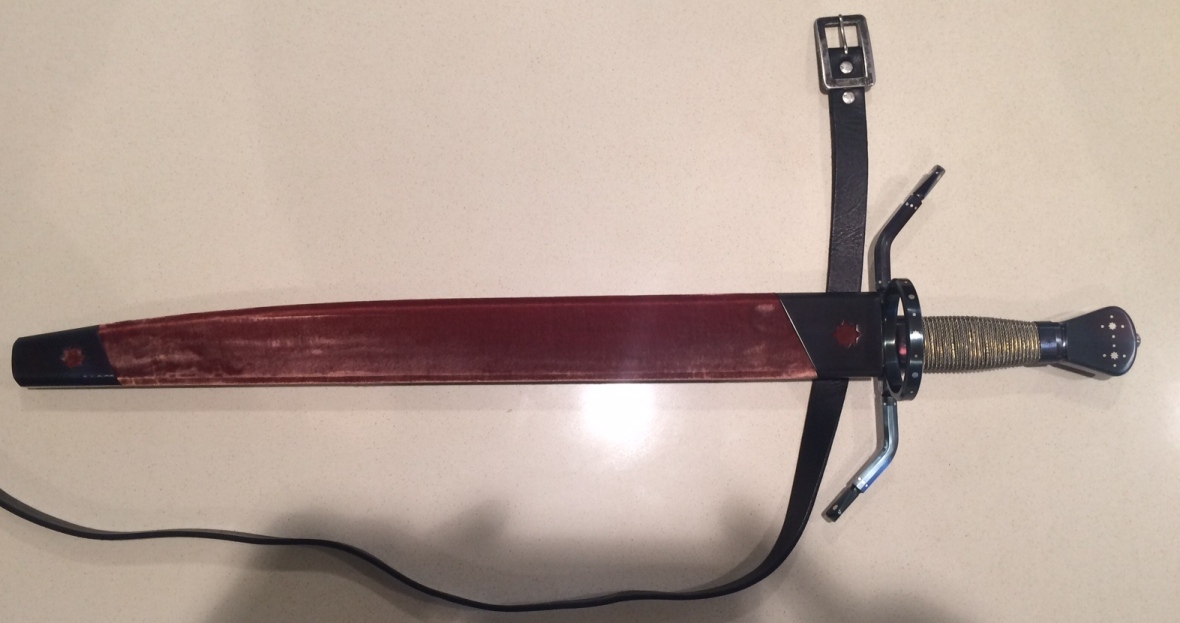

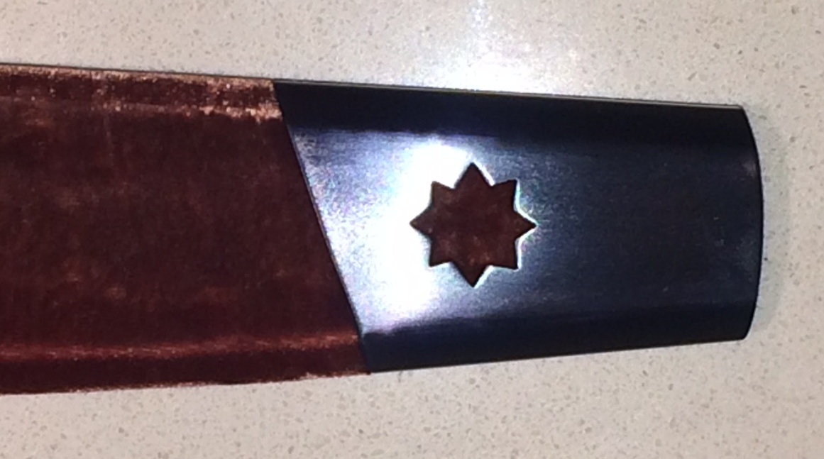

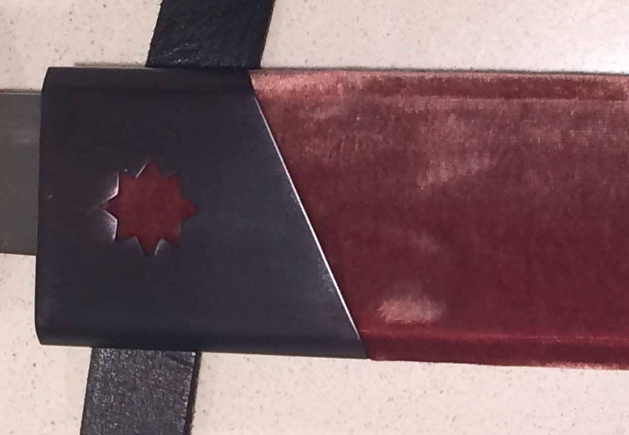

PostPosted: Tue 15 Nov, 2016 11:35 am    Post subject: The scabbard is done!         Reply with quote
Here it is, finally completed! Take a look at the attached pictures.
Alex.

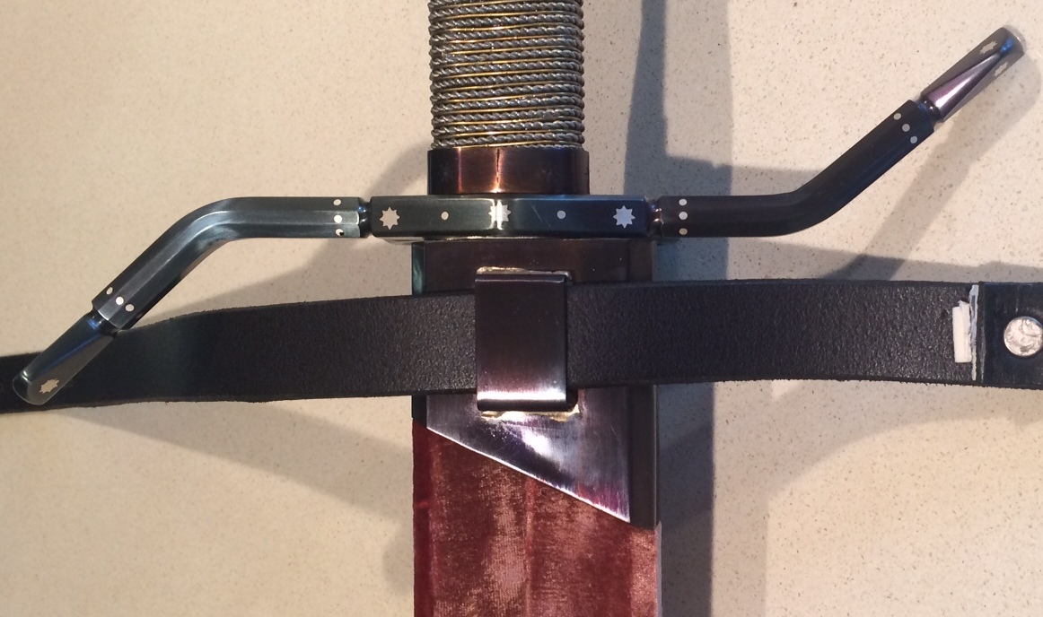

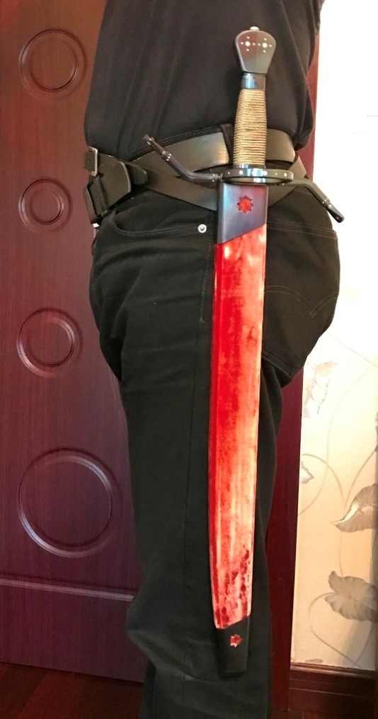

PostPosted: Tue 15 Nov, 2016 11:46 am    Post subject: more pictures         Reply with quote
Two more pictures: showing how the belt loop is attached (I decided not to bother too much with cleaning up solder joint, as it is on the back side), and how the whole package is worn on a narrow sword belt (sorry, no period clothes to match...).
 Attachment: 128.13 KB
 Attachment: 272.79 KB
