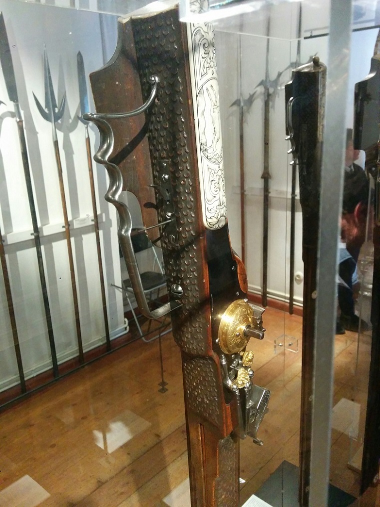

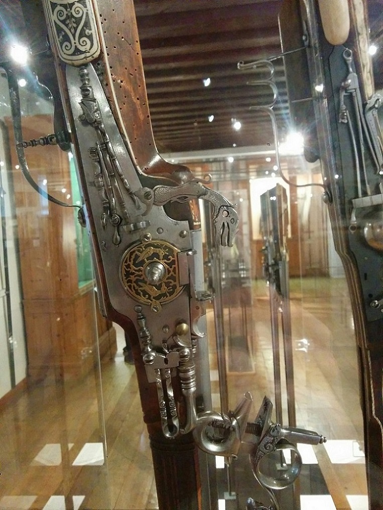

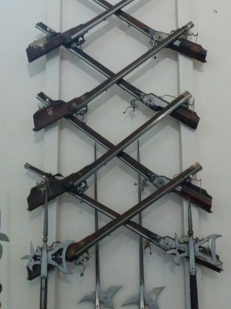

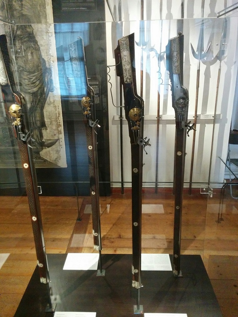

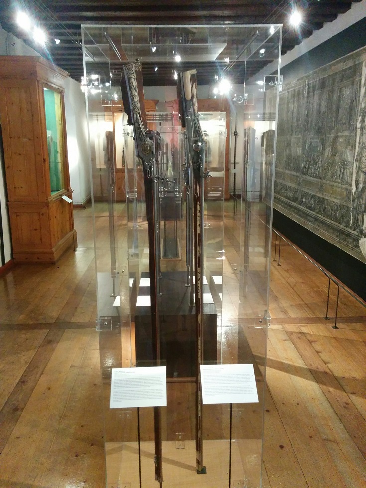

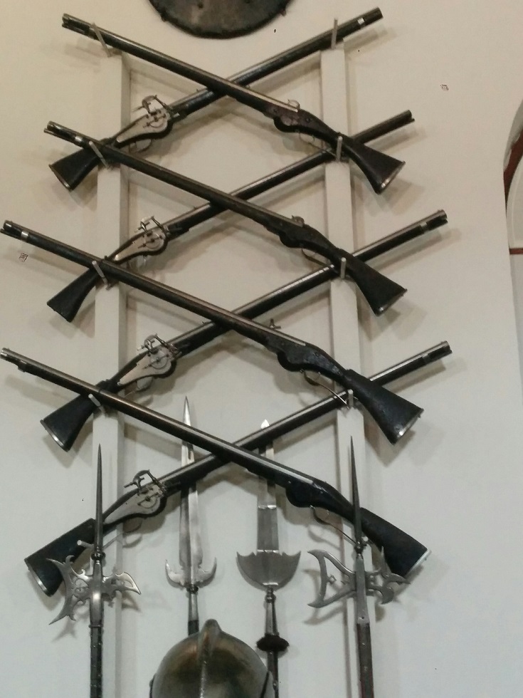

PostPosted: Sat 10 Sep, 2016 4:11 pm    Post subject:         Reply with quote
wheellocks for use on foot were very popular in the richer central european countries.
just not so much in a military context.
but every hunter/nobleman who could afford to, would try get himself a wheellock in the course of the later half of the 16th all through the 17th century.
in the collection of ambras, there are some very intriguing examples of civilian wheellocks of said timespan.
i`ll add some photos, i took in may this year. most of them are 1570ies-1580ies.
the military examples are smoothbore, the civilian hunting guns rifled.
also in a military context, wheellocks stayed very popular in central europe, for quite a long time.
i dont know why, i hear people saying, that the wheellock is more reliable than the early snaphaunce/flintlocks.
the austro-hungarian army introduced their last pattern of wheellock troopers pistol as late as 1704 for example.
 Attachment: 193.38 KB
military wheellocks of the 1590ies [ Download ]
 Attachment: 180.11 KB
military wheellocks of the early 1600ies [ Download ]
 Attachment: 266.5 KB
over 6 foot long hunting rifles of the 1570ies-80ies. ivory inlay [ Download ]
 Attachment: 278.68 KB
obiously they did not completely trust the reliability of the wheellock, so this one features a back-up matchlock [ Download ]
 Attachment: 259.52 KB
hunting rifle 1580ies with double set trigger [ Download ]
 Attachment: 265.55 KB
1580ies hunting rifles with double set triggers and v-notch back sights. simple post front sights. [ Download ]
