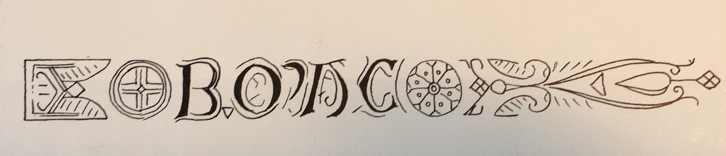

I do not believe that this is an original sword.
reason, the series of letters BOAC? on he cross and the angel wings in the blade are very much inspired on a sword in the Glasgow Museum, ROMS X.12
f/m the guard is an unusual place for an inscription
best,
jasper

I'm inclined to agree with Cornelis Tromp on the very real possibility that its faked - that cross is one of the "funny bits" I mentioned. But conversely, I'm not 100% convinced that it actually is an inscription on the cross. The photos, after all, are pretty abysmal, and tiny.
(and how can anyone get the white balance THAT far off in a photograph, I have no idea!)
I'm trying to arrange with the antiques dealer to get further information from them (and decent resolution photography, to work out if it really is text, or just a trick of the light) , but its been extremely slow going - their English is a bit lacking, and I'm having to pull favours off old university friends who are native speakers to get more information translated in the discussions.. Pretty much the only new information I have on it is a purported origin in Austria, and found in 2000. Which as a provenance, is about as convincing as my cat's "I've not be fed in years" expression...
If it is original, I very much doubt the 15th C. date its given - its an earlier style, in that regard, and closer to the mid-14th, I'd say. If it is an inlaid or engraved cross, that's a really big warning light against authenticity. To be honest, the bigger flashing light there is the engraving that appears to be on the blade - that sort of square boxy panel looks rather out of place for its date - and I'd just like to thank Cornelis, because it was bugging me where I'd seen that shape before, and it is glasgow museums' A.1987.31 - and if it is from there, well, an engraving style that's mid-12th century, on a mid-14th century falchion type might as well say "made in 2000".
Again, something I'm trying to get clearer reference pics of, in high-resolution. I'm not entirely struck by the pommel either. Its sort of an H1, but without any of the edge bevels I'd expect. Feels out of place.
One detail I'd be cautious of. All in combination is a lot of problems.
If I ever get more detail, I'll let people know here.

Very interesting element! This engraving seemed weird to me, as I never saw something alike on a 14th century falchion or sword. Is there a picture of the Glasgow ROMS X.12 somewhere?

JG Elmslie wrote: | I'm not 100% convinced that it actually is an inscription on the cross. . |
thanks, please see attached Collage.
best,
jasper
