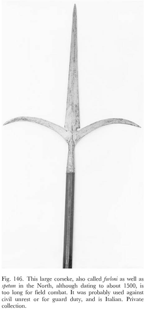

I think it would depend upon what threats the town guard was formed to handle. Town drunks and petty thieves would likely be handled with clubs or maces (functionally a club with extras), since cutting off limbs or having townspeople die from blood loss or infection has often been frowned-upon. (Note 19th and early 20th century law enforcement in USA and England). Maces, decorative morgensterns, and holy water sprinklers have often been used as a symbol of authority as well as being functional weapons.
If an uprising or armed groups of ruffians (gangs) were a possibility, we're now talking about armor and edged weapons. At times, "sword staves" or corseque might have been used, as well as common military weapons.
http://myArmoury.com/talk/viewtopic.php?t=1248
Image credit: Waldman's "Hafted Weapons in Medieval and Renaissance Europe......"
As previously mentioned, we can only speak to particular examples and speculate on the rest.
