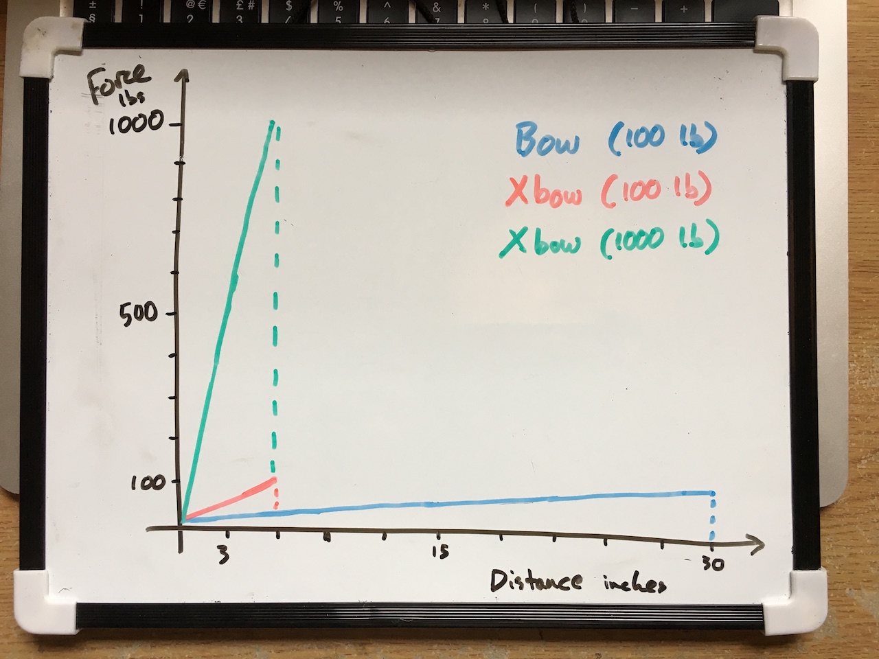

To explain this a bit: if you draw a graph of the 'draw-force curve' of a bow, the energy stored that is available for a projectile is the area under that curve (this can be proved mathematically). For modern compound bows you can make all sorts of exciting shapes, which mean that the calculations can be a bit difficult, but traditional bows are normally fairly simple. As you draw the bow, it will start at some low poundage, and slowly increase until it reaches the maximum poundage at full draw.
I've attached a quick graph I doodled, showing three potential missile weapons: a 100lb bow, a 100lb crossbow, and a 150lb crossbow. Let's quickly work through the basic maths:
Assume they all start at 0 lbs, and all the lines are straight. This means we can just use the formula for the area of a triangle to work out the power available in all three weapons, which is 1/2 * width * height
The 100lb crossbow (red) has a width of 6 inches and a height of 100lbs, meaning the overall energy is 300 inch-pounds - which is a silly unit, but we only really care how it relates to the other bows on the chart.
The 1000lb crossbow (green) is unsurprisingly much more powerful - with a width of 6 inches and a height of 1000lbs, the overall energy is 3000 inch-pounds. That's 10x as much energy as the 100lb crossbow, which fits exactly with what we'd expect.
Now for the 100lb bow (blue). This has a height of 100lbs again, but a width of 30 inches, and that makes the overall energy 1500 inch-pounds - 5x as much as the 100lb crossbow, but only half as much as the 1000lb crossbow. It's not any taller than the 100lb crossbow, but it is so much wider that it still can store a lot more energy.
In reality, of course, it's much more complicated than this: efficiency is a feature, and draw-force curves aren't as simple as the very artificial example I've provided. But the basic reasons why a bow can keep up with a crossbow should be clear.
Overall, most medieval war bows seem to have had pretty similar stored energies, whether they were crossbows or longbows. They basically represent two ways to get enough power from a missile weapon: either apply a moderate amount of force over a nice long distance, or apply much more force but over a very short distance.
 Attachment: 214.32 KB
Illustration of draw-force curves [ Download ]

PostPosted: Wed 12 Jul, 2017 9:13 am    Post subject:         Reply with quote
T. Kew wrote:
As noted above, it's not just draw weight but also draw length that matters.
tis leades me to a question that didnt occur to me, when we say a arablest crossbow is 1000 lb draw weight.. how is that calculated, is that 1000lb's at 6 inches or is it an attempt to draw 1000lb of bow 28 inches and realising its draw force is a lot less at such smaller distances?

PostPosted: Wed 12 Jul, 2017 10:57 am    Post subject:         Reply with quote
Typically* the quoted weight will be at full draw, whatever that distance is for the bow in question. So a 1000lb crossbow will be 1000lbs of force at six inches.
