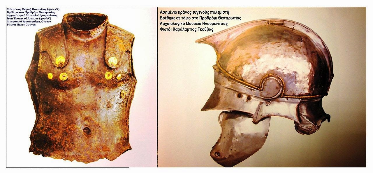

Okay, but again, how big is "big"? Iron helmets and even breastplates were being made in one piece as far back as the 4th century BC, though that far back they are for nobility and royalty, not production pieces. People keep talking about the inability to made "large" sheets or plates of iron, but no starting billet had to weigh more than 10 or 12 pounds even for a whole breastplate. And the ancients were obviously able to accomplish this, by hand. So we're back to the original question, why not a 2 or 3-pound helmet bowl in one piece? I'm still not convinced it was lack of technology or technical skill.

Here's the iron cuirass from Prodromi, 4th century BC. It must have been state of the art.
Matthew

wasn't there also a helmet with the cuirass?
I'd say this one belonged to some noble dude, with a decent amount of wealth. Has anyone ever thought of importing the sheet material for armour? Instead of producing it on your own? Like from china? I heard something about chinese craftsman being able to cast steel in the 3rd century b.C.?

@Matthew Amt

There is a helmet currently displayed with the cuirass, at least in some of the photos online, but I don't know if it was actually found with it.
| Quote: |
| I'd say this one belonged to some noble dude, with a decent amount of wealth. |
Oh, yes! Expensive stuff.

Found the helmet.
