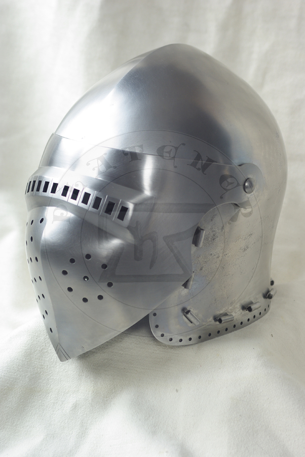

A quick question for re-enactment veterans: Would i be scorned from the re-enactment community if i wore a side-mounted klappviser inspired by medieval iconography? The reason for this question is that i have heard side mounted klappvisers are more durable in combat then single-hinge.

klappvisier = folding visor
By definition, you can't have a side-pivoting one. Not all side-pivoting visors are hundsgugel (hounds mask) in form.

PostPosted: Thu 10 Mar, 2016 4:28 pm    Post subject:         Reply with quote
If the visor pivots at the sides then it is not a klappvisier. But what is the problem? Since there is overlap between the two types of visor, both being used around 1370-80, with the side-pivoting visor continuing into the 15th century, you are OK to use the latter in re-enactment of that period. Have fun.
