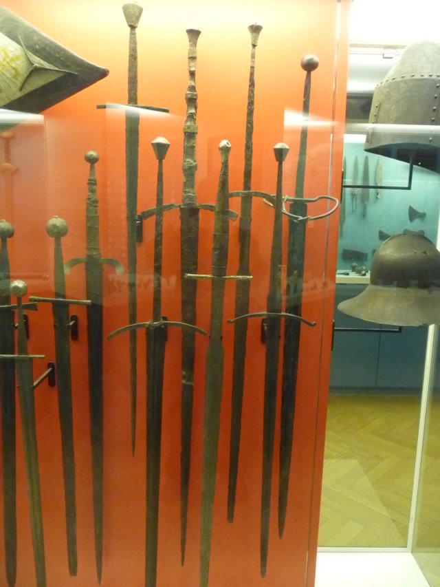

Neil Melville
Location: Scotland
Joined: 27 Oct 2009
Posts: 221
PostPosted: Mon 14 Dec, 2015 8:50 am    Post subject:         Reply with quote
Thanks Niels and Mark, I just love these long-hilted Scandinavian two-handers. I think the Soborg sword may be the one in the centre of the attached photos, taken in the National Museum, Copenhagen.
Neil

Neil, thanks for the images Wink - the one discussed must definitely be the Søborg Lake sword. (Shame you can't see the inventory numbers of the swords on the picture - but maybe they are not even display in the collection).
It is really massive in length - perhaps 150 cm?
Thanks for sharing! Several others in that display can be recognized in Hoffmeyer's plates I think. Speaking of which, here is plate 32 which shows two more long-gripped swords in Copenhagen:

I have figured out where the Sword D 1496 from Hoffmeyer's plate XXXVII sword a) added above by Mark is from:
This sword is from Slesvig and must be a find before 1864, when Slesvig was still Danish.
It is a mix of characteristics as it has a narrowed ricasso and a hexagonal pear-shaped pommel like a typical "XVIIIe", but has a cross-guard with "upturned" ends
This type of exact cross-guard is found on a grave-sword from "Øm Kloster", which doesn't have a narrowed ricasso though.
Sadly Nymark (1980) only mention the Slesvig sword in passing and doesn't add it to her catalog as it is not a grave-sword.
But she mentions that the cross-guard of the Slesvig sword is shorter than the Øm sword - (Øm sword cross-guard given as 27 cm in her catalog).
So the D 1496 is perhaps an example of a sword with narrowed ricasso from (originally) Denmark, that is not a 2-hander but a hand-and-a-half sword like the sword mark showed from Mook in Belgium (just the Belgian had the U-shaped cross-guard).
It does have a shorter grip than the other swords shown with "narrowed ricasso".
NB: The sword just left of the pretzel-sword from Tude Å added by Neil seems to be a third sword of that type.
It is very like the Øm Sword, but has a different pommel, and while the pommel is identical to the Slesvig-sword (D 1496) it doesn't have a narrowed ricasso and has a very long grip while the D 1496 has a "fairly" short one.

Niels Just Rasmussen wrote:
the one discussed must definitely be the Søborg Lake sword. It is really massive in length - perhaps 150 cm?
For comparison, I think the sword to the immediate left of the Soborg sword is D4850 (Hoffmeyer, XXXV.d) which measures:
total: 151 cm
grip: 40.9 cm
cross: 26.5 cm
Measurements are from "Beiträge zur geschichte der schwertmarkierung" by Schmid et al, in Zeitschrift für Historische Waffenkunde, vol. VIII (1920).
https://archive.org/details/ZeitschriftFuerHistorischeWaffenkunde08

Fantastisch Zeitschrift Mark. (It is pictured on page 151 and with measurement (6a) on page 154).
(Its in a great article on sword inscriptions Cool )!
It must be a correct identification! The Skt. Hans sword was first found in 1922 and it is shorter (133 cm).
If the D4850 is 151 cm, it makes it the longest Danish sword so far!
The Søborg Lake sword could perhaps be even longer!
Mark Lewis
Joined: 19 Apr 2014
Posts: 382
PostPosted: Mon 14 Dec, 2015 3:07 pm    Post subject:         Reply with quote
After a bit of cross referencing, I think all the long-gripped swords in this display can be identified. For convenient future reference, from right to left:
D 13492, Tudeå - http://myArmoury.com/talk/viewtopic.php?p=298679#298679
D 1496, Slesvig By - Hoffmeyer, XXXVII.a. The cross appears to be loose, and slipped forward over the ricasso
D 11695, Sorø Sø - Hoffmeyer, XXXVI.b
D 16140, Fiil Sø - Hoffmeyer, XXXVII.b
D 8804, Søborg - Hoffmeyer, XXXV.e
D 4850, Helsingør - Hoffmeyer, XXXV.d. Schmid, 6a
D 358, Sperring Sø - Hoffmeyer, XXX.b. http://myArmoury.com/talk/viewtopic.php?t=32523&highlight=
D 4446, Hinge Sø - Hoffmeyer, XXXVIII.a
Additional two-handers are shown in Hoffmeyer, plate XXXVIII. D9106 in (d) appears to be the same as one illustrated in Niels' other thread: http://myArmoury.com/talk/viewtopic.php?p=298757#298757
D 1496? - Hoffmeyer, XXXVII.a. The cross appears to be loose, and slipped forward over the ricasso
D 11.695 - Hoffmeyer, XXXVI.b
D 16140 - Hoffmeyer, XXXVII.b
D 8804, Soborg Lake - Hoffmeyer, XXXV.e
D 358 - Hoffmeyer, XXX.b
D 4446 - Hoffmeyer, XXXVIII.a
You are right Mark.
The second sword is likely D 1496 where the cross-guard has slipped down, so it looks like it has a much longer grip.
The last sword you mention D4446 is one of the Hinge Sø swords - it still has some of the wooden grip preserved and has a "C-guard" and I have posted a good illustration of the D 4445 sword on the "pretzel" forum and a close-up of the D 4446 sword's hilt.
So the b)-sword on Bruhn-Hoffmeyers Plate XXXV is of unknown origin and find-spot.
The D 11.695 sword is probably a typo in Bruhn-Hoffmeyer's book - should be D 11695 (?).
Yes the sword shown by Worsaae (1859) is definitely D 9106 in the center (illustration number 579 in the book).
