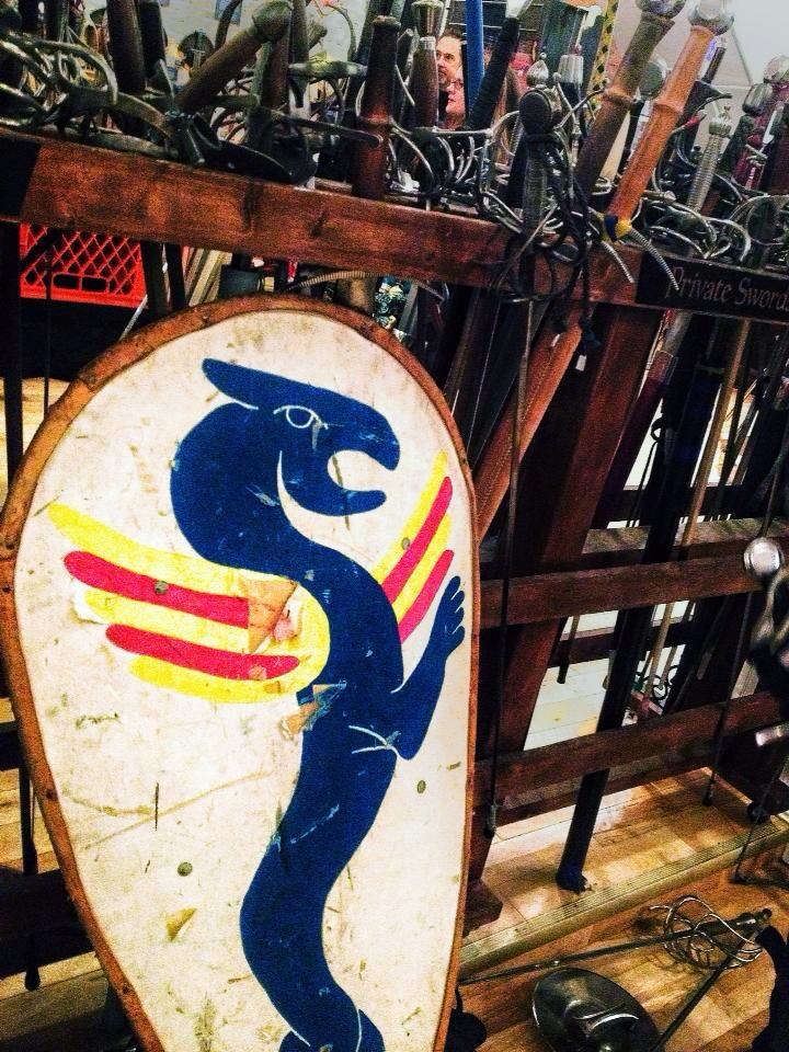

Yes, it is very hard to pull useful information from MS I.33. Bucklers are just too small to get a feel for what it is like to fight around a large kite shield.
I've been doing WMA for some years and have to say that the best way to see what you can do, is to make a kite shield (or reasonable facsimile) and start swinging a sword around it. You quickly find out 3 things:
1. The shield is a weapon to use offensively, not something you hide behind.
2. Hold it away from you, or it blocks a great deal of your vision.
3. It's damn heavy! Kill your opponent ASAP before you get tired Wink
