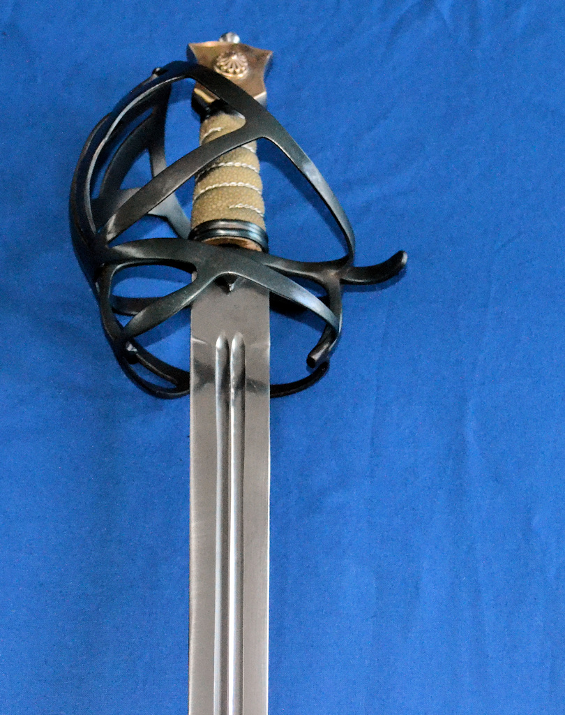

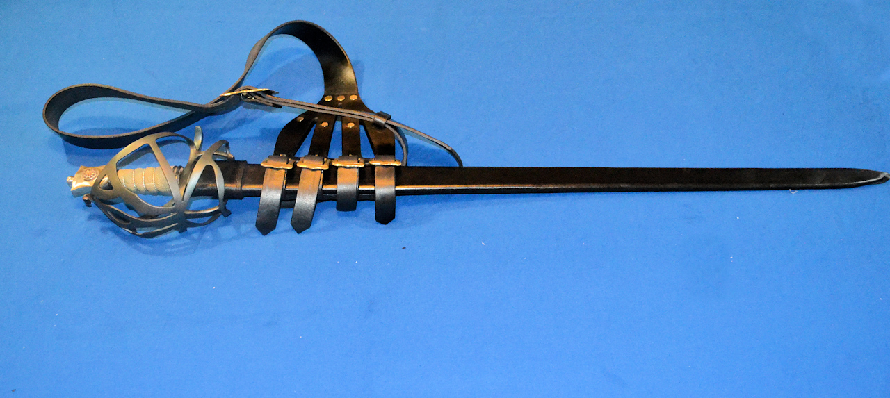

Modern reproduction of an early shiavona sword, made by Armour Class in Scotland. Blued hilt and sharkskin grip. Lenticular broadsword bladewith two short fullers. Purchased with a scabbard and rapier style baldric. 7- 8 month delivery. Iain at Armour Class always responded quickly and courteously to any of my queries.
Fit and finish

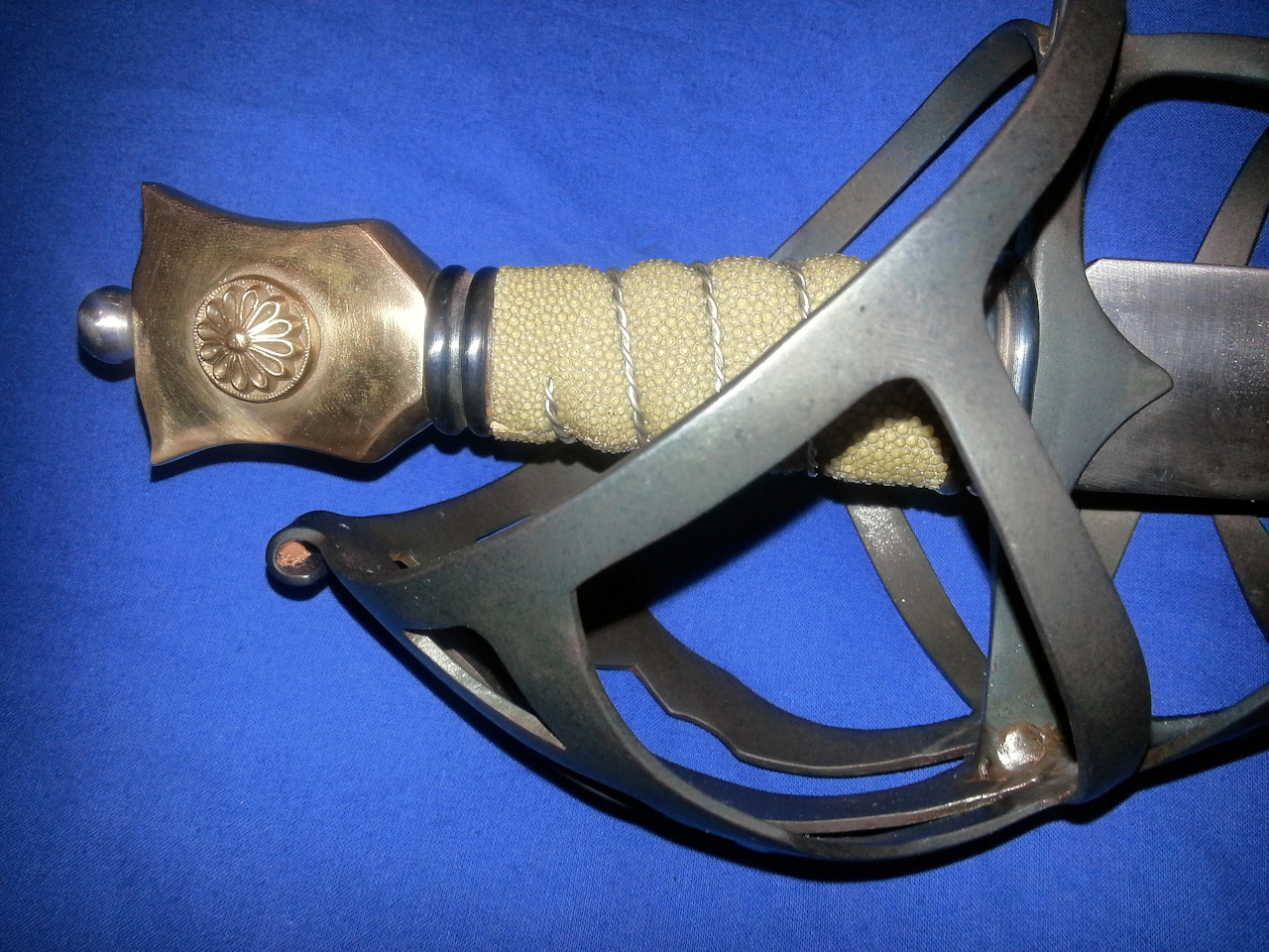

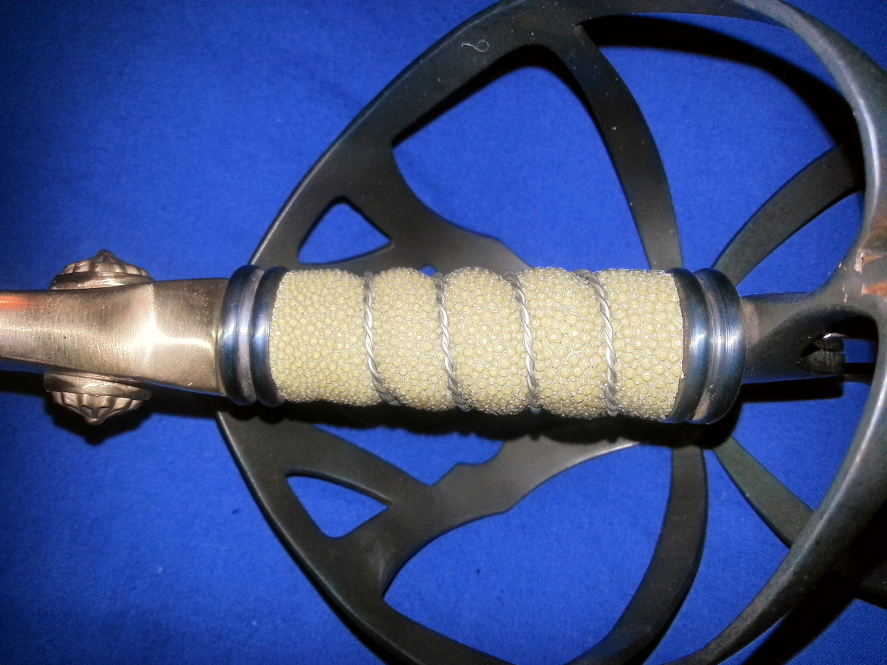

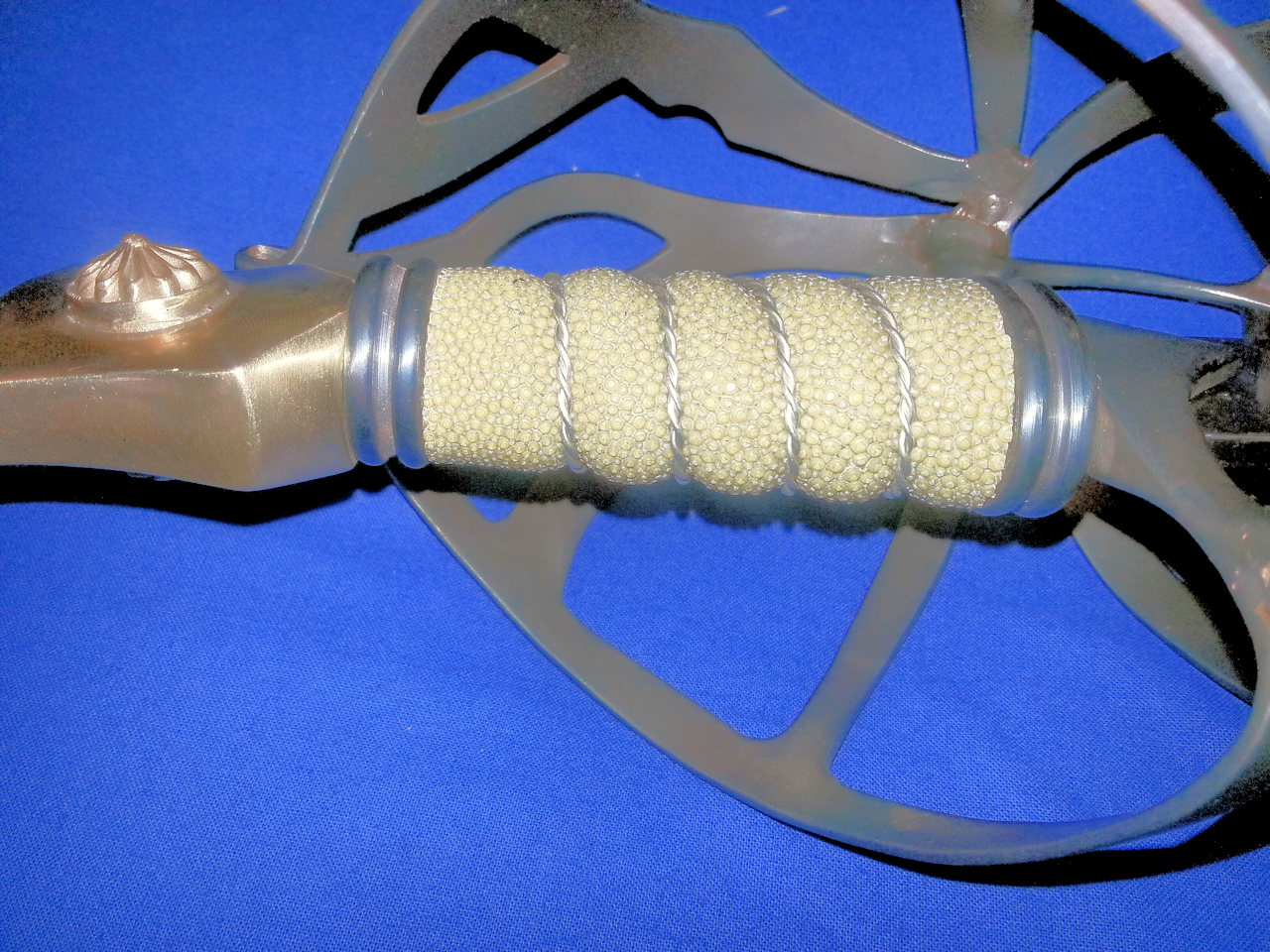

Well put together with a solid feel. The standard blued hilt is rather more matt grey than blue, but is evenly done and gives a pleasing appearance. The oval tapered grip is covered in shagreen (ray skin) bound with silvered wire, The sword is comfortable to hold and seems to suit a grip using the forefinger looped over the crossguard. The cat's head pommel is in brass with a steel peen button. The pommel has nice decorative brass rosettes applied to each face. The blade is a flexible broadsword type with twin short fullers that look to have been hammered in, not milled. Satin finish to the blade which has been sharpened with barely a trace of a secondary bevel. I don;t know if all broadsword blades are created equal but this one has a very Scottish feel to it... not surprising really :D . A fair degree of profile taper for a broadsword with very slight distal taper.

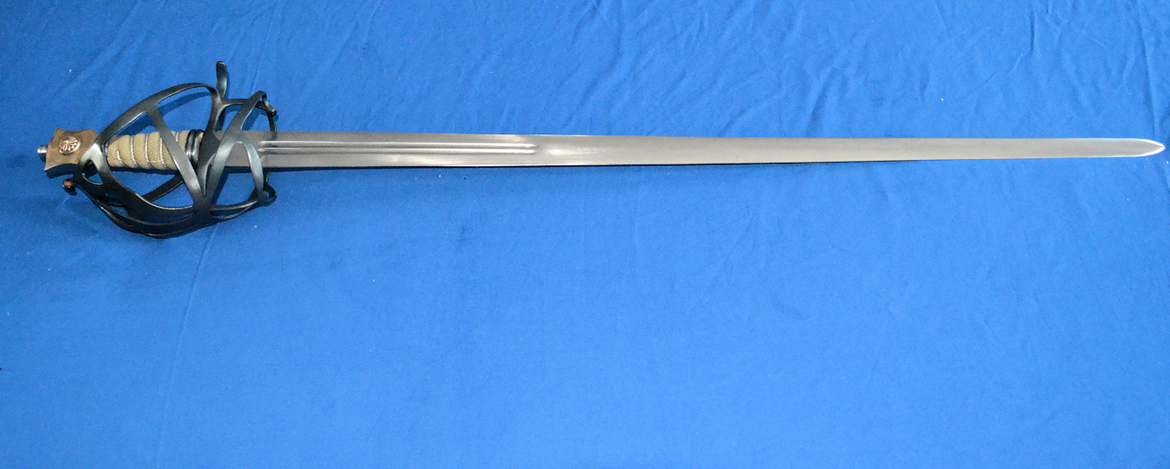

Weight, sword: 2lb 5oz(1.04kg)
Length overall: 39'' (99cm) Blade:33''(84cm)
Basketlength:7'' (18cm)
Basketwidth:4.75'' (12cm)
Basketdepth:2.75'' (7cm), measured from centre of grip to deepest part of basket.
Griplength:3.5'' (9cm), 5.75'' (14.5cm) including pommel and tang peen button
POB: 3.5'' (9cm) from cross piece1.5'' (4cm) from from front of the complex hilt.
COP: 21''(54cm) from cross piece.
Profile taper: 1.4''(35.5mm) at ricasso, 1.03'' (26.3mm) mid blade, 0.79''(20.2mm) 2 inches from tip.
Distal taper 0.17'' (4.3mm) at ricasso, 0.13'' (3.3mm) at mid blade, 0.11''(2.9mm) 2 inches from tip.

Armour Class does not claim this as a museum quality reproduction of an actual shiavona and it should not be judged as such but there are a few comments I would like to make. The baskethilt on this sword is symetrical but all the shiavona I have seen have an asymmetrical arrangement of bars in the hilt with rather more complexity on the outer side. I have seen one or two poor quality pictures that may indicate a more symmetrical arrangement and would be interested to hear of any examples forum members may know of. The basket is quite large and again most historical examples show a tighter fit to the hand. I know that many modern made swords have larger grips to suit the supposedly larger modern hand. I don't think this hilt is outrageous but certainly on the roomier side and spacious enough for my gauntleted hand, When viewed in profile the back bars of the basket show a concave aspect. Again most historical schiavona seem to have a more convex arrangement, however I have seen a small number of straight or even concave ones so I do not think this constitutes an ahystorical feature.
Conclusions
A good value sword for the money. Well constructed and finished. The sword feels light and agile, slightly more cut than thrust. Some may think the blade a little too thin but I like its feel and will always go for a more flexible blade over some modern made crowbars. There are some concessions to historical accuracy but I am very happy to add this to my collection as a well made example of a more uncommon sword type.
