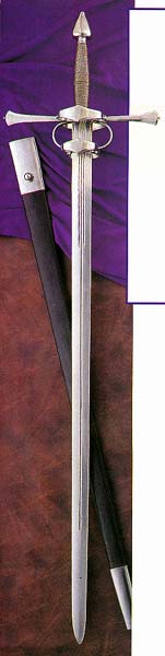

Looking at the two photos stacked above, you can see very little in common with these two weapons.

Rod;
There is also this one from MRL, though I have yet to hold it, and heck, it might be discontinued by now since I only found it in the Silvermane listing: http://www.silvermane.com/swords_broad-sword-double-ring.html I was thinking of getting one myself for some time, as it seems to have most of the qualities I'm looking for in a good horseman's sword. It's got a 36" blade and a reasonably complex hilt, and without a knuckle-guard you can still grab it with a mitten gauntlet if you so desire. I would love to know if anyone has any experience with this particular model, and know if it's still available.
The catalogue states that it's 46" overall, with a 36" blade 1" at the base, and weighs in at a hefty 3.6 pounds, and goes for $275 (at least the page I have bookmarked does, might have been changed at some point recently, who knows. But it's somewhere to start, at least.)
Good luck in your search!
Gordon
 Attachment: 16.63 KB
