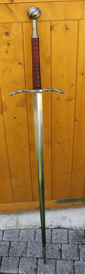

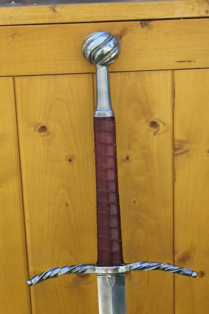

As is apparent from the specs, the sword is definitely on the heavy side. This is in no small part due to the pommel's tremendous size and weight, which acts as a curse, but also a blessing to the sword. The very backwards center of gravity makes the sword flow through the motions of solo and partner drills marvelously, and the long handle offers plenty of leverage to accurately maneuver the blade. It obviously features very little distal taper, which from my understanding is not all that uncommon on a blade that fits the Type XVIIIb. Its blade has a diamond shaped cross-section and features a prominent profile taper, mimicking a rather thrust-centric blade form.
These factors are a good thing for controlled practice of techniques, as the blade does not easily move out of the way in a bind with the slight added benefit of providing a better workout as you're moving more mass.
The problem, however, lies in its lacking thrust-safety. The blade is extremely rigid and will not easily bend when giving point, making it unsuitable for free rough-and-tumble sparring if thrusts are allowed.

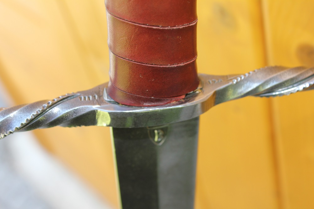

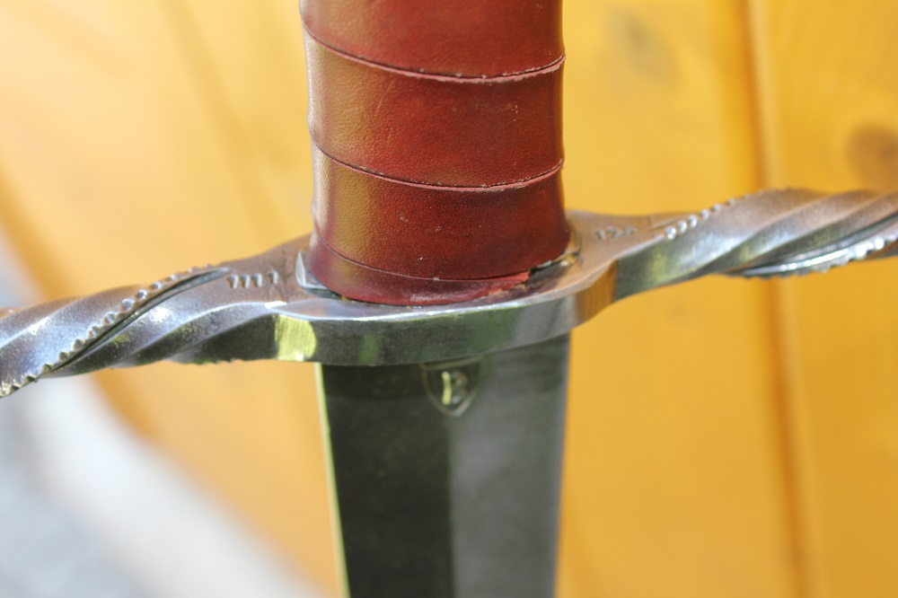

The sword is finished pretty well, with the sword having a polish on the verge between matte and shining. It's worn off a little due to occasional use of scotchbrite pads to remove stains and dirt, making it a bit more matte than it used to be. All parts of the hilt are neatly constructed, with the larger grooves being machined and the small incisions and toothing being applied by hand. The many varieties of hilts are a staple of JINO/Benešov swords.
Fit is a bit hit and miss, but overall definitely solid. Initially everything fit very snug and nothing had any play whatsoever. In time, though the pommel loosened a tiny bit, so that it now rattles audibly when the sword is struck or hits an object. Not a critical error, but still a flaw worth mentioning. I could probably fix it with a few solid strikes on the peen, but I won't risk breaking anything if it's still in working order. The blade's center ridge is also not perfectly straight and not perfectly centered, which is not apparent at first glance.

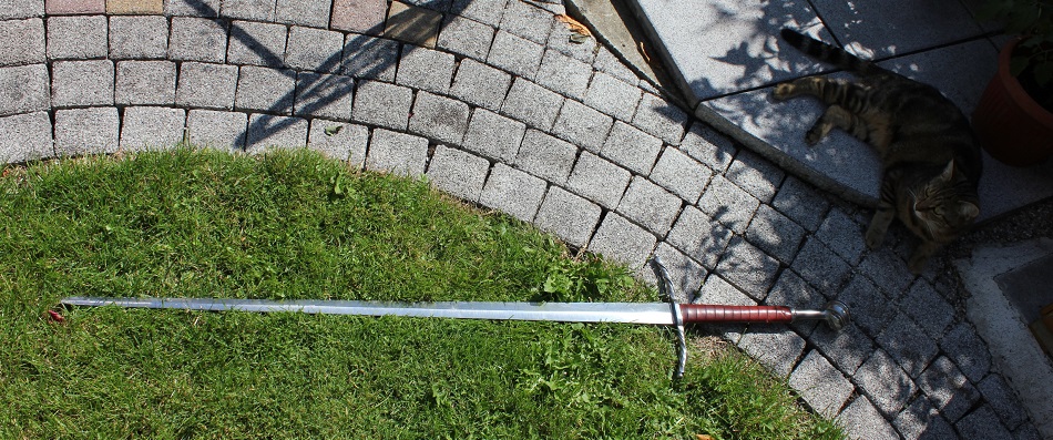

Attachment: 269.28 KB
Cat for scale. [ Download ]

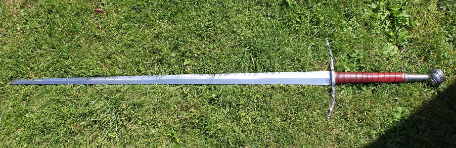

Attachment: 241.21 KB
Total [ Download ]
Attachment: 122.12 KB
Total 2 [ Download ]
Attachment: 199.66 KB
Hilt [ Download ]
Attachment: 114.25 KB
Crossguard Assembly [ Download ]
