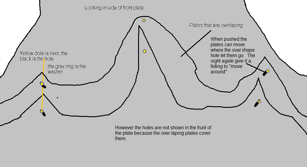

Yea that is what I mean everything moves on the armor, I think even the upper chest can move a little. Each plate in it can move around but just a little a bit, the faulds moves the most. The way it can move "around" is placing the slight skinny oval shaped holes of the rivet a bit sideways or in a slight angle. This armor is amazing!
I will have a real pitcher of the inside of my plate soon so I can show you what I am talking about.
Let me show a crappy picture I made for everyone to get a better idea what I am trying to say.
This is the in side look at the upper part of the German Gothic plate armor of what I have. (the link below) Is it historically accurate?
Attachment: 42.47 KB

Google up "sliding rivets." It's a perfectly normal feature in 15th-century armour. Your breastplate might have more of them than what would have been typical for its time, but not to the extent of being unrealistic or ahistorical.

Lafayette C Curtis wrote: | Google up "sliding rivets." It's a perfectly normal feature in 15th-century armour. Your breastplate might have more of them than what would have been typical for its time, but not to the extent of being unrealistic or ahistorical. |
Thanks! That is what I was looking for, if it is a fact and as well as the name or term of it. I will start to look it up..

Posted: Thu 07 May, 2015 10:27 am Post subject: In insde |
Here is what I been talking about.
Attachment: 31.27 KB
