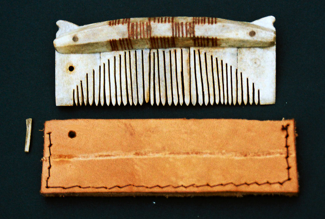

Here are a few examples of reconstructed bone-work from the roman and germanic iron-age...
but we also can discuss wood-work, and non weapon-related iron-work.
 Attachment: 65.96 KB
Comb made from antler, found in Illerup Ådal, Denmark, 200 A.D.

do you have a technique for cutting the teeth straight and even on your combs?
yes, I start with drawing thin lines with a pencil to be oriented while sawing, the I fix the comb at the edge of my table so that the later teeth are pointing towards me and reaching over the edge of the table so that there is nothing below the teeth-plates than air Wink (hope I expressed it good enough). Then I carefully start sawing from left to right (as right-handed, if left handed, do it from right to left). So you can assure that you see where to do the next cut. Saw quick enough to make sure your saw does not struck cause this could easily damage the thin fresh sawed tooth. When sawing the next tooth support the last one with your left hand thumb a bit, so it won´t brake... It is necessary, that the teeth-plates ar cut in the natural growing direction of the material (just like it was, if you were cutting thin wood-plates) otherwise they will break immediately.
It is a matter of experience and skill....try first on an unfinished comb-plate, to exercise! If you damage a teeth on a nearly finished comb, you could cry. Use a saw for fine metal cutting and use wax on the saw-blade to make it slip easier through the material and not strucks. Fix the comb in a clamp with wooden packets not to damage the material. Dont stop sawing until all teeth are sawn (so you make sure not to change your position once a good is found).
When finished sawing, take a thin and about 8 inch long fine sand-paper, fold it and fine trim the teeth. When finished it, polish the teeth with a thin but rough paper, after you had softened the comb by putting it into hand-warm water for about 5 minutes....With this warm-water method and a very dry terry towel you can polish the whole comb at the end of the finishing process.
Least: Don´t cry when your first try looks crappy! My first one looked like this:

PostPosted: Sun 07 Feb, 2010 6:55 am    Post subject:         Reply with quote
thanks for the walkthrough, i have made one already, placed the comb in a vice teeth up, didn't breat any teeth but they are all quite wonky, i did use wax on the saws blade, the picture of your first comb hasn't come up. i didn't think mine was too bad, but i think i've got a way to go. well heres mine.
 Attachment: 203 KB
my first, (after many months of planning and deliberation!) [ Download ]

PostPosted: Sun 07 Feb, 2010 2:30 pm    Post subject:         Reply with quote
Jupppieh! Your first comb is great, much better than my first 4 or five! Could have been found in Haithabu exact this way. You´re well on your way to get it perfect and I believe the day is close! So I´m glad if this topic helped you over the hesitation! Happy
Just go between the teeth with a fine thin sand-paper and "file" them carefully thinner! Start between the 20th tooth seen from left and the 21st and sand the 20th tooth thinner until the little failure disappears. Take this tooth as measure for all the others and make them exact same thin, then you got it!!! And then use fine sand-paper to make a smooth finish to the whole comb and it´ll be absolute authentic. How long did it take? And: when will you try the next? Try the next with an etui! Let me see how you get better and better with each comb you make! And: never sell this comb! This will bring you luck! My first comb is still here...
The image of my first comb is the small one below the big one of the saw in the earlier post (I thought better make it not that big, hehehe).
But: When you see originals, you can see that they saw the combs horizontal, not up, if you do so, you can control the straitness of the cuts much better and: you will get a v-shaped end of the cut if you saw the teeth, than turn the comb to the other side and saw the last milimeter on this side....the v-shape at the end of the cuts makes the teeth more stabil...
Great job!
EDIT I recognized your comb is riveted between the teeth-plates! Know what? This is exactly the way the old did it more than a thousand years ago! So you did it the correct and authentic way! The reason why I did not is: I am too afraid it won´t be stabil, but I know thats not true. But I continue riveting them in the middle of each plate..
Did you have an image of an original as a model?
