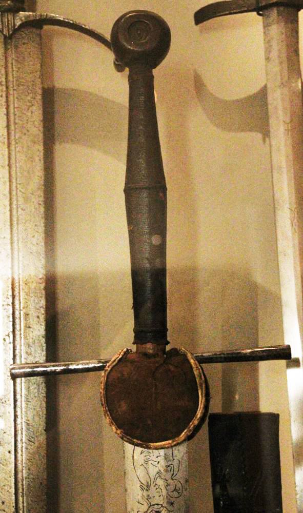

PostPosted: Wed 27 Jun, 2018 9:52 am    Post subject:         Reply with quote
This is one of my reference images.
