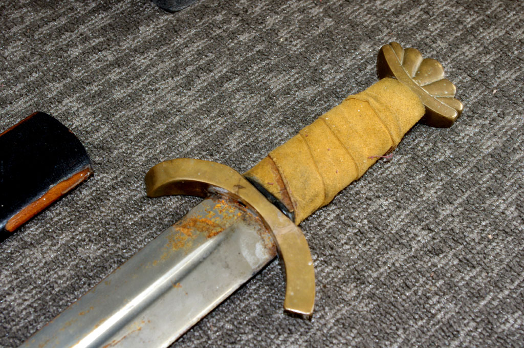

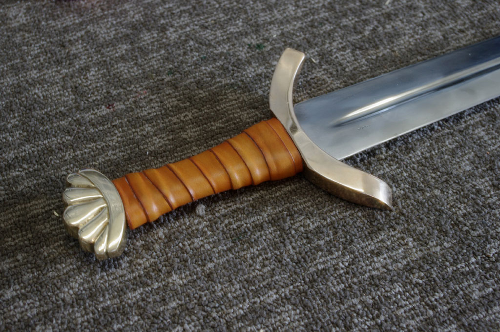

| Greg Ballantyne wrote: |
| Not sure the blade deserves the scabbard........ |
