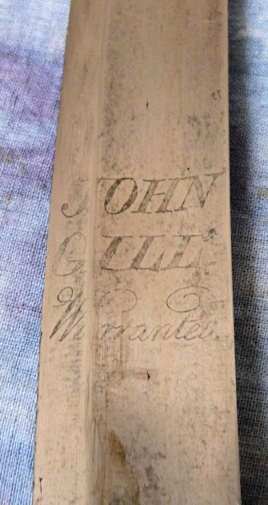

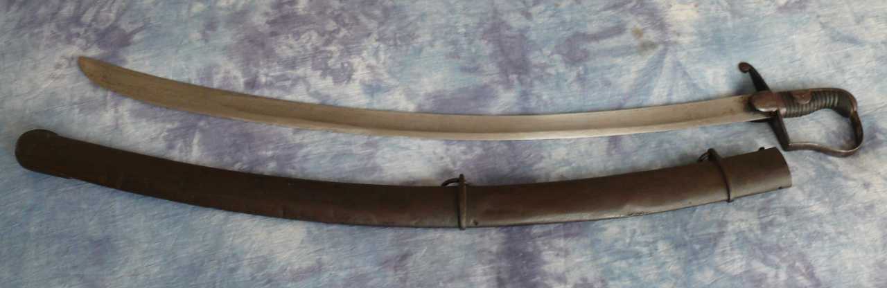

If it helps here are the details for my John Gill 1796.
Weight, sword: 2lb 1oz (0.93kg), with scabbard 4lb 1oz (1.83 kg)
Length overall: 37.5'' (95cm) Blade only: 32.5'' (82.5cm)
POB:7'' (18cm)
Profile taper: 1.36'' (34.7mm) at ricasso, 0.15'' (3.8mm) at mid blade, 1.48'' (37.6mm) 2 inches from tip.
Distal taper : 0.33'' (8.5mm) at ricasso, 0.14'' (3.6mm) at mid blade, 0.07'' (1.9mm) 2 inches from tip.
Attachment: 104.47 KB
Attachment: 55.05 KB
