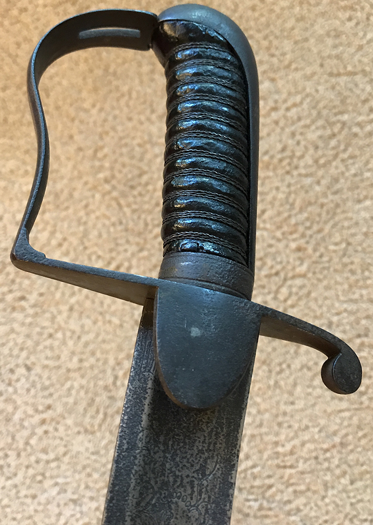

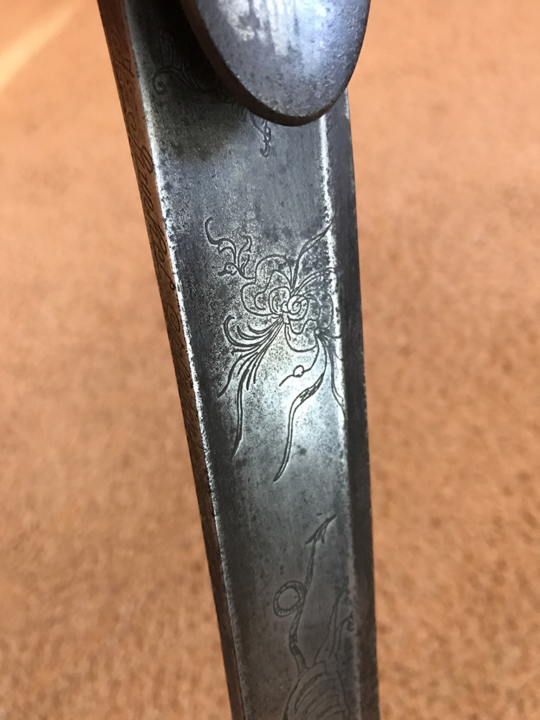

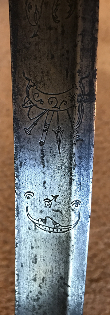

Hi all,
I'm new here because I just bought my first sword and I'm hoping someone can tell me if it's real or a fake/reproduction. And also if you have time, a few quick pointers about how you can tell.
Also, should I clean the blade? It's quite dark but I'm afraid to mess around with it. It almost looks like it has some dark material wiped onto it.
Thanks!
Scott[/img]
 Attachment: 460.95 KB
 Attachment: 590.19 KB
 Attachment: 522.27 KB
 Attachment: 654.07 KB
 Attachment: 565.97 KB
Glen A Cleeton
Location: Nipmuc USA
Posts: 1,978
PostPosted: Thu 18 Jan, 2018 4:24 am    Post subject:         Reply with quote
Welcome aboard Scott
It looks ok to me. The blade etching looks interesting. It is hard to tell what the covering might be. Sometimes varnish was used to preserve blades. You might try using acetone on the metal but if the coating is also on the leather, that can cause some issues. Use whatever solvent you use on a pot and let it soften the coating, then to be scrubbed off with copper, bronze or even fine steel wool. I use copper kitchen scrubbies and the blue plastic Scoth-brite looking thingies. removing whatever may be coating the grip may become problematic, proceed with utmost gentleness.
Some pictures of the overall in profile would be neat to see. What is the overall length (in a straight line) and how long is the blade?
Runkel, of Solingen, exported swords and bare blades to England and actually had an operation/sales there. You may want to cross post this over to http://www.swordforum.com/forums/forumdisplay...word-Forum as there are many British collectors over there.
GC

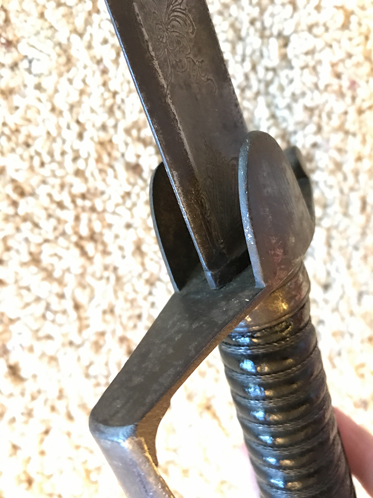

PostPosted: Thu 18 Jan, 2018 11:22 am    Post subject:         Reply with quote
Thanks, Glen! I'll try to find time to post a few more pictures and I need to do the measurements also. The blade etchings are quite intriguing and being so new to this, I don't know what to make of them. They seem strangely amateurish but highly symbolic. Are they put there after original purchase by the soldier?
I've attached 4 more pictures so you can see all of them.
 Attachment: 498.49 KB
 Attachment: 556.95 KB
 Attachment: 387.9 KB
 Attachment: 368.38 KB

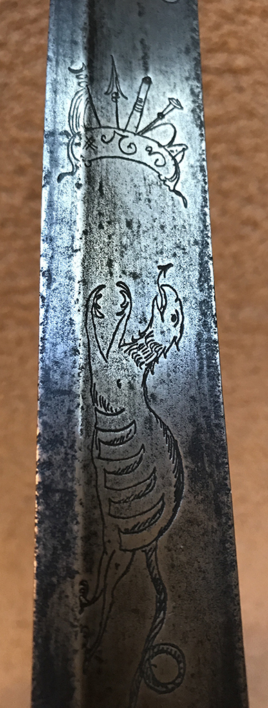

PostPosted: Sun 21 Jan, 2018 4:55 am    Post subject:         Reply with quote
You've got a stylized winged dragon along with the usual floral motifs: many of Runkel's blades in the early 1800s had this dragon - it seems like one of the decorative options that was available on his blades.
I used to own an 1803 pattern infantry officer's sword with exactly the same etched designs as your sword.
--ElJay
