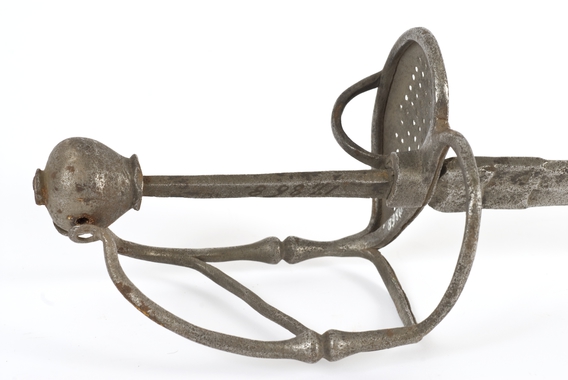

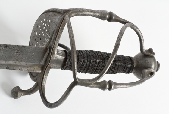

But I recently started looking in to it again. And I found this very nice norwegian museum page with a lot of swords tagged "schwedendegen".
Have a look at these: http://digitaltmuseum.no/search?query=schwedendegen&js=1'
Showing a lot of details, these for example. Showing two hilts missing one of the plates.
