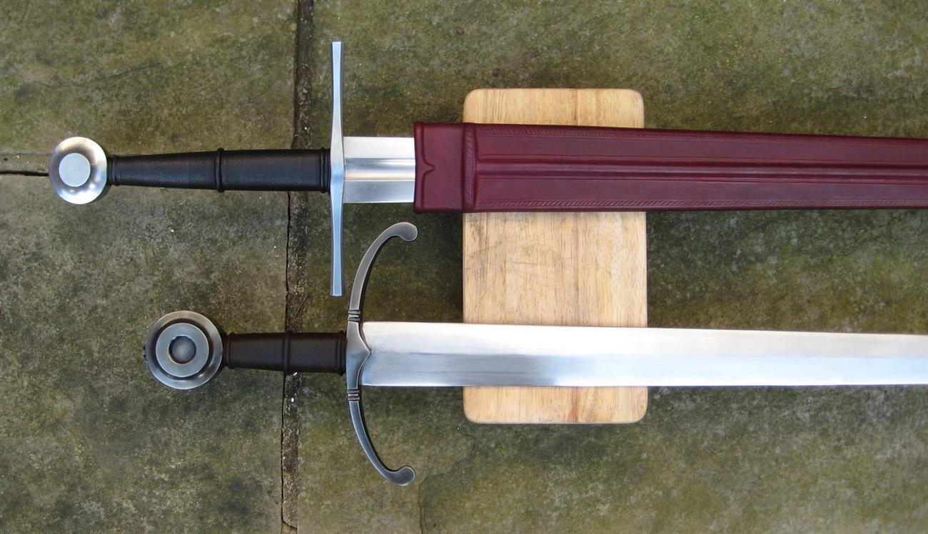

PostPosted: Sat 04 Apr, 2009 2:31 pm    Post subject:         Reply with quote
Couple of higher res pict alongside the Crecy in it's (still) unfinished scabbard.

Julien, good work there. Thinning the guard and grip have made a great improvement on the original and the bluing looks nice too, gives the sword an aged look.
Your grip rewrap is excellent; nice chocolate brown colour too. Cool
Looking forward to seeing the scabbard. Have you decided on what sort of suspension you are going to go with?

And what if it's not? Happy That's actually my second wrap, I did a windlass towton a while ago, using materials I thought to be appropriate at the time : epoxy glue (!?!) and chronium tanned leather (posted the result here: http://www.myArmoury.com/talk/viewtopic.php?t...t=towton).
I haven't decided about suspensions yet. This should be an early XV century scabbard, and that usually calls for metal shapes and mountings...the very thing that put my Crecy scabbard on hold for month now. I can't really re use the ones that came with the scabbard, because the leather will add too much thickness.
