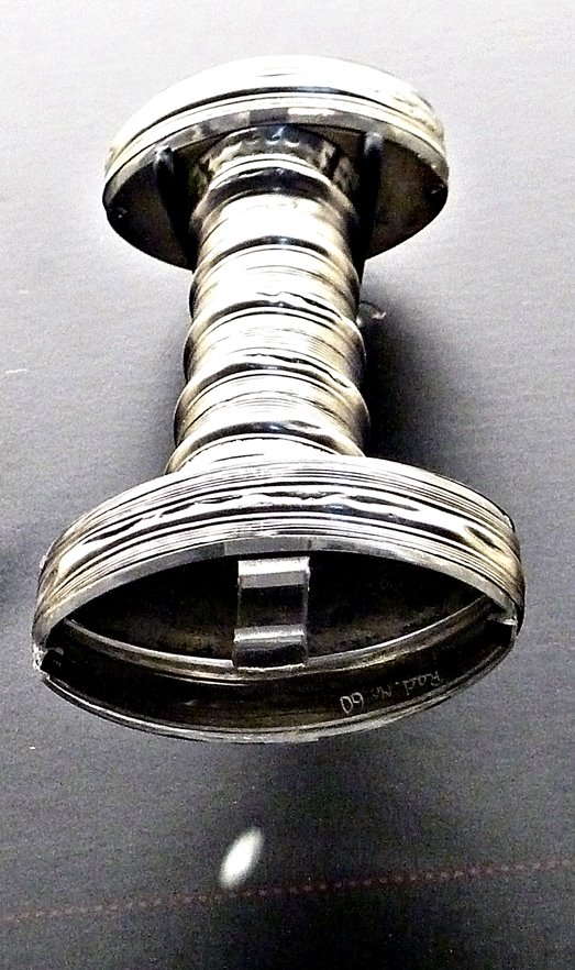

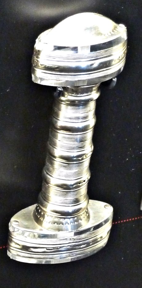

Thank you for this topic and the images. It has been a while since I thought about this style of blade and I think I will have to revisit the form at some point. It is vastly under represented and very beautiful.
Most of the texts that have these style of swords are not in English, and I am wondering about the hilt construction... It seems like foil/wire that has been formed over wood?
Michael,
That's right; thin contoured sheet, silver or bronze, formed over wooden grips and wooden upper and lower guards to create a complete covering (sometimes over peening blocks as well).
These images of one of the Nydam hilts shows the silver sheet and the hollow left inside:-
Attachment: 139.5 KB
Attachment: 99.31 KB
