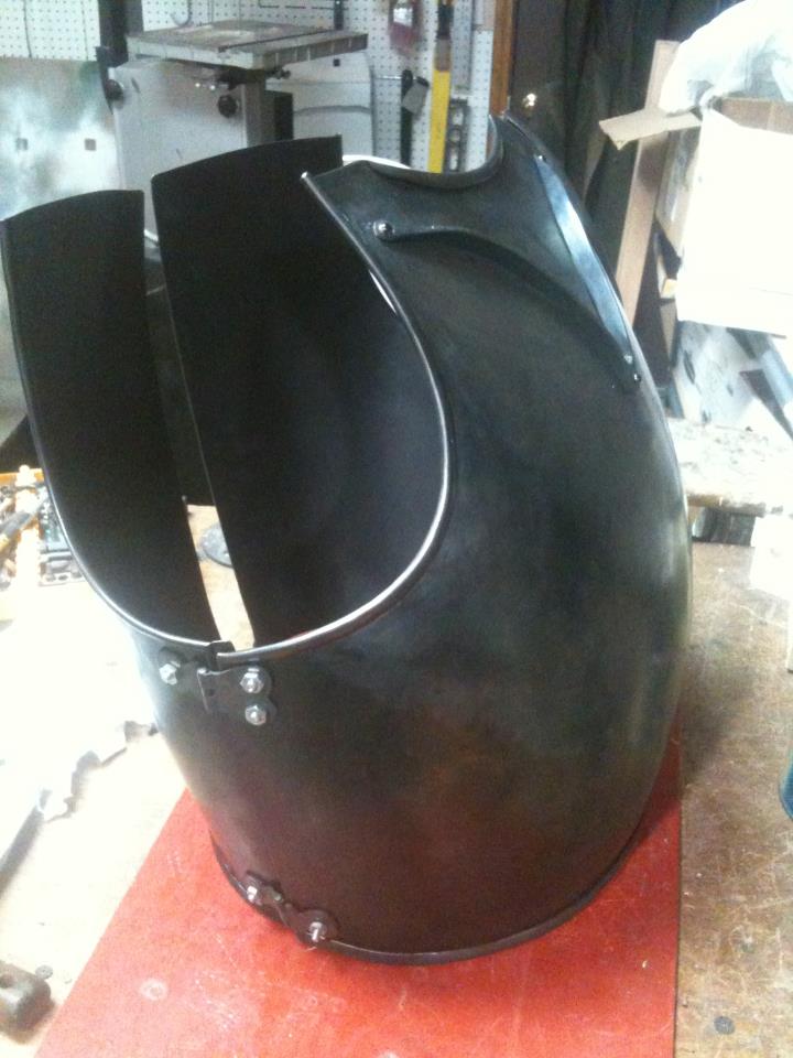

I imagine once the cuirass is attached the mail has little room to move around, but I'm curious once someone would thrust in the armpit and couch it like you see in the fight manuals, if it would then shift itself upward and "slip" out Worried
Or, would the cuirass having shaped correctly with the torso prevent any sort of "slipping"? I imagine I won't know until I try it out.
Mac, do you know of anyone that has tried out this short vest style of mail?
-Reece
 Attachment: 16.73 KB
Here is an Image from the Gladitoria fight manual.
 Attachment: 72.32 KB
Here is my early 15th century cuirass. It's nicely shaped and fit to my body type [ Download ]

PostPosted: Thu 02 May, 2013 4:25 am    Post subject:         Reply with quote
Think the modern guys fighting is Tournament of the Phoenix by the looks of the Hedgecock pollaxes. Cant identify the fighters though. Poss Arne Koets, maybe Toby? No idea what they were wearing, thought Dr Capwell was in a great bascinet....
Anyway, voiders simply need to be long enough and sewn /pointed on to stop that happening.
IMHO that is...
But Robert's suggestion re the vest is a good one. You could adapt a shirt easily for this and use it a bit like a padded arming partlet as suggested by various late 16th cent sources. That's a v nice picture, is he just back from a heavy bit of armoured work, or back from a serious drinking session?

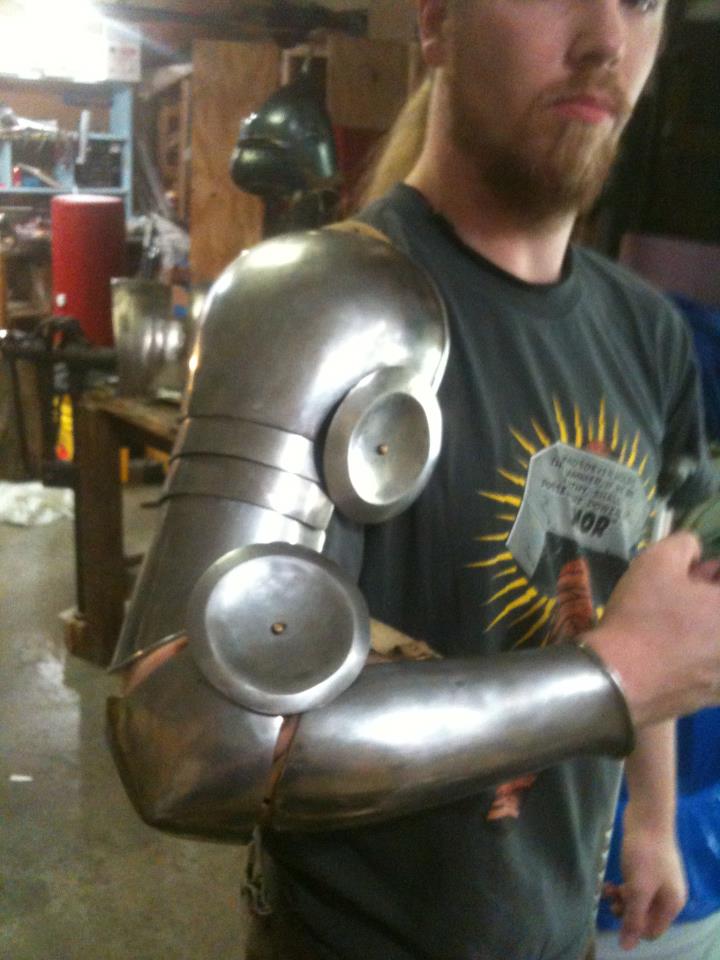

Here is my arm harness that I have. It's floating articulation and I have the vambrace and couter held by points in the doublet, then the spaulders overlap and are held by a strap.
Would this design get in the way with my arm harness?
I had thought about having my rear brace tie into the doublet to help it articulate better, so If doesn't work well with the current set up, I could try that maybe?
-Reece

Well, I guess it depends if your upper cannon is inseperable from the spaudler, that is, joined to it as part of a single assembly, in the late fourteenth-century manner. If yes, the Italian sleeve set-up isn't going to work for you, since the sleeves need to be worn over the upper cannons but under the shoulder defences.
If you were to wear the upper cannons seperately, then it should work for you.
