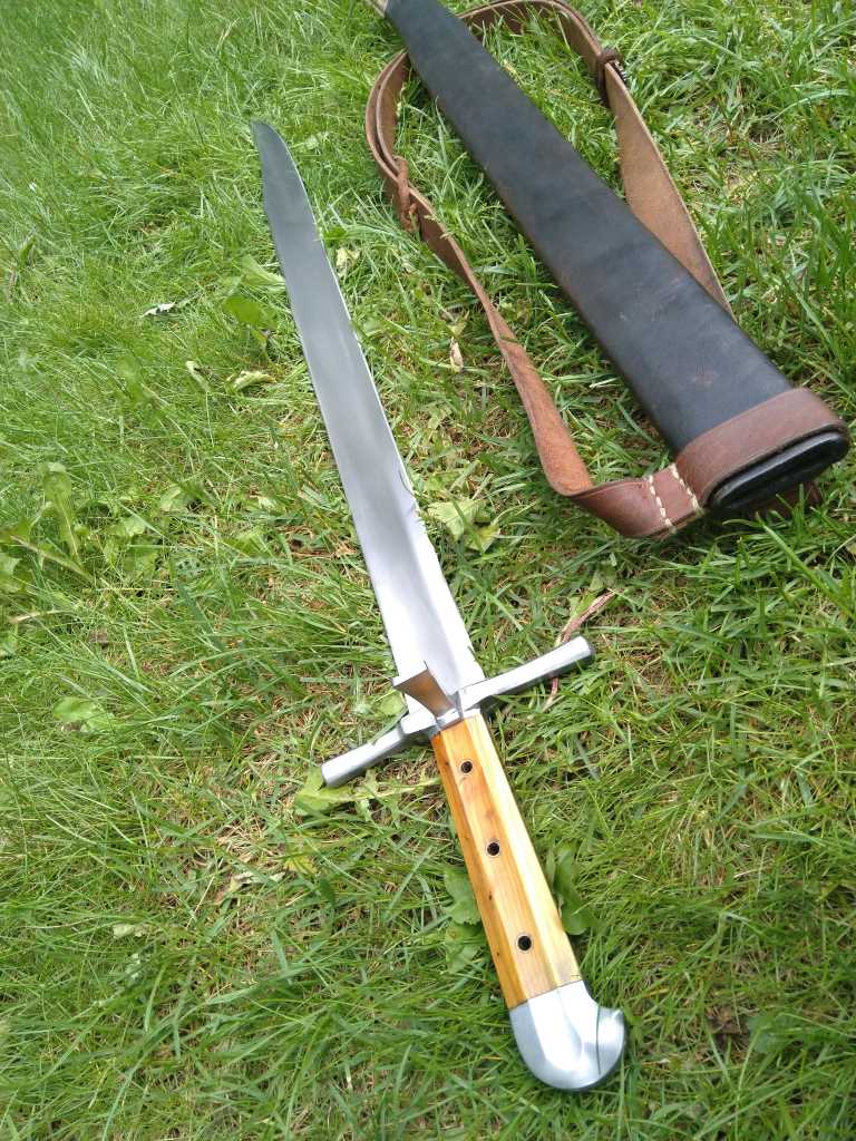

Messer: "Gottfried", Elmslie typology M3C with CC1 pommel.
A somewhat liberal interpretation of observed shapes, this exact shape is not something we find in a lot of artwork or extant originals. The Gottfried is a nice middle-ground, between the wide Günther and the slender Karl, and while it doesn't match any extant originals, it just looks and feels right.

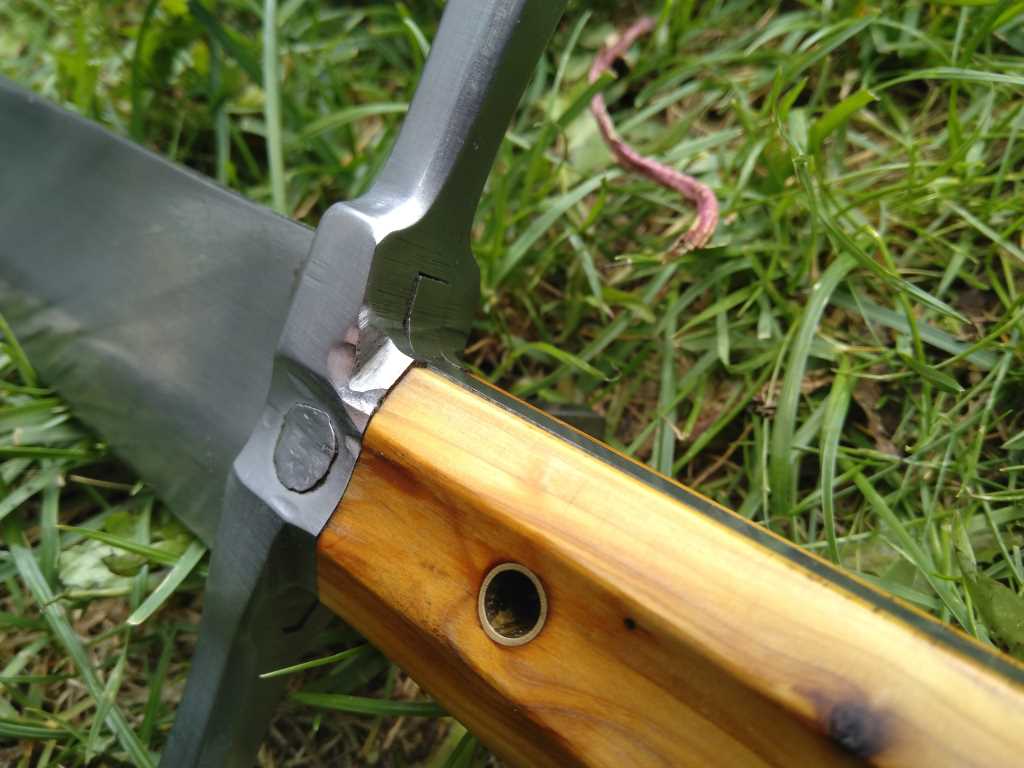

It has a similar level of finish as the blunt Gottfried had. A bit rough around the edges, not perfectly cleaned up. Most of the toolmarks fall within the realm of "as we would see on an original of similar quality" and are thus completely acceptable given the price range.
The metal and wood parts on the hilt meet up well, if not perfectly. The yew has a very nice colour and pattern to it. The hollow brass rivets are perfectly flush with the grip scales and don't bite. There are a few rough spots and edges around the Nagel, but those are fine. The Nagel's peen seems to have been cleaned up with the help of an angle grinder, and apparently whoever did it slipped into the cross once or twice. Personally I would not have recognized them as angle grinder marks initially, but a friend of mine, who's a very proficient metalworker, insists that those absolutely are angle grinder marks.
The Nagel itself is evenly shaped, pleasantly curved and spatulated. Its faces and sides have also been polished to the same finish as the rest of the hilt. Upon close inspection, you can see some faint traces of where it was clamped down on to bend it on the backside of the Nagel, while most other traces have been cleaned up.
The smooth pommel is pretty well centered on the tang and has no sharp corners or edges. It is peened in place, the peen is visible but clean, with no sharp edges protuding anywhere.

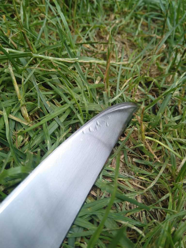

There are also some flaws in the blade's surface, probably traces from straightening after heat treat. Nothing too bothersome and nothing that seems to significantly impact the functionality or durability of the piece, plus it feels a bit like a unique fingerprint to me and can also fall under "imperfections we see in originals".
Aside from those spots, the polish and grind are pretty even and good-looking. The reinforced point is a nice touch as well, although it is a bit lopsided.

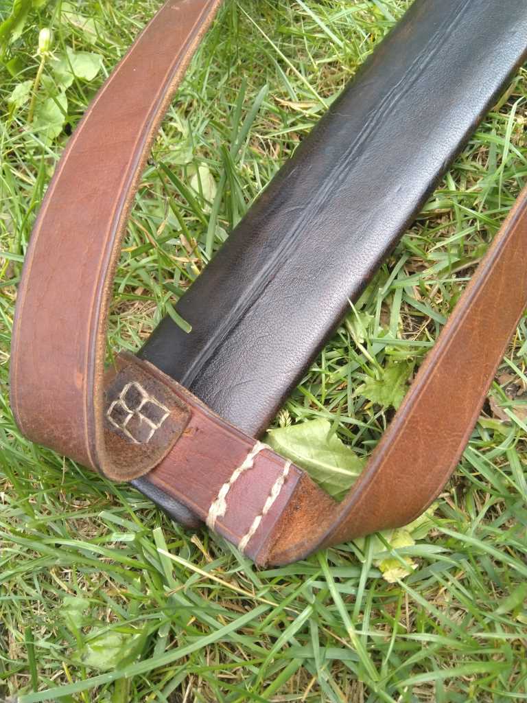

The scabbard is a similar story. It's a wood core with a rectangular slot for the blade. It fits all three versions of Gottfried (sharp, thin blunt, thick blunt). The sharp (and probably the thin blunt as well) are not "held in", while the thick blunt has the exact right amount of friction: it's held in when you turn it upside down, but comes out easily when pulling on it. This will obviously vary with humidity. I don't mind, as it should hang vertically down for the most part anyway.
The leather covering is of decent quality. Some of the paint has rubbed off a little, and there are some creases in the thin leather, but nothing I would complain about in any way. It appears to be glued only on the back, and while the seam is not straight or perfectly centered, I think it's perfectly adequate and, again, looks just right.

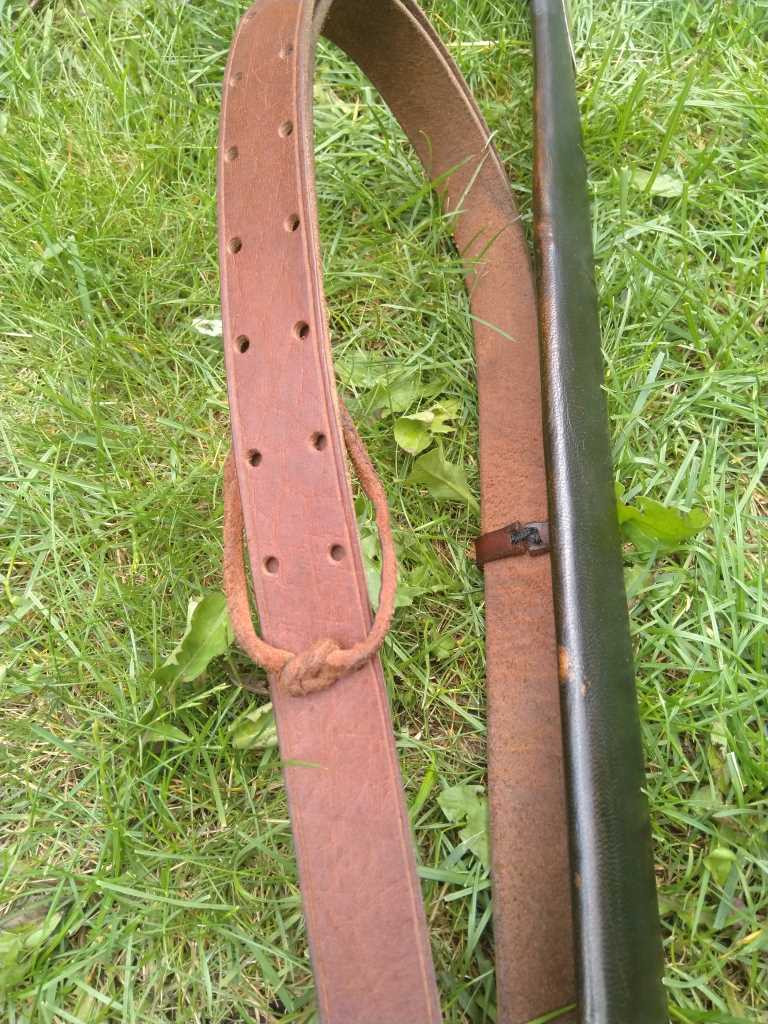

The baldric is of very nice quality. The leather is thick and strong, edges are chamfered. The stitching is solid, but not especially even, giving it has that nice "craftsman's charm".
It was originally attached by way of a wooden wedge pushed between the baldric's scabbard loop and the back of the scabbard. That loosened up a little more than I'd like as the leather relaxed, so I added another thin washer of leather to the wedge and glued the whole thing in place with a small spot of leathercraft cement.

The reinforced point, slightly lopsided. [ Download ]
Attachment: 85.81 KB
Small divets, probably from heat treatment and straightening. [ Download ]

Scabbard detail [ Download ]

Scabbard knots. I added the slider myself. [ Download ]

Overall view [ Download ]

Cross and Nagel Peen with flaws and toolmarks. [ Download ]
