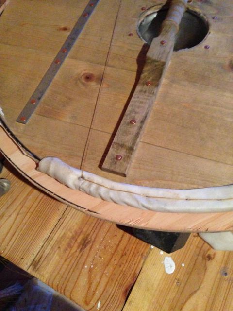

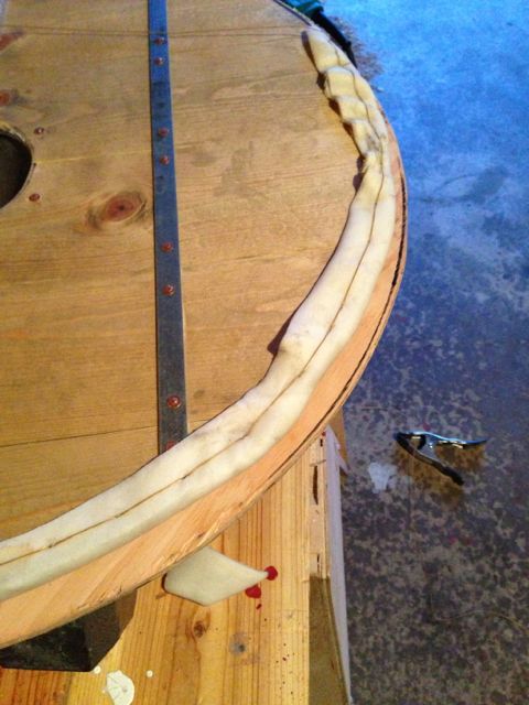

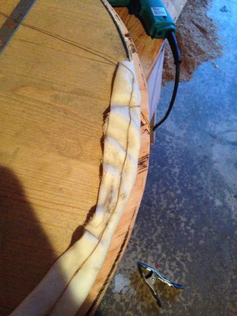

So I'm having a hell of a time applying this rawhide to my latest shield... I couldn't cut it straight, It's being uncooperative when trying to drill holes and stitch, and I'm generally just hating every minute of it. Strips of 3" leather was so much easier. Here are some pics, I doubt you'll be able to tell what I'm doing wrong, but at least you can see how awful it looks! lol. Any more tips would be appreciated; I'm using an 8 hour soaked dog bone as the rawhide. No success. laugh away. I just can't seem to get it tight enough or even at all. This is one of the most frustrating things I've ever done, and I've been in the military!
 Attachment: 54.79 KB
 Attachment: 58.06 KB
 Attachment: 56.02 KB
