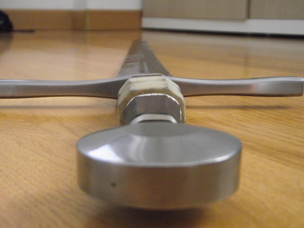

Hi everyone!
Waiting for my first Del Tin, I came across this Windlass "War Sword", definitively much cheaper than a Del Tin, but I think it's not bad at all! In effect... I like it very much! Happy
Here are some specs:
Blade: 36”
Overall: 44 ½”
Blade Width: 2”
Weight: 3 lbs
PoB: 5 ½”
The grip is bare wood (I actually don't know which type of wood), with a piece of gut stitched over the shaped central section. The metal wires are only decorative elements! The pommel is screwed.
I tried it with and without gauntlets: while without gaunts the gripping is quite confortable, with gauntlets I found it terrible, maybe for the central rising that doesn't allow a good hold (below are some photos of the grip).
So, I want to regrip it, but I'm not an expert at all, this would be my first attempt, so I would be grateful to everyone could help me!
I think to remove the gut, make plane the central section, maybe to machine the entire wood core to make it thinner, wrap around it a hemp twine with some glue only at the top and bottom of the grip and finally apply some type of leather (I don't know which type is better for such a work)...
 Attachment: 162.86 KB
 Attachment: 186.75 KB
 Attachment: 199.61 KB
 Attachment: 206.22 KB

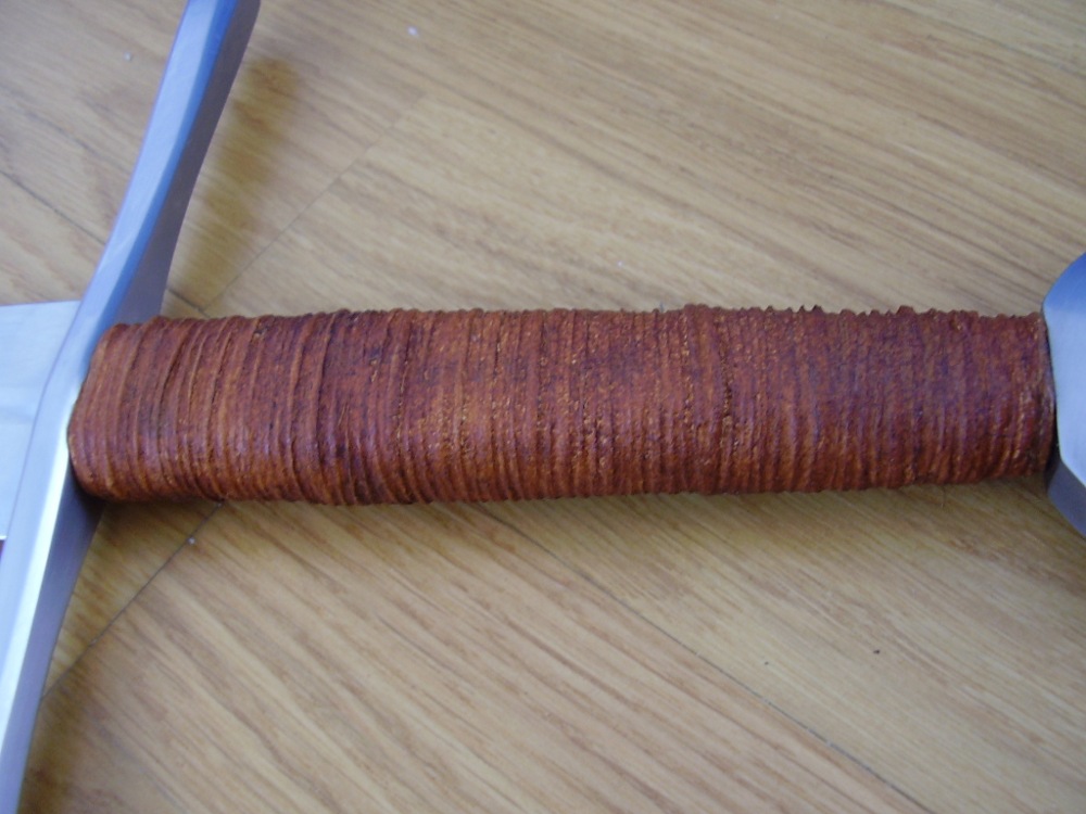

PostPosted: Tue 01 May, 2012 4:24 am    Post subject:         Reply with quote
Hi!!!
Today I've finished my regripping! Much better than I had expected!
I really thank you all, especially Sean and Joel, for your precious tutorials & articles & advices!
Some realization details:
I removed about a 30% of the wood core with a simple pocketknife to make it thinner, then I wrapped around it hemp twine (diameter ca. 1mm), filling the grooves remained after the "slimming" with more thick twine. I used polyacetovinylic glue for wood.
I put over the wrapped core chamois leather previously skived and soaked, glueing and overwrappig it gradually. For the overwrap I used the same hemp twine of the inner layer.
Once dry, I applyed brown shoe polish (I cannot find the correct natural dye!) and wax!
Thank you again, may the force be with you all! Wink
 Attachment: 155.06 KB
The inner wrap
 Attachment: 174.11 KB
 Attachment: 158.94 KB
 Attachment: 57.33 KB
An overview! [ Download ]
Ciao a tutti!

PostPosted: Tue 01 May, 2012 2:29 pm    Post subject:         Reply with quote
Congratulations! That came out very nicely, you should be very proud!
- Luke 22:36
Antonio Ganarini
Location: Trentino, Italia
Joined: 20 Mar 2012
Reading list: 10 books
Posts: 76
PostPosted: Wed 02 May, 2012 5:53 am    Post subject:         Reply with quote
Thank you Joel! I'm actually very glad of this little work! Primarly because it was very funny trying to glue everything together, clung to an home-made vise, with glue almost everywhere! But I had good masters! Laughing Out Loud
Ciao a tutti!
PostPosted: Wed 02 May, 2012 6:32 am    Post subject:         Reply with quote
It's a clear improvement! I've seen this sword many times and never taken a second look at it because of that awful grip, but you've proven that it has real potential as a project sword. Cool

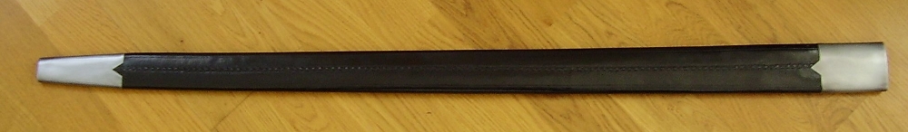

PostPosted: Tue 20 Nov, 2012 1:02 am    Post subject:         Reply with quote
Hi everyone! Happy
Now's scabbard time! I would like to turn the classical windlass scabbard of the sword above into a more historical one (without magical spells, of course)!
The target is 1340-1360, tools, knowledge and craftsmanship are limited, so I really need your help!
I looked for sources in Oakeshott's books, and I found that the problem could be solved with a two ring hanger, one high just under the mouth of the scabbard on one side of the upper locket, another on the other side, near the lower brim of the same locket. The only concern with this solution is that the weight of the sword could be too much for this hanging system to keep it at the right angle, given the short distance between the two suspension rings.
I know this type of sword was often carried at the saddle but... I would like to make something similar to the picture from
The Sword in the Age of Chivarly below, but with a nearly correct suspension system for ~1350.
Then I could try to remove the black painting of the leather with a metal brush or sandpaper, protecting it with something else (simple grease?).
Any idea?
 Attachment: 42.33 KB
From Oakeshott's "The Sword in the Age of Chivarly", type XIIIa
 Attachment: 99.1 KB
 Attachment: 68.92 KB
Ciao a tutti!

PostPosted: Wed 21 Nov, 2012 7:45 am    Post subject:         Reply with quote
I think that something like this could be ok... I don't know how much, from a historical point of view, and here's where I need you! Confused
Ok, I know that a windlass scabbard maybe cannot be historical, but I wish to make it resemble an historical one! Wink
 Attachment: 51.21 KB
Ciao a tutti!
