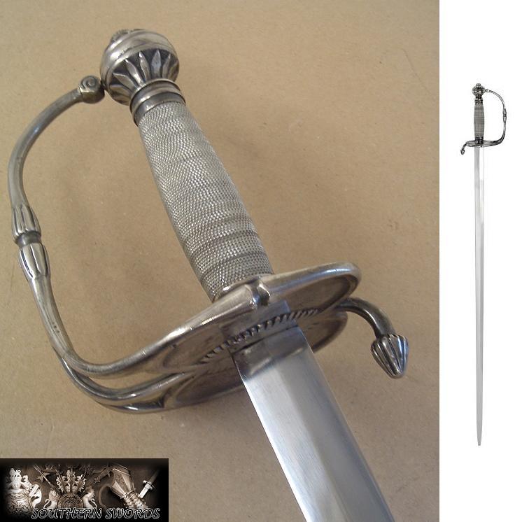

If you like this style of sword, can I just mention that the Scottish swordmaker John Barnett makes a very close (and very inexpensive) replica (with a solid brass hilt, plated with an antique 'silver' finish). We use these (with fencing blades) in the salle. They are solidly constructed, although the original sharp blades are usually poorly heat-treated, but are easy to swap out.
Below is one place that sells them (there are others). I have no affiliation with JB, just thought I would give you guys the 'heads up' as original antique versions of this attractive sword are not that common.....
Julian
 Attachment: 71.62 KB

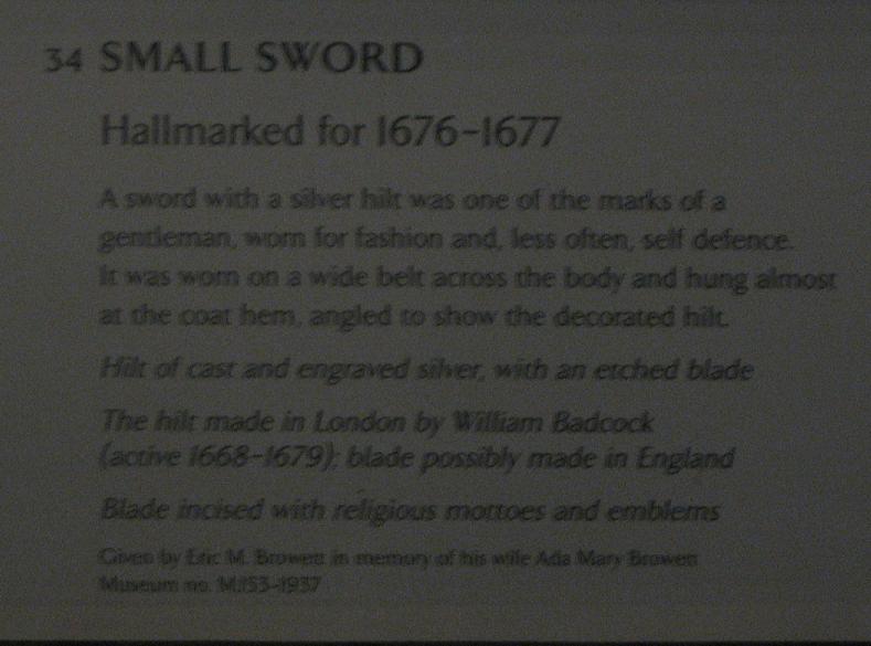

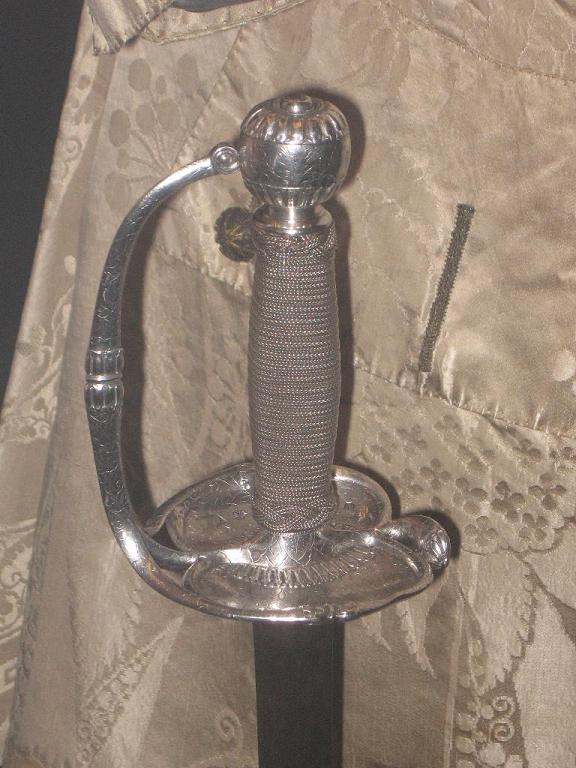

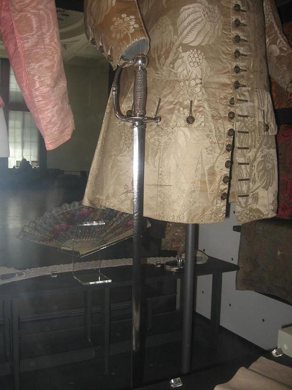

I believe the sword from John Barnett is meant to replicate this sword from the V&A:
 Attachment: 46.15 KB
 Attachment: 68.01 KB
 Attachment: 79.46 KB
Regarding the type of blade that goes with this hilt, I have seen three main types. I've seen a broadsword pattern, similar to yours. I have one that has a backsword style blade and I have seen others with curved, saber style blades. Although, a few of those swords may have been composites.
Thanks Jonathan, for the pics of the JB original.
Adam - I too like this style of hilt, sort of like a cross between a smallsword and a spadroon. At the risk of sending this topic into another direction, my sworsmanship salle is in the NE of England, but one of the premier WMA/HEMA salles in the country is in London (Ealing, to be precise) - Schola Gladiatoria:
http://www.fioredeiliberi.org/
Julian
