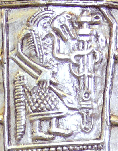

So, you have a preference for vertical carry? I myself have often found horizontal carry to be awkward, so I can easily understand why you might want a vertical carry set-up. Here are a few pics you might find interesting. The pressblech is from Gutenstein, and is from a century or two before the longseax became prevalent. The only pictoral evidence we have AFAIK for langseax suspension is the Stuttgart Psalter, which seems to show belt suspension at a moderate angle.
Langobardian seax often have wood-cored scabbards, as do some of the seax from Vendel period Scandinavia. I remember that at least one broadsax was found with the remains of a wood-cored scabbard, I believe it was found in the Netherlands. I am not sure off the top of my head if any longseax have been found with wooden scabbard remains. Hope this helps.
